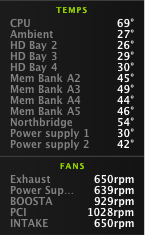

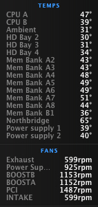

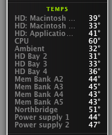

Here is mine. Only the north bridge running a little warmer here...
Left pic, after 4 hours raiding in WoW
Right pic, 5 minutes after quitting WoW... back to normal

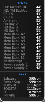

You might be right about iTunes. Here is today I've been editing some videos and a lot heavier work for over 3 hours now. iTunes is not open since I have a baseball game on the TV.
Found out that normal temp for a 2009 Mac Pro is 35C - 85C

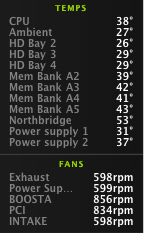

Here's my machine (2.6ghz Quad '09)...it's been on for days and currently all I am doing is surfing and listening to iTunes.
u have a rather high ambient temp too.
i recorded my highest of 33ºC and it was constant for a few days before it dropped back to 32
Mmm...my office is 23-26C ambient room most of the time, so I don't expect the computer to get much lower.
If the computer is recording an ambient temp of more than about 1c above room temperature it almost always means that the exhaust fans are not doing their job. Either dust is clogging the system or the RPM is set too low. It's the meaning of the ambient sensor and the purpose of the exhaust fans.
