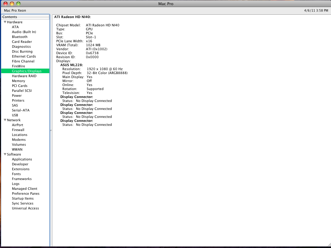

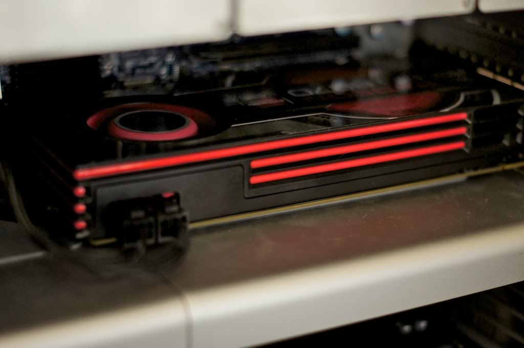

hey guys i am excited to hear that this works. could any of you post pictures of the install and post your system profiler? i would love to see how things fit.
Here ya go:
attachment.php
attachment.php
