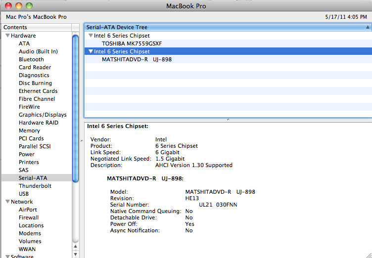

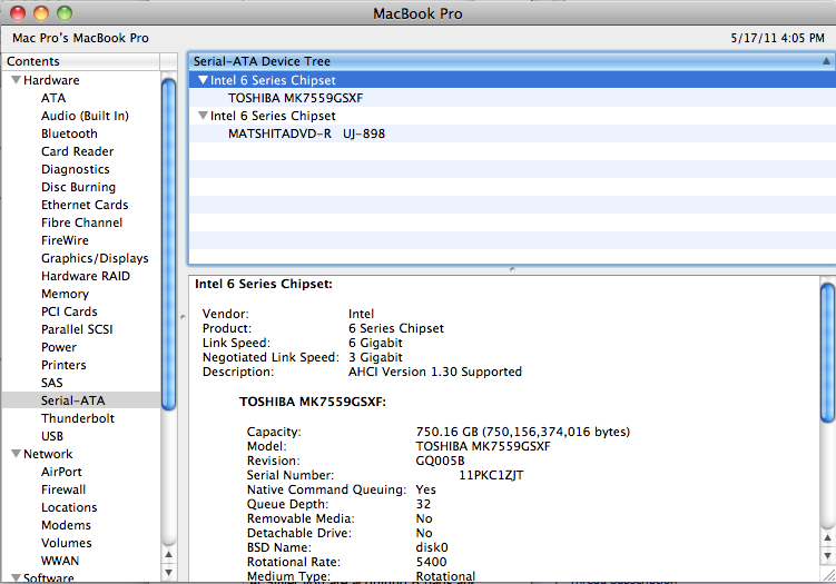

I purchased a new 17" from the Apple store as a stock model roughly a week and a half ago. This was the base 2.2 model. Both my ports appear to be 6/6. I have posted my serial specs for those interested.
Group1: MacBook
Group2: Pro
Generation: 83
ModelCode:
Machine Model: MacBookPro8,3
Model introduced: 2011
Production year: 2011
Production week: 18 (May)
CPU speed: 2.2GHz
Family name: Become a pro user to see this information. (sorry)
Screen size: 17 inch
Colour: Please tell us what colour this MacBook is.
Factory: C0 (Quanta Computer (Susidiary = Tech Com))
