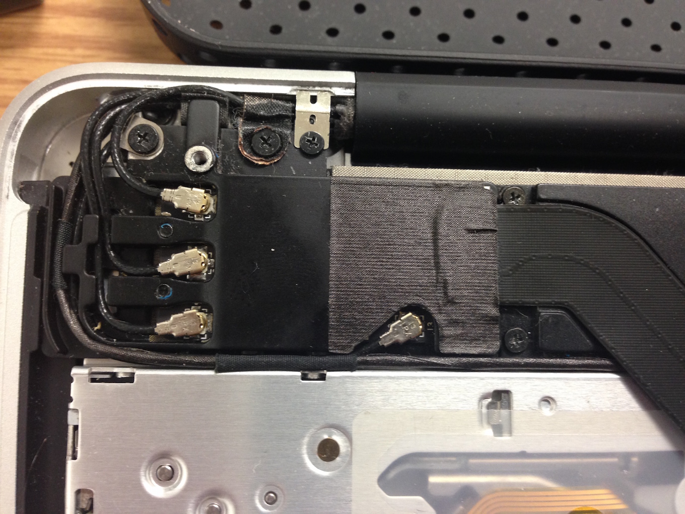

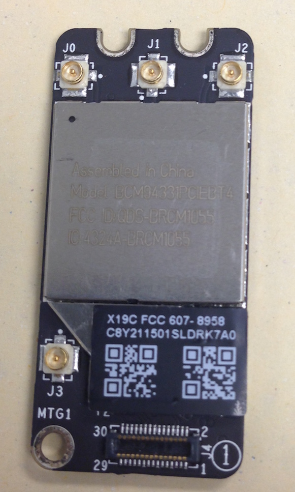

Hi, I just verified my installation and everything looks good to me. I am attaching some pictures as well. Let me know what am I missing here.
I still get same message when I try to run activation tool as bluetooth hardware not detected.
Please Help!!!!!
Thanks.

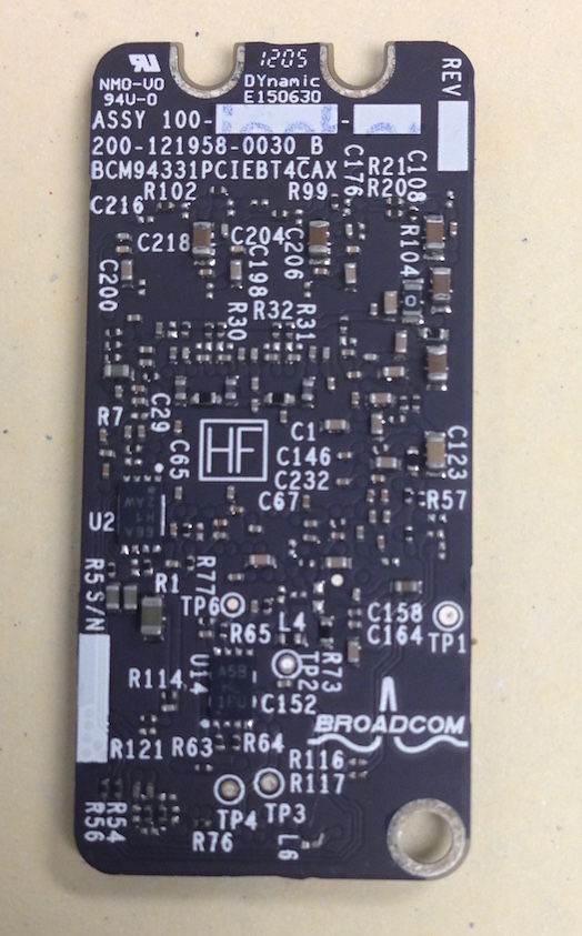

The card i bought not from os-store, but written as BCM94331PCIEBT4CAX on the back. The front should be 607-8958
Any idea?
Please Help!!!!!
Thanks.

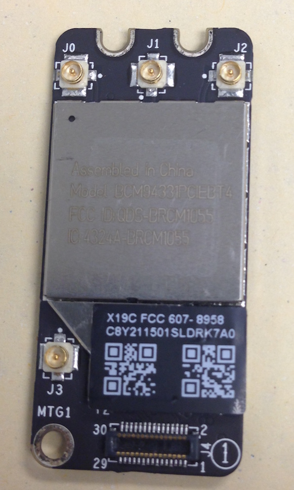

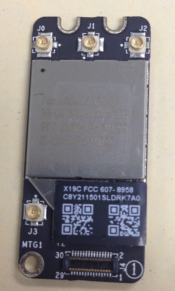

Do you have a pictures of it. This is what I bought it did not work me at all and someone told me that I bought wrong card.

It sure looks like it should work! The number is the same on that card as it was on mine. Looks like it should work. I'd go through the entire process at post 509 on this thread. I followed it to a T and I've been working just fine.
