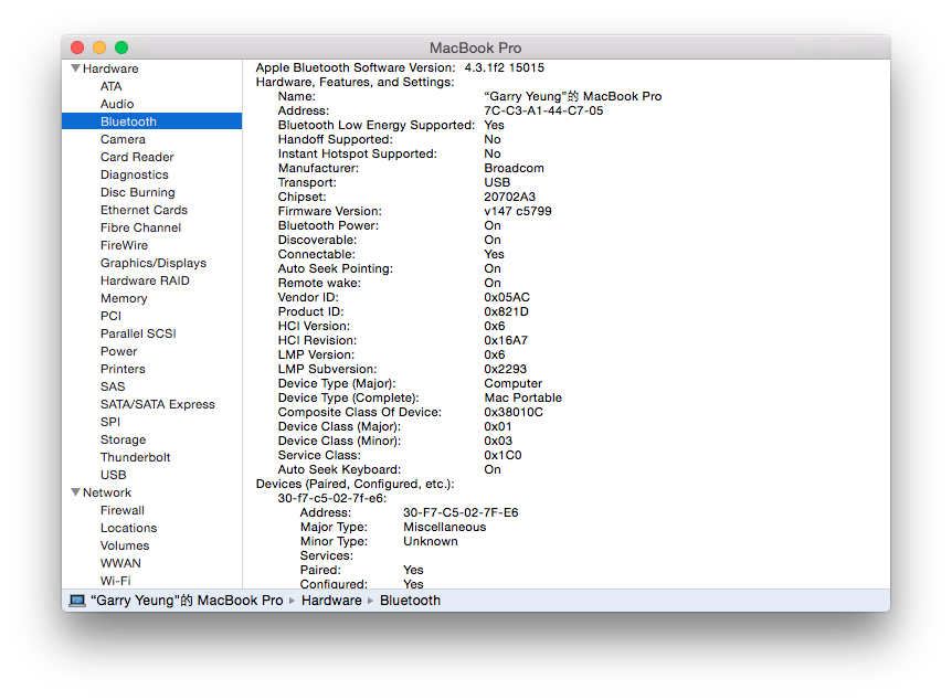

After I replaced the hardware but didn't do any of the scripts, the bluetooth says "ON" but not able to connect to any devices such as mouse and keyboard. I checked the System Information and everything seemed normal (screenshot attached), the WiFi is running as usual.
I still follow the tutorial then, but to step 7, i got this:
Can't open CFBundle for /System/Library/Extensions/prl_hid_hook.kext.
Can't open CFBundle for /System/Library/Extensions/prl_hypervisor.kext.
Can't open CFBundle for /System/Library/Extensions/prl_netbridge.kext.
IOBluetoothHIDDriver.kext - no dependency found for com.apple.iokit.IOBluetoothFamily.
Prelink failed for com.apple.driver.AppleBluetoothMultitouch; omitting from prelinked kernel.
I repeat step 7 before doing the disk permission repair, but still don't work.
what should i do??? thanks!
MacBook Pro 15" early 2011
