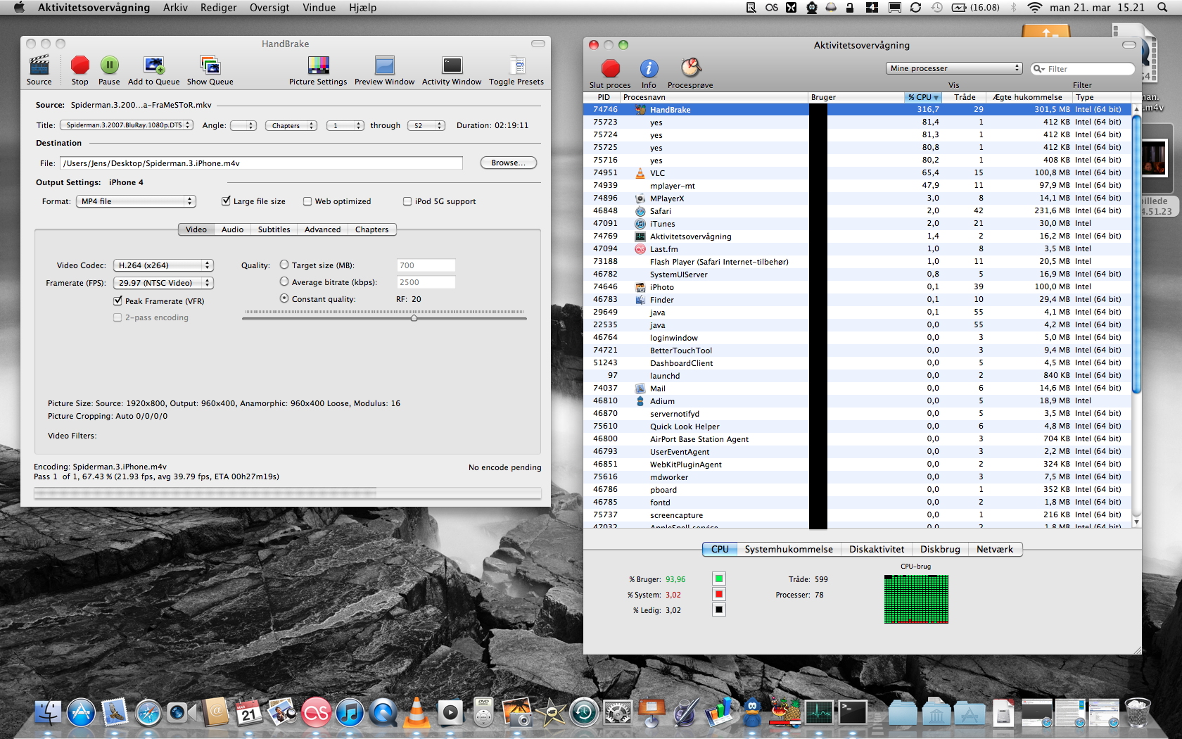

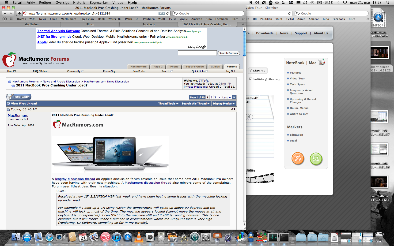

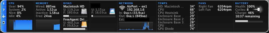

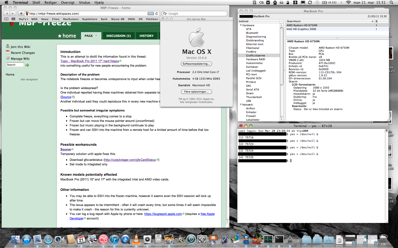

Being a new MacBook Pro (2011 15" 2.2 GHz) owner, I was worried when I saw reports of this problem. But after fairly extensive testing, I can say that my computer has no problems performing intensive tasks.
For the past hour (approximately) the following has been running on my computer (along with a number of small applications which are always running):
- Handbrake encode: 1080p MKV to iPhone 4 preset (m4v)
- HD video playback: one 1080p MKV in full screen (VLC), one 720p MKV on top of it (MPlayerX)
- yes > /dev/null &: Executed four times as recommended in http://mbp-freeze.wikispaces.com/
- iPhoto: browsing, rotating and so on went fine
- Safari:6 windows
All this went perfectly fine, video playback was smooth, Handbrake encoded without problems, I was able to switch between spaces with smooth animations, and so on.
I have attached screenshots of my four spaces with this running, as well as one of iStat Pro.
If anyone would like to see tests of something else, let me know! So far it has done everything I have thrown at it. 🙂
EDIT: I threw a 1080p YouTube video on top of it all, and it still runs great with everything. It could not, however, handle a 4K res YouTube video as well - but I suppose that's understandable.

I think to get freezes the point is not to have many applications open, as if you increase your work load gradually the fan will be already working. The point is to increase the workload suddenly: first shutdown the computer, let it cool to a reasonably low temperature, then turn on, open nothing but photo booth and the terminal, and suddenly do a lot of "yes > /dev/null &". This works for me every time. If I try to nurse the fan up to speed the freeze is only intermittent.
- Safari:6 windows
