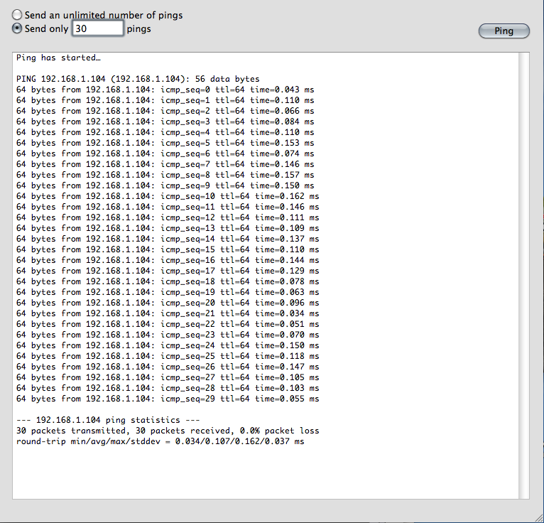

Can someone tell me if this is good or bad?
Link speed: 144Mbit/s --> is that slow or good? what should i bet getting on a wireless N router?
and what about these pings? are these normal/slow/good/bad?

That is just not true, I have tried my computer om five different networks with similar performance issues on all networks.
144Mbits/s is pretty much the maximum theoretical data rate one can achieve with 802.11n operating under two separate 20MHz channels or a single 20MHz channel in a 2x2 MIMO (antennae) configuration.
I think the 2011 MBPs are using a new Broadcom card that does 3x3.
I just replicated my erratic pings on a completely different network, using an old AEBS (A1034).
Same song. Pings are all over the map, from 1ms to hundreds of ms. All I have to to is start a download and they drop to sub 1ms consistently until the download has completed.

The problem is completely benign for my application, other than checking to see if it exists.. since others are bothered. I do nothing with this device that would ever uncover this problem.
My troubleshooting thus far is to run ping 3-4 times. It's not worth reading your entire post over, let along swap routers.
Unless someone is seeing erratic ping times for games or VoIP, I can't imagine ever noticing this issue.

I was just google search this issue and found this thread.
I just purchased a new MBP 15", and the connection is HORRIBLE compare to my old Acer laptop.
The ping issue seriously annoyed me, it also affect the download rate while 2 of my laptop works completely fine.
I was about to walk to Apple store for this issue, but I guess there is nothing they can do for now.
