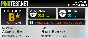

Negative. Use PingTest.net, not the built in pinging utility.
Here is my result with my Thunderbolt set as a hotspot and my MacBook Pro 2011 connected:
Here is the same test - same server - with my Airport Extreme bought late 2010/early 2011, same MacBook Pro:
As I stated earlier, significantly more jitter (which is what you guys are really seeing) than the Airport. Though I don't see it nearly as erratic as you guys do. I suspect you're also having some other interference going on.
TO the one with the AEBS: How do you have it configured and how is your Mac talking to it?
In my case I have an isolated 5GHz SSID, and only the computers connect to it. So my Pro, Air, and iMac all are connecting 5GHz Wireless N, the Extreme is not doing anything but 802.11n and it's running in isolated mode with increased output.
Every other wireless device connects to the Time Capsule, which is running in isolated 2.4GHz and bridged over to the Extreme. That way there is no possibility of interference between the devices.

Both of you run PingTest.net and post results - local and remote, instead of the built in ping app. If it returns more stable than the built-in app it could point to a software/firmware issue rather than an actual defect. If it's just as erratic, then it points to a defect with your MBP - but not a global issue as it can't be replicated by others.

But using PingTest.net, it looks good:

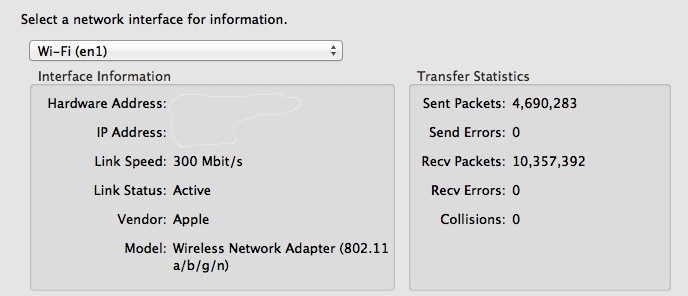

However, I also transfer a lot of files and I've never had any issues.
And I'm connect to my wireless via 5GHz.

I just ran the test at www.pingtest.net and got the following:
With nothing happening except the ping test:
Ping: 352ms
Jitter: 162ms
Running ping test while downloading Ubuntu at the same time:
Ping: 125ms
Jitter: 16ms
This is 5GHz about 10 feet from the AEBS
Here's what I got from Pingtest.net
Ping: 65 ms
Jitter:3ms
Which I guess doesn't seem to bad compared to some others that have posted?
But like I said, I haven't really had speed issues, just random connection drops.
