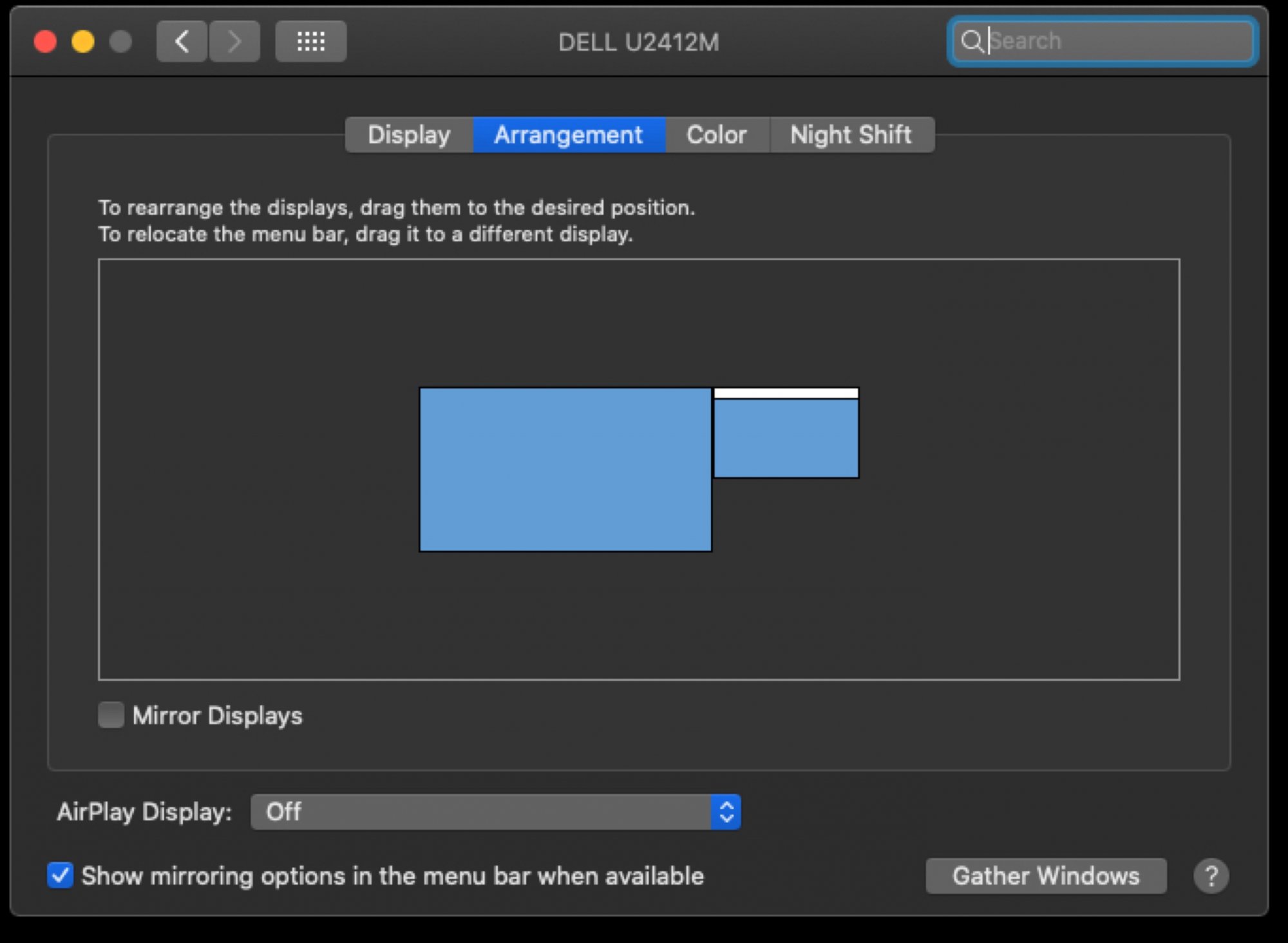

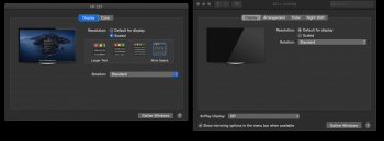

Apologies if this is the wrong place to offer both thanks and a solution. I just joined the forum because of this thread's many ways of coping with the display port-blank screen issue on the late-2012 mac mini. I keyed in also on those posts referring to using two monitors, which is my situation.
What helped me a lot was the post about putting the mac to sleep (I do that from the apple menu because my keyboard doesn't have a sleep button). So far, that works every time. When it comes to, as many have pointed out, shutting down the computer and then booting (immediately or later), the higher-res (aka second or first) monitor often stays black screen. I, too, don't want to be pulling cabled and power plugs or hitting the power button several times. Bus maybe this is a solution:
Some posts mentioned time lags on waking up or rebooting. That sent me on a path to make the problematic screen boot up or wake up sooner. The mac os helped do that (I'm on Catalina). The trick for me was to put the menu bar on top of the monitor that always works with its hdmi-dvi connection, so that the system settings/display "arrangement" setup looks like the screen shots.
I'm also using the SwitchResX utility to get the highest resolution possible in higher res monitor.
Grains of salt: this has worked for two days so far, with several times sleeping the computer and booting it up just as I used to before connecting a display-port capable monitor. FWIW, and many thanks again to all contributors.
