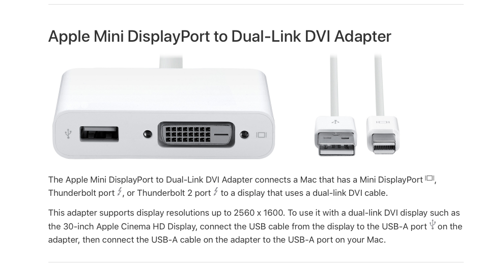

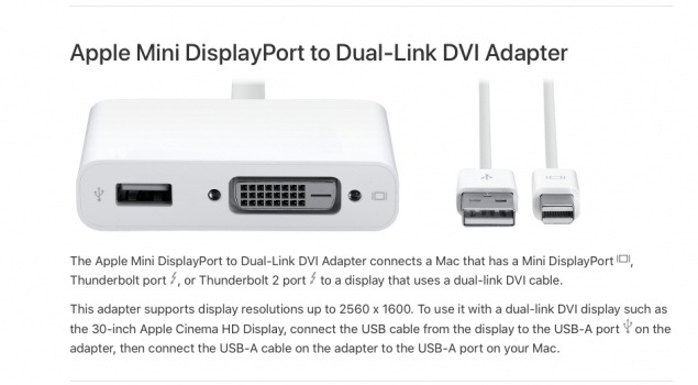

Hallo.
I had the same problem when i purchased my MAC MINI 2012 i7
My solution to maintain resolution 2560x1440 with my Dell U2713HM and have wake up after sleep to funktion is as follow.
I cloud not use Mini display to Display cable due to wakeup problems. I had to purchase Apple Mini DisplayPort to Dual-Link DVI Adapter.
After this install system worked. And had also replace Dell original DVI cable and purchase better quality DVI-cable in order to get things working like they should.
Rgds E.Asker
Reactions: Neodym
