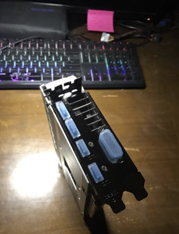

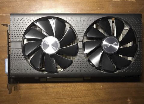

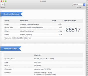

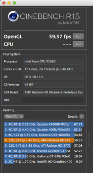

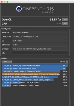

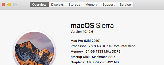

Ok, I just installed my Sapphire Pulse RX580 - but I do not get the boot screen, except for just a second or 2 right at the end, and it shows up as an R9 XXX. Is there more than one iteration of the Sapphire Pulse RX580? Mine has 2 HDMI, 2 DP and 1 DVI. Pics attached.

You will not get the boot screen with an RX580, and the R9..... description is normal in Sierra.
I believe in High Sierra it lists correctly, as its the card in Apple's eGpu.
This is the same card I have in my mac.
Reactions: foliovision
Ok, I incorrectly assumed that working OOTB meant that the card would have the boot screen. So that is my bad.
OOTB meaning no setup, no drivers required..... unfortunately no boot screen 🙂

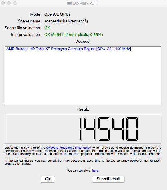

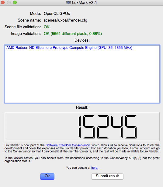

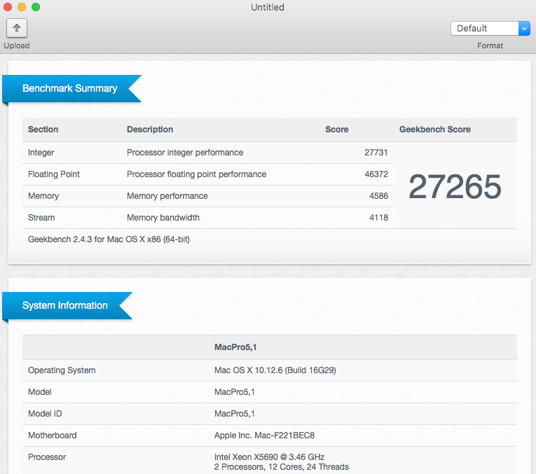

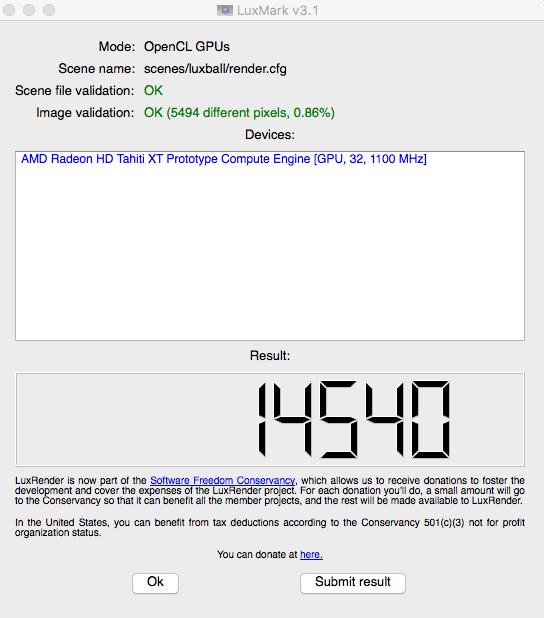

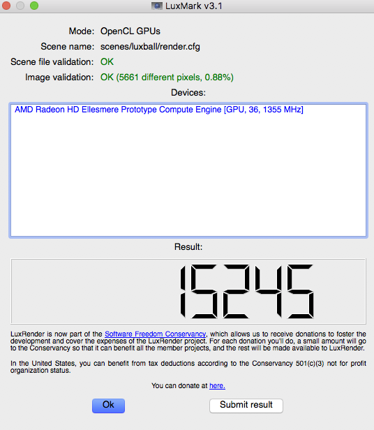

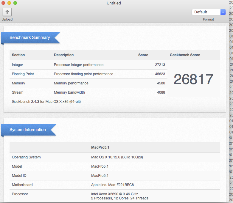

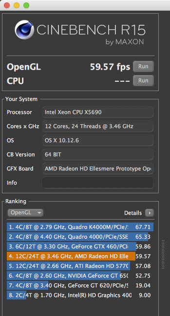

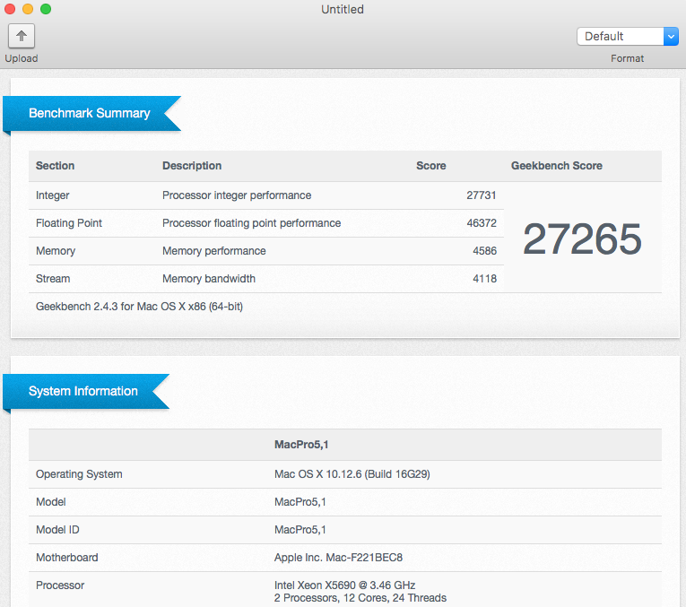

Here are my scores.
With the R9 280x
Geekbench: 27265
Cinebench 58.25 fps
Luxmark 14540
BruceX: 42 seconds
with the RX580
Geekbench: 26817
Cinebench 59.57 fps
Luxmark 15245
BruceX: 38 Seconds
[doublepost=1509652495][/doublepost]Unless if someone can make sense of this for me and tell me something I don't know - I'm not sure the RX580 is all that much better than the R9280x.

CineBench and Geekbench is benchmarking the CPU, not GPU. If you want to see why upgrade to RX580, try some real OpenGL benchmark (e.g. Unigine Valley, or Unigine Heaven, etc).
Anyway, Luxmark 3 should be a good OpenCL benchmark.
Yep, as someone else has pointed out, you would need High Sierra to have the correct name shown.
Indeed the drivers in High Sierra will likely be more up to date and probably perform better than the RX580 driver in Sierra.

The RX 580 should be running 19-20 seconds on bruceX. 38 seconds seems a bit high.
