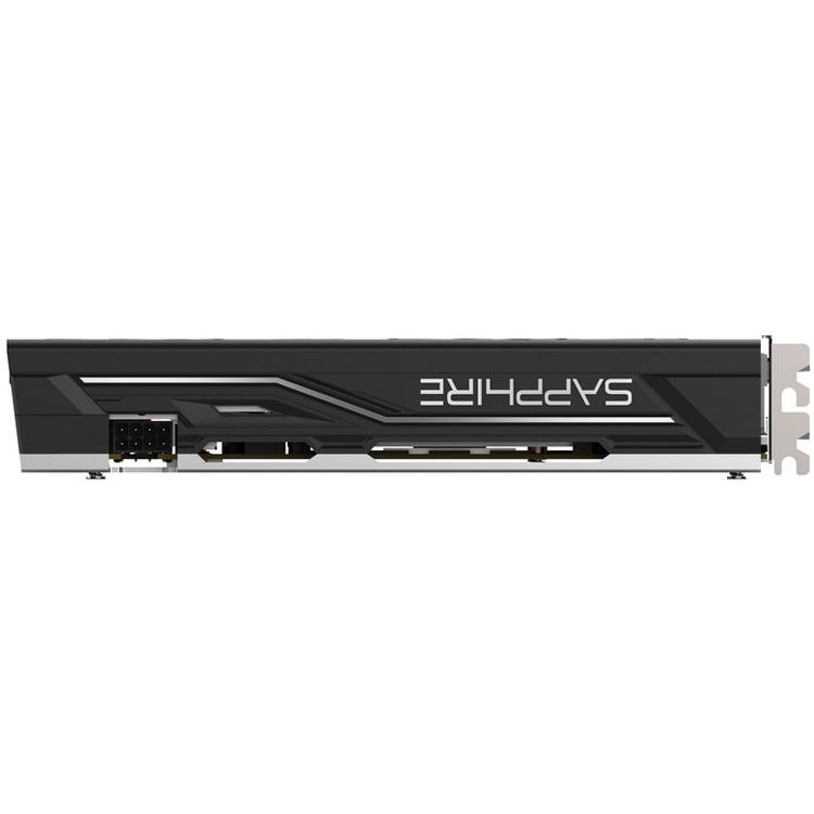

I just bough one of the cards and it only has one 8 pin power socket that I can see.
How come a dual cable is necessary? Or am I am missing something?

The card's single 8-pin power socket requires more power than one of the Mac Pro's 6-pin sockets can put out. You need the Y-cable so that both 6-pin outputs can supply power to the card.
Oh I see! Duh! The two 6 pins go into the mother board and the 8 pin into the card, right? And they're all female?
I was confused because I have been looking at other cards which have 2 sockets on the card in a combination of 6 and 8 pin sockets so I got a little confused there. Thanks for making it clear.
