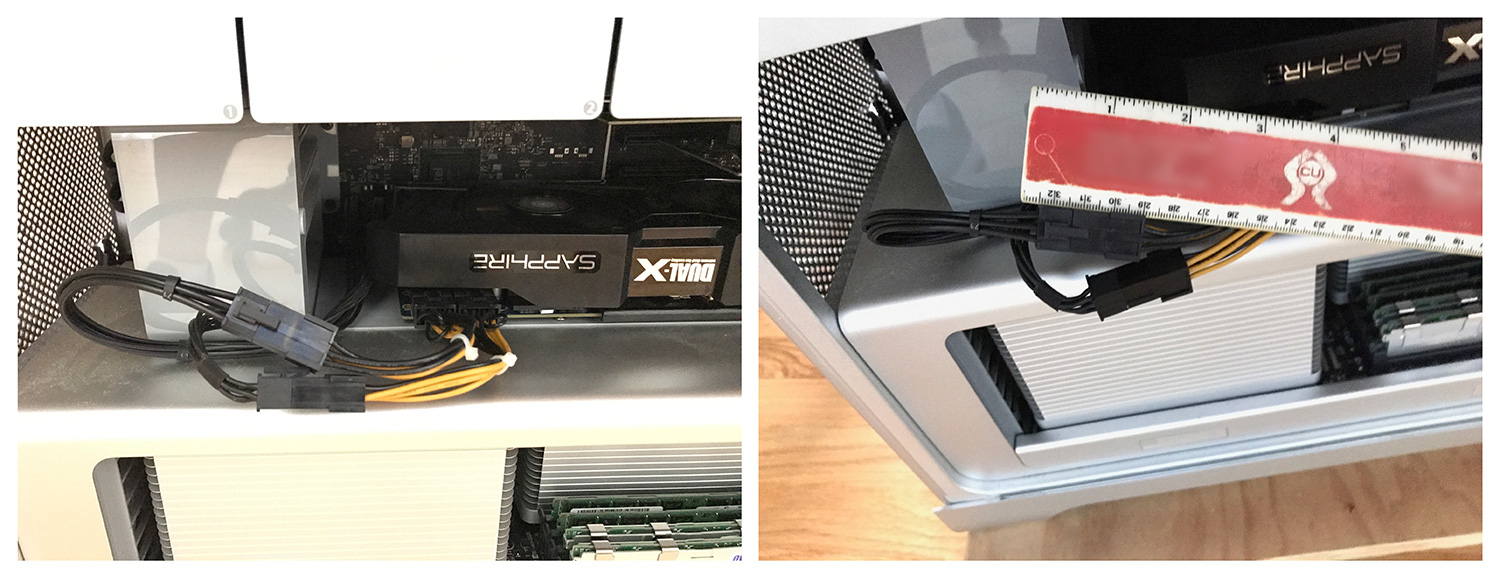

MINI vs FULL SIZE 6-pin power connectors?
I'm also looking to do this install. I ordered the RX 580 Pulse (in stock at Amazon for $299), now I'm looking to order the right power cable. I've seen all the comments above about the **mini** 6-pin cables being the correct ones rather than the full-size 6-pin connector. That said, when I open up my MP 5,1 case (picture below), I'm pretty darn sure the GPU power cables are full-size 6-pin, not the mini ones.
(The GPU in the pictures is my current Radeon 7950, with 6-pin to 8-pin adapters on both of the two power cables.)
Am I crazy?
The 7950 has two power connectors on it. The RX580 only has one 8-pin connector. You need both of the mini-6 pin connectors on the mainboard to provide sufficient power to the card. As such, what you need is a single cable with dual mini-6-pin male connectors on one end and one full-size 8-pin male connector on the other. Your existing cable setup will not work.

I can't quite remember if my PULSE RX580 come with a dual normal 6pin female to single 8pin. If yes, then you can use that with your current cables.
But if no, then you will need a new cable anyway. You can buy normal dual 6pin FEMALE to single 8pin (because you already has two mini 6pin to normal 6pin), or dual mini 6pin to single 8pin. It's your choice, but you will need at least one of them to power the card properly.
For info, You CANNOT just connect the 8pin to a single mini 6pin source with your current cable. That will 100% trigger the shutdown protection when the RX580 is under stress.
Many thanks to all for the replies.
If I understand correctly, the male PCIe power sockets *on the motherboard* are 6-pin mini male (it didn't occur to me to look at the motherboard itself! ), so if I was going directly from the motherboard to the RX 580 Pulse then I'd need a dual-mini 6-pin to full-size 8-pin cable.
However, since I (apparently) already have existing mini 6-pin to full-size 6-pin cables on both sockets, I can just use them and attach a dual full-size 6-pin female to 8-pin male cable (which is easily available on Amazon)... I'll have some extra length if cable in my case, but as long as I can figure out where to stuff it, that should work fine to power the RX 580, right?
Thank you!
Thank you!
Yup, exactly right.
