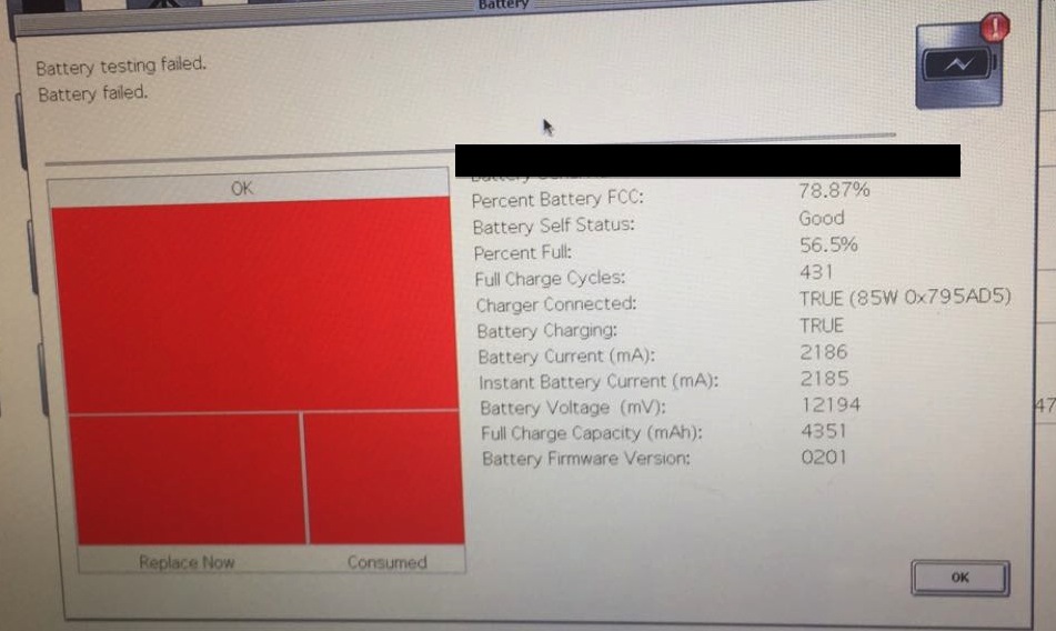

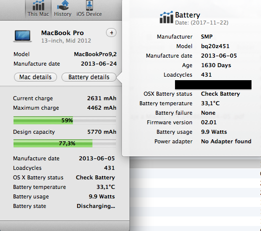

I've had the mid-2012 Macbook Pro 13'' (2.9 i7 processor, 8 GB RAM and 750 HDD) for four years now. Recently i started getting the Service Battery warning, so i ran some diagnostics and it seems it needs to be changed.
Apple Diagnostics:
(sorry for the bad picture quality)

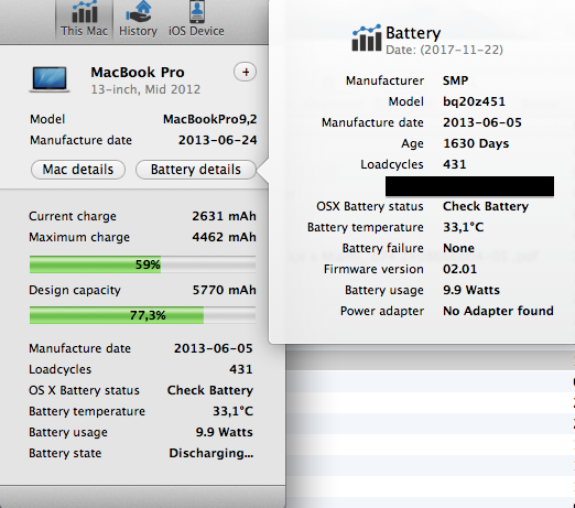

And Coconut:
Local Apple Authorised SP gave me a quote of €220 for a new one, but wasn't very clear on how long would it take. I'm a college student, so i can't afford to be without my laptop for long.

there are good quality 3rd party batteries that would be cheaper and they can be replaced by yourself fairly easy in a 2012 model.
If the machines works and does what you want/need they keep it and save for new one at later date if cost is a problem.
It is for me, I want a 2012 and gotta stick with my 2010 as all can afford.
If you are on a budget, IMO there is no reason to replace your current machine if it meets your needs as it is a solid design.
You can do the battery replacement yourself - it's pretty simple with the Unibody Pros and there are solid 3rd party options (some of which may be made by the same manufacturer of OEM.)
At the same time you do the battery replacement, you could also upgrade to a SSD for far better performance (at the same time, you may want to replace the SATA cable.) A fresh battery on this system + a SSD and you should be able to get quite a long period of usable life from it, for far less than replacement.
I agree with Zap - just replace the battery. You have a good machine - unless you really want to spend more and get a new one, get the battery.
Non-retina? Just replace the battery, it's really easy.
Then, take the money you were going to spend on a new MacBook and buy 16GB RAM and an SSD to put into it.
Oh, and put electrical tape on the inside of the MacBook top case while you're in there - between the SATA cable and the bare metal it runs across. Those things are notorious for failing.
OP:
If you have a non-retina, Yanni has the answer in the post above this one.
Order a NEW battery, get the right tools, and replace it yourself.
Go to ifixit.com to see the repair guide for changing the battery.
Doing the job is VERY easy. If you can hold a screwdriver, you can do it.
A -GOOD- new battery (there are cheapo ones out there, don't buy them) costs $70-100 (US).
One other VERY IMPORTANT tip:
If you do the replacement yourself, do not, do not, DO NOT use the metal tip of a screwdriver to "lift off" the battery connector the motherboard. I recall reading that one person tried this, and shorted out the motherboard!
Instead, use a plastic "spudger" -- or just the tips of your fingers.
If the rest of the 2012 MacBook Pro is in good shape, no reason to retire it yet. They are very sturdy laptops.
ONE OTHER THING:
As long as you're going to have the back off, why not put an SSD in there as well?
A 500gb SATA SSD isn't all that much, and will make it feel like "a new machine".
I wouldn't mind getting a new one tbh, but i really dislike the 2016-17 MBP models, they're just awful and i can't get past that keyboard! The 2015 15 inch. option is quite good, but i don't know if it's a good idea to get a computer that will be obsolete in two years, by Apple standards at least.
So i think i'm just going to replace the battery and perhaps get the new iMac, which for some reason is still way cheaper than most of the new MBP models.
How long can i expect my 2012 to last for? Is there any way to check for other components so i can be sure it's in good condition? I just don't want to be putting money onto it if it's gonna fail in 6 months time- with a new one i'll at least have warranty.
I had the check battery light in my 2012 13" MBP for two years before I replaced it. It had 1200 duty cycles on it. I just checked it periodically to make sure it wasn't swelling. I think if the battery still works and it isn't swelling, it will continue to work until you find a suitable replacement. I managed to find a replacement battery for under $20 on Amazon. It holds a charge well and lasts a while. Although I think I got lucky.
+1 on the previous advice to increase the RAM and install a SSD. It will feel like a new machine!

Somehow the battery warning disappeared, ran another diagnostics and everything was ok so i decided to keep the original one for now.
Did replace the SSD and i'm AMAZED! I actually got startled when system preferences opened a second after i clicked on it (usually it could take up to 15-30 seconds). Running High Sierra and so far so good, despite some bugs.
The service battery message will come back at some point. It's still good as long as it doesn't start to bulge.
