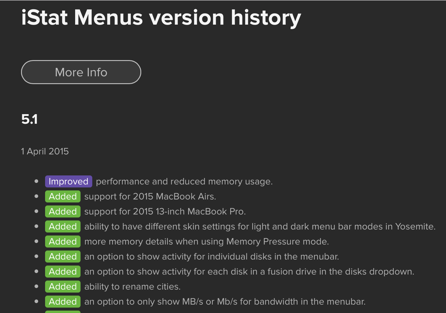

You realize that any "monitoring" type app likely needs to be updated for the 2015 rMBP with the broadwell chips. I know istat menus does and the dev said they are working on it so u also would not be surprised that an app like coconut battery does as well (I don't use this app).
Their website says it was updated for the new machines as of yesterday.
2015 13 rMBP fan activation
Good find. Though I've been clicking on the check for updates button in the app for the past week and there has been no update pushed out. Looking at the main download link in their site it still says version 5.03 but the release notes has 5.1 listed so I suspect they have updated the release notes but have not yet pushed out the latest version yet. If you look in the istat menu setup screen for temperature sensors you probably still have only 1 or 2 sensors available like ssd and right fan but no sensors for cpu and everything else. That means you still have the old version.

Actually, it does slowly ramp up. The reason why you think it suddenly ramps up is that it remains totally silent until around 4000 rpm or so. Then that's when the noise increases exponentially.
I use SMCfancontrol to monitor my fans.
Ahhh... good find on your part too Diesel!
Yes, I just bought the app today and it is 5.03. I just automatically assumed it was 5.1 that I downloaded. You're absolutely right. They haven't released 5.1 yet. How strange. I hope it wasn't an April Fools thing!
I just sent them an email asking them what was going on. I don't think it's an April fools joke as that would be very unprofessional on their part. Most likely a case of the update not being well coordinated (updating the site before actually making the update available).
My guess is that once we get the updated app it will show that the fans idle around 1000-1300 rpm like the previous rmbp and not at 0 as is currently being reported by the app.
