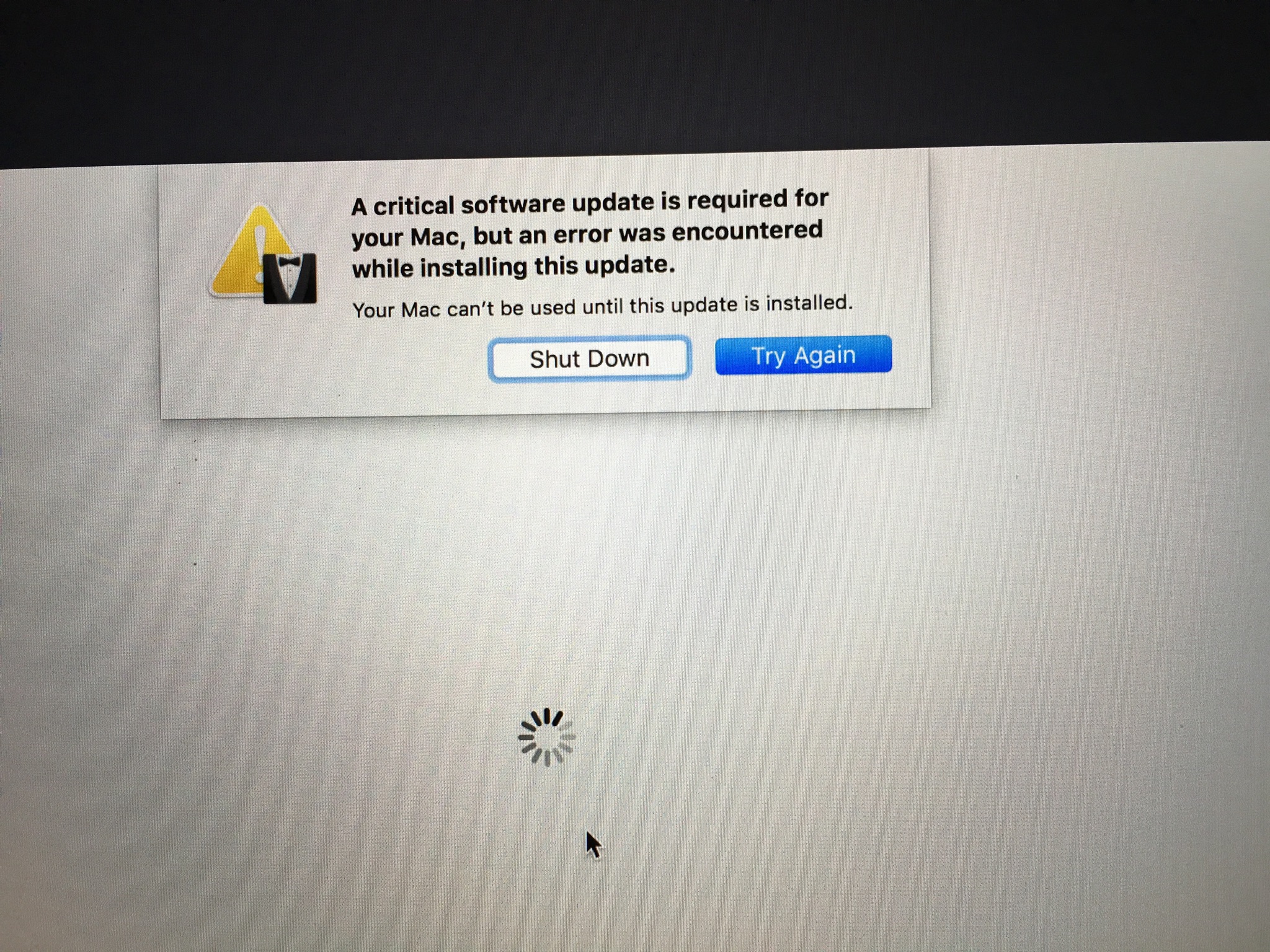

So, I just finished migrating to a 2016 15 MBP. After a restart, here's the wonderful result. This pic was taken on the 4th try...
How did you migrate? Did you move data/software from a older Mac/OS?
If old data/software was migrated then it could be a conflict with the new MBP or OS. If your error is from the initial startup of the new MBP, then contact Applecare.

Hey Gateway Mike,
I had the same issue as I mentioned above. I dont believe this is from your backup process. This error message was intermittent with my computer. I only got past the set up once then it came back. Im pretty sure your computer came with this issue. I have now returned mine and Im on the phone with Apple and they are giving me a tiny discount 200 dollars but they are going to put my build at the front of the line and ship it out ASAP.
None of my business but I would recommend you return that machine and get a new one.

Just had this same issue. My 2016 MacBook Pro 15" didn't even ask me if I wanted to update, it just happened on Restart. Called Apple Support talked with them for two hours. They were stumped with the term "critical" software update and they said Apple would never use a word like that for an update. They found a service bulletin that stated to click "Try Again" until it works. That's all that it said, one step...no reasons why. Well that never worked, obviously. They left me with two options: Boot into recovery mode and reinstall Sierra or Boot into recovery mode, erase my hard drive, and do a clean install of Sierra.
Tried the reinstall of Sierra and the same error message kept popping back up. So I backed up my drive in Safe Mode, rebooted into recovery mode and did a clean install of Sierra and that worked. Fingers crossed that this won't happen again. I've turned off automatic updates and turned off FileVault
I got this ‘critical’ message too, tried again, no difference, but… I just plugged in the power cord, which solved it. Figured it had to do with that. Can anyone confirm this? Otherwise there obviously is another issue at hand.

PSA: While I can't help those who keep seeing this message repeatedly, it may interest you that this 'critical update' is the Touch Bar's OS. When you do a clean install of Sierra, it does a clean install of the watchOS-esque software on the Touch Bar's chip too. That's why it's critical, and why you can't skip it.

Yes, i found you! I unplug my power cable then restart the mac and see this "critical" message and tried several attempts, including my free of charge warranty chat support ask me go back to mac store to have it check with the senior tech, and i also almost come very close to reformatting my mac....after discover the battery icon is still in charging status even i plugged out the cable, so i have to do the SMC reset, https://support.apple.com/en-us/HT201295 and then try one more time go back to my login screen...voila! it return to desktop, all my files there with tears in my eyes.
It seems like the touchbar causing this "critical" message somehow as the Apple support stated in our conversation:
"I understand, with the touch bar it is a new technology with each update we are improving it. This installs the firmware on the mac and from what I have seen on this error is usually why it get’s this error. Since the firmware was not downloaded or connected correctly which would get this error. You’re welcome, if you have any other issues or concerns just contact us again!"

I just ran into this issue. Here's the entire experience and resolution.
I noticed that when you boot into normal mode, you're faced with a WiFi connection screen asking you to connect to install the critical update. No matter what you do, it never seems to succeed, leaving you with the error message where the Mac can't start until this critical update is installed.
I tried NVRAM and SMC resets, Online Recovery, First Aid on the SSD, Time Machine Backups, Deleting partitions and reloading the OS, Mac Diagnostic tool upon boot, nothing worked. Booting into Safe Boot works, that's how I temporarily dragged off my files onto an external drive.
At no point did the touch bar ever light up, which meant that it failed or something was preventing it from working.
I scheduled a visit to the nearest Apple Store Genius Bar and had them run something called MRI (Mac Resource Inspector), a software tool only Apple-techs have access to which connects my laptop to their in-house server which scans my machine remotely.
During the mid point of the scan, I noticed my touch bar lit up, then about 5 minutes later the scan showed no problems. The tech restarted my machine but performed the NVRAM reset (CMD + Option + P + R) before proceeding to boot normally.
This time it went all the way through and allowed me to login normally. This leads me to think that the MRI software either loaded something my laptop needed or reset the condition that kept forcing me to apply an un-installable update.
Finding an article online, I read that there might be some sort of conflict between the Mac OS (High Sierra) and the OS for the touch bar controlled by the T1 CPU. I'm guessing that if both don't recognize each other, it may result in this problem.

I'm not sure if it's an issue with High Sierra. TBH both the tech and I were still unsure as to the cause.
