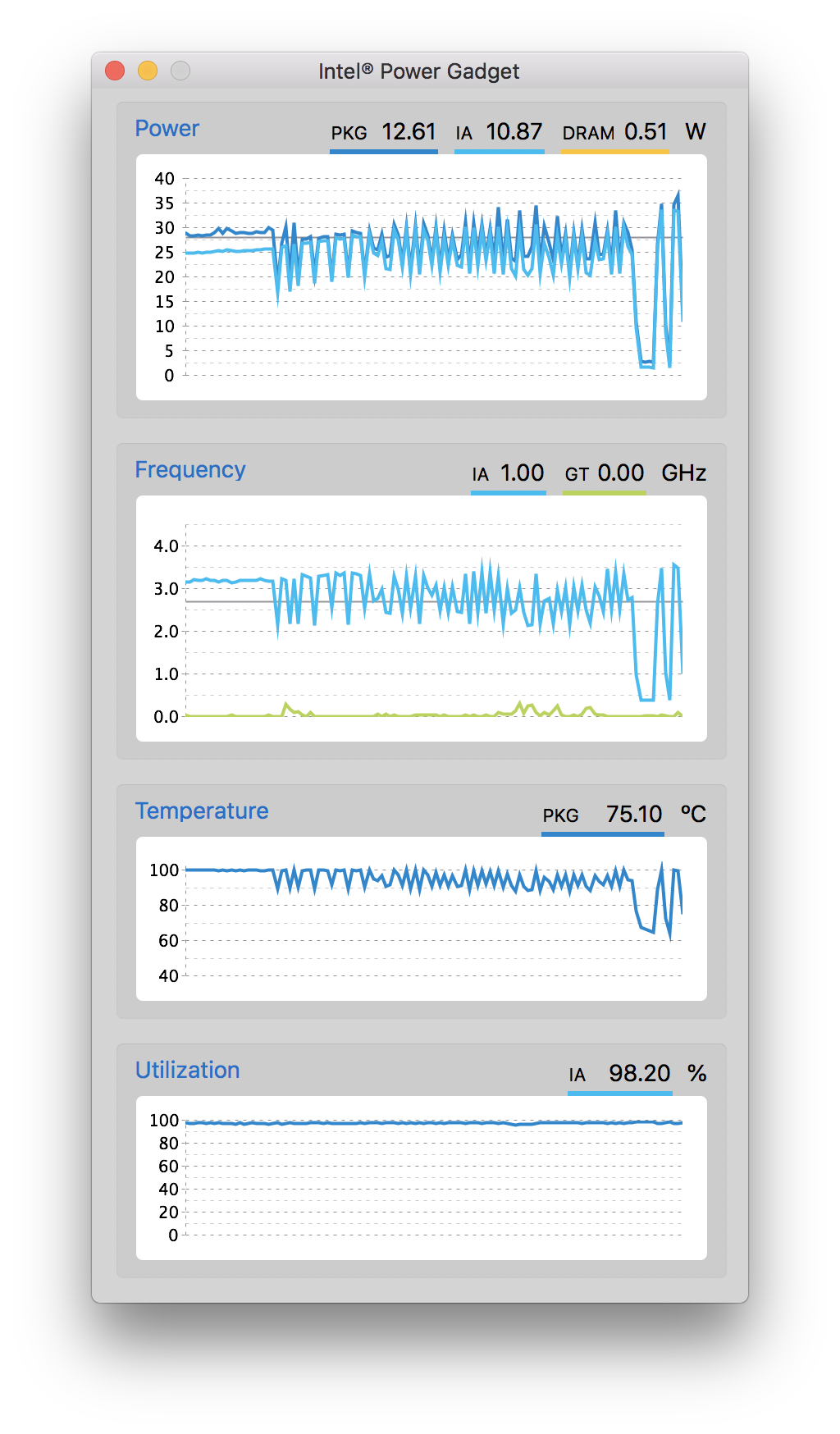

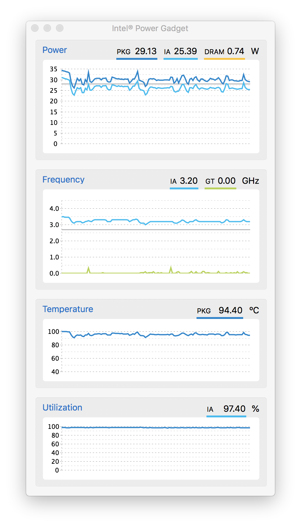

From my first test running 8 threads 'yes' binary on 13inch i7 2018 MBP before and after - it's fixed:
Before:
After:
Performance greatly improved. Maintains higher than base clock speeds whereas before it was dipping under base frequency. No drop off to 800Mhz.
Before:
After:
Before:
After:

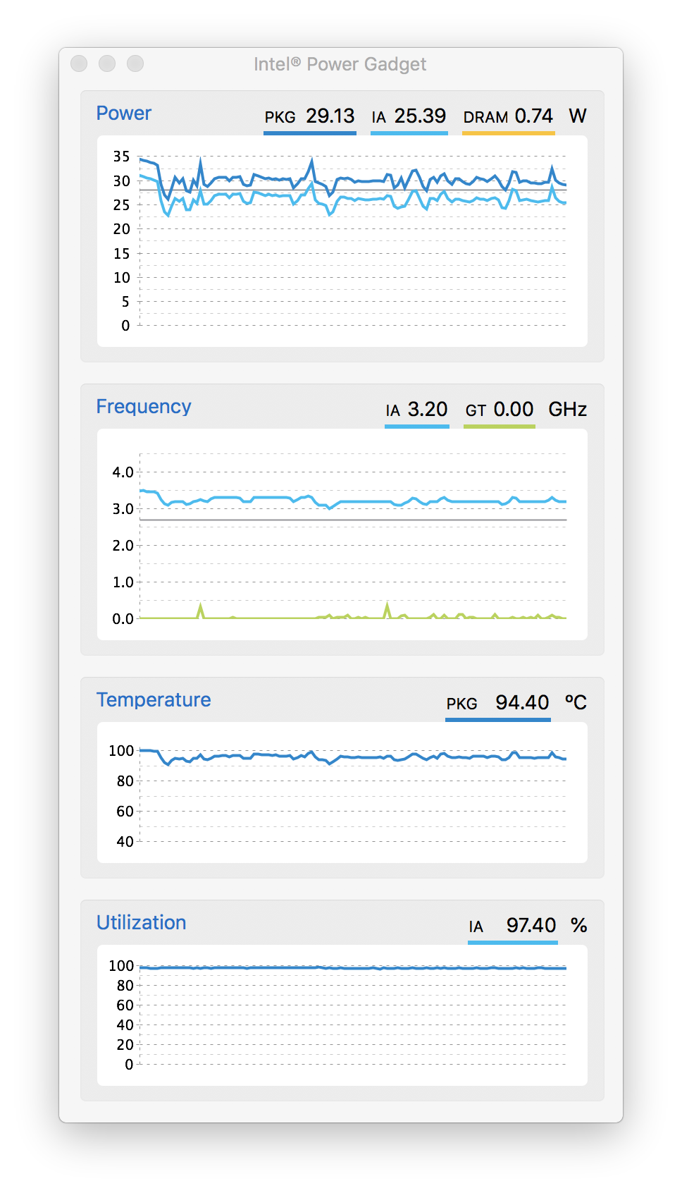

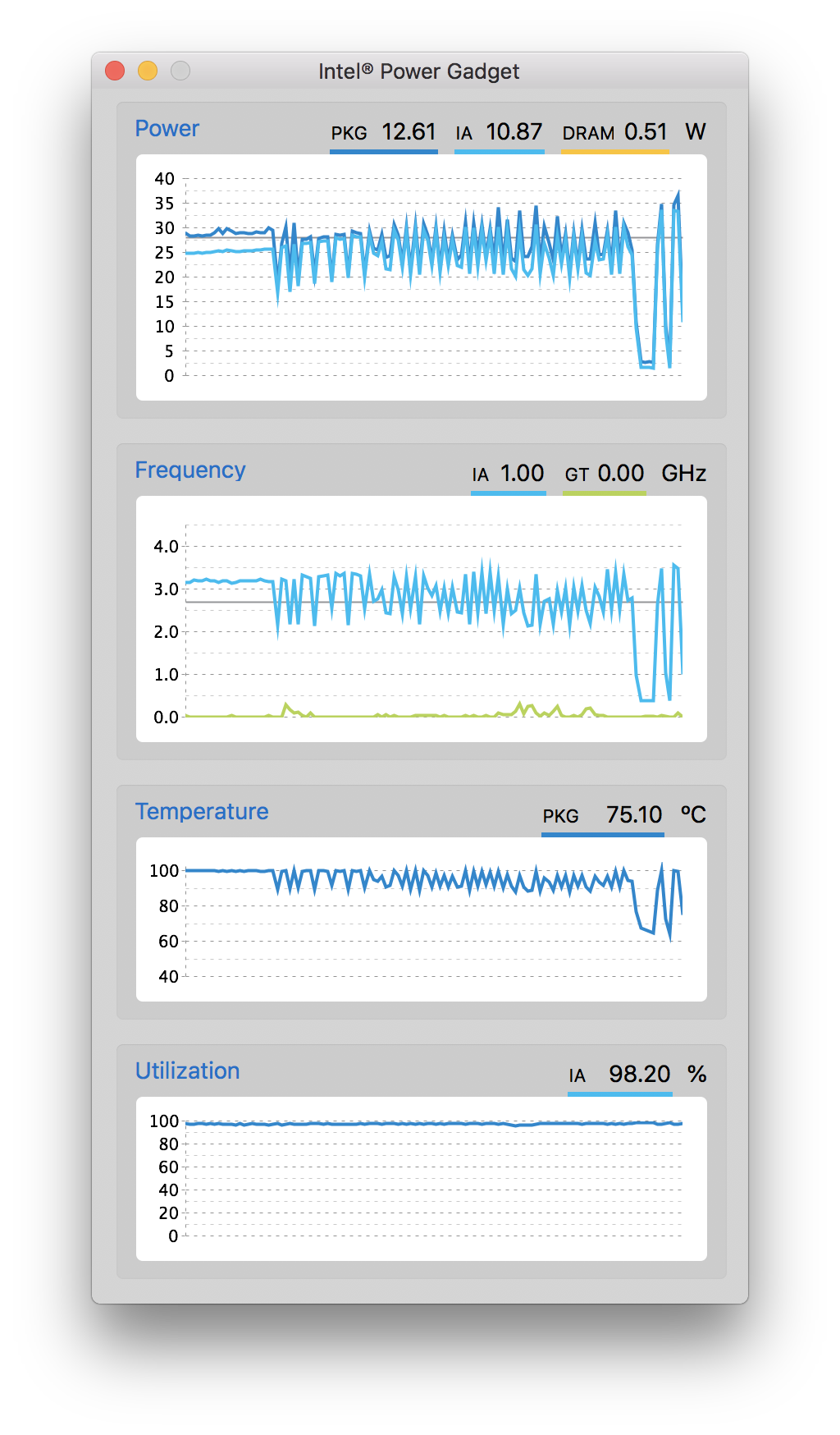

My results from i7 2,6 GHz postpatch
EDIT: Cinebench CPU runs
The last run:
The last run:

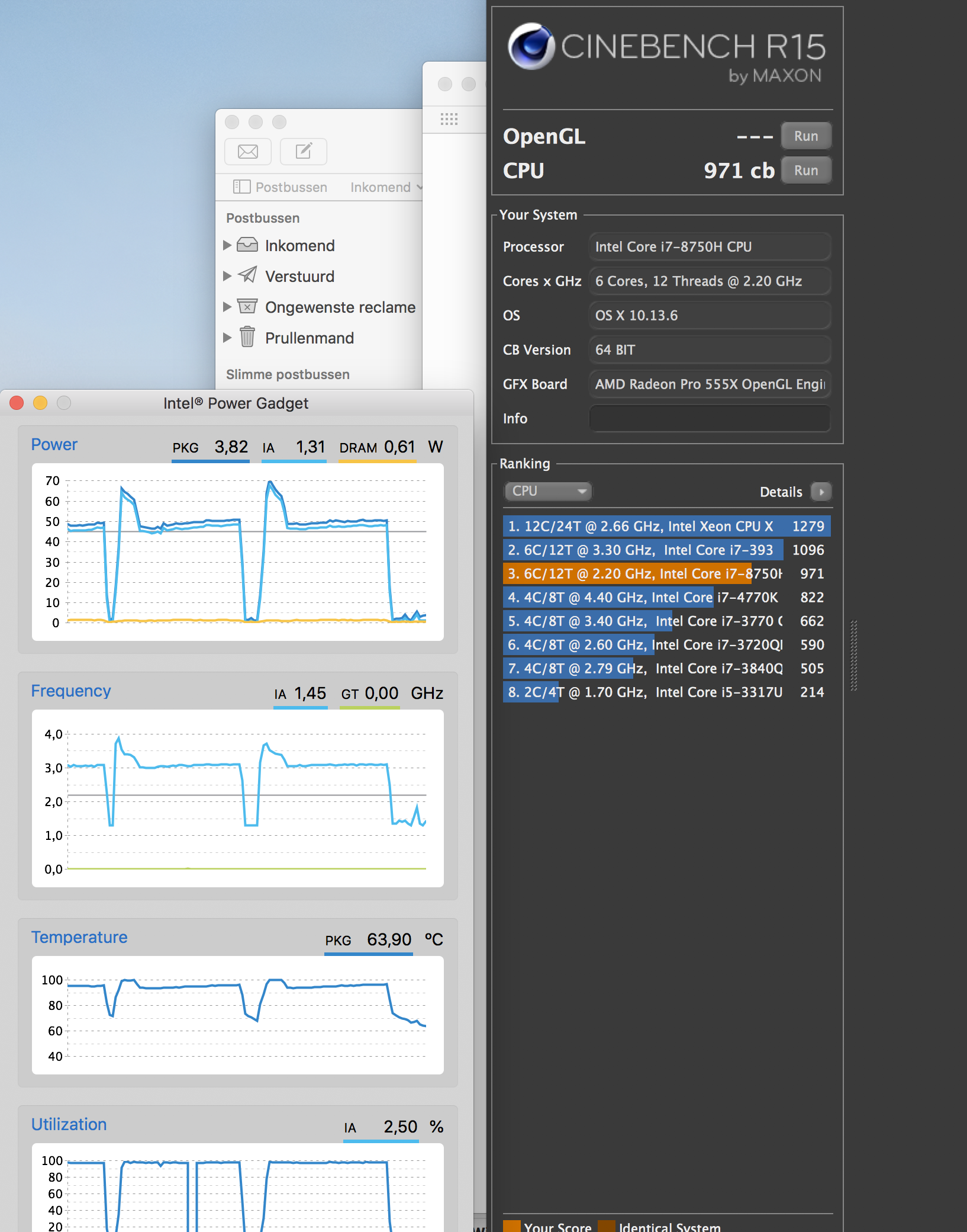

Those scores don't seem that good... My 2.2 i7 got scores like that even straight out of the box (even with some throttling). Gets scores in the mid 900's with Volta set to power limit at 45W. Hmmm..
Apple definetly fixed the issues. Getting consistent scores in Cinebench without throttling. This was run on a 15" 2.2Ghz i7.
First score 1032
Second score 963
Third score 983
Fourth score 971
