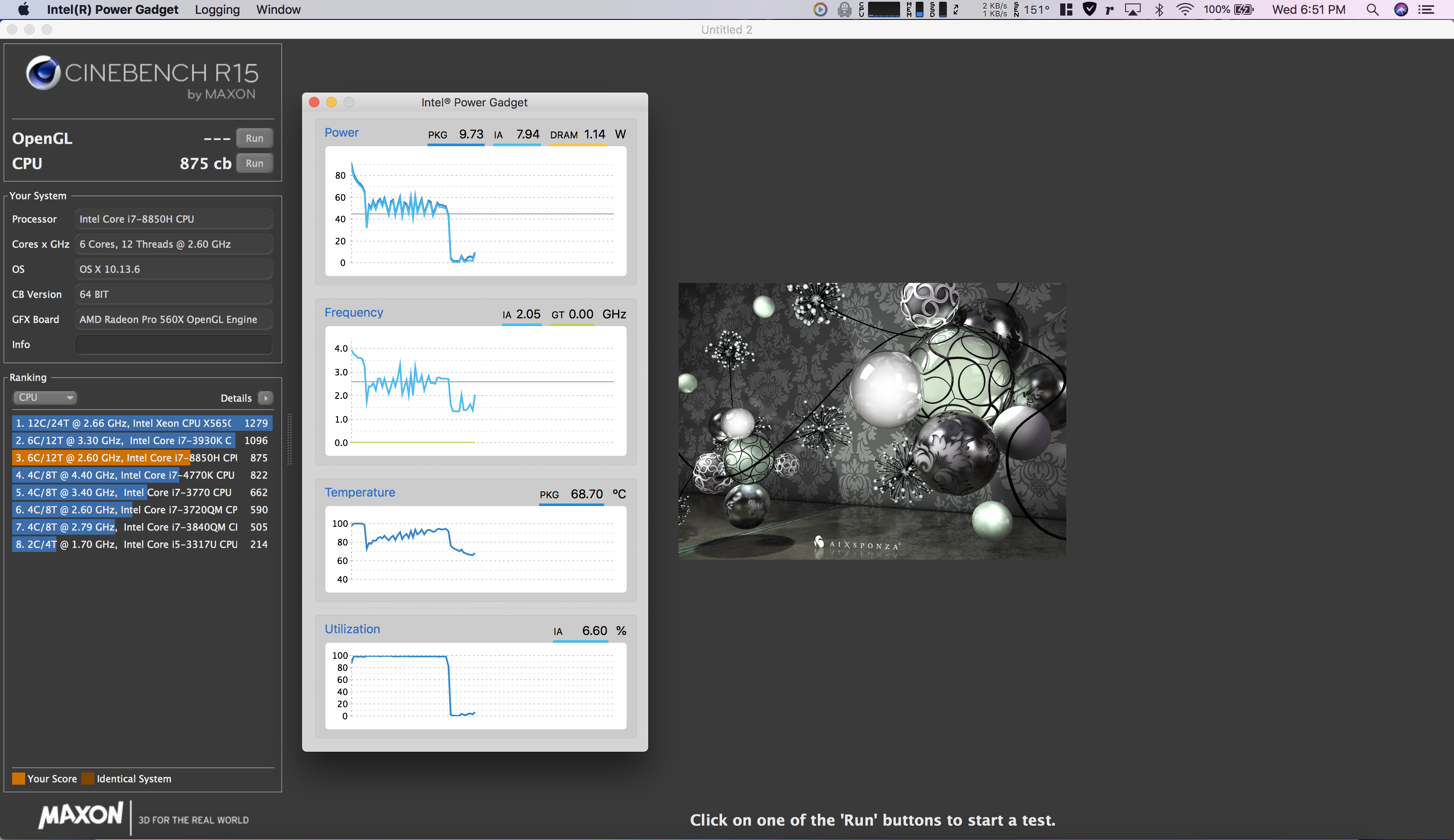

Here's another data point. i7-8850H 2.6GHz. This thing is a roller coaster.
Reactions: M.Rizk
I let it run till the test ended. How do you make it run longer?
I have a feeling this has something to do with the almighty software optimization. The temps aren't really that crazy, especially at the start of the test, but the freqs are still jumping around. Anyway, good to see the lower end can hang with its base clock at least.
