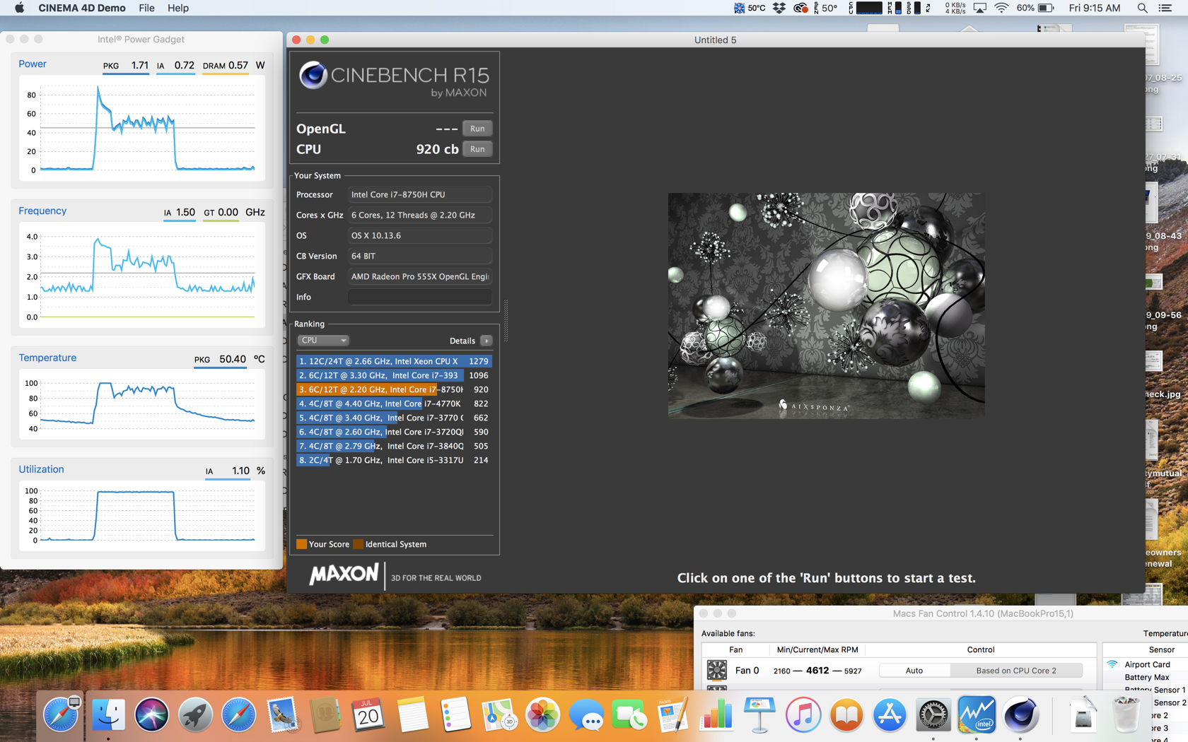

So your 2017 hits 100c at one point? That in a weird sort of way is a bit encouraging. Below's mine and
I seem to be getting better numbers from my 2.2 base model then your 2.6 model 😱
I'm using Macs Fan Control, but even without that, I'm seeing CPU only numbers in the 920 range. It spikes right up at 100c and then starts banging around the 90c range until it recedes back to something more respectable.

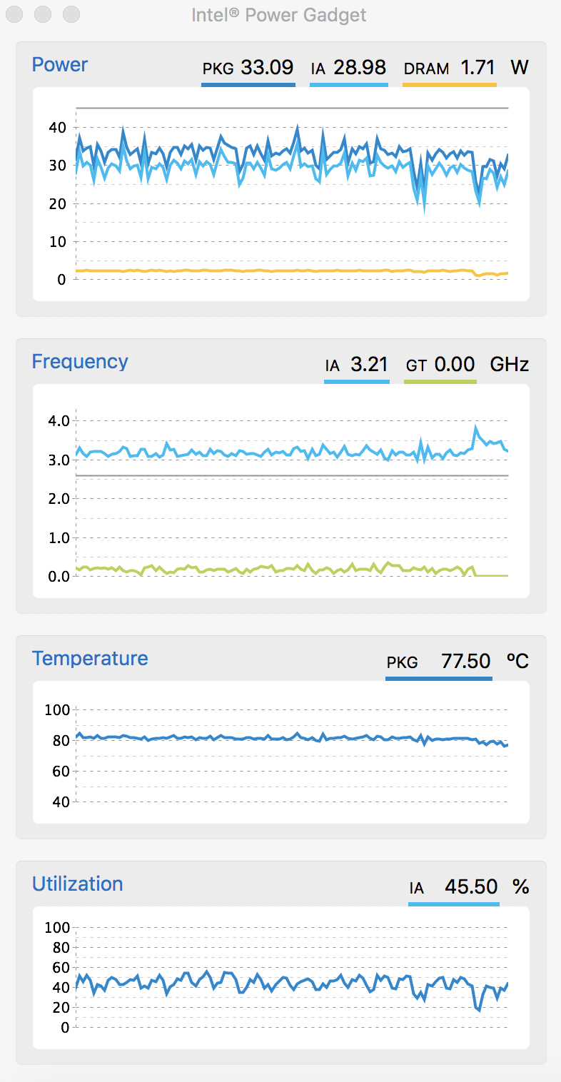

Prime 95 torture test... about 12 mins in:
