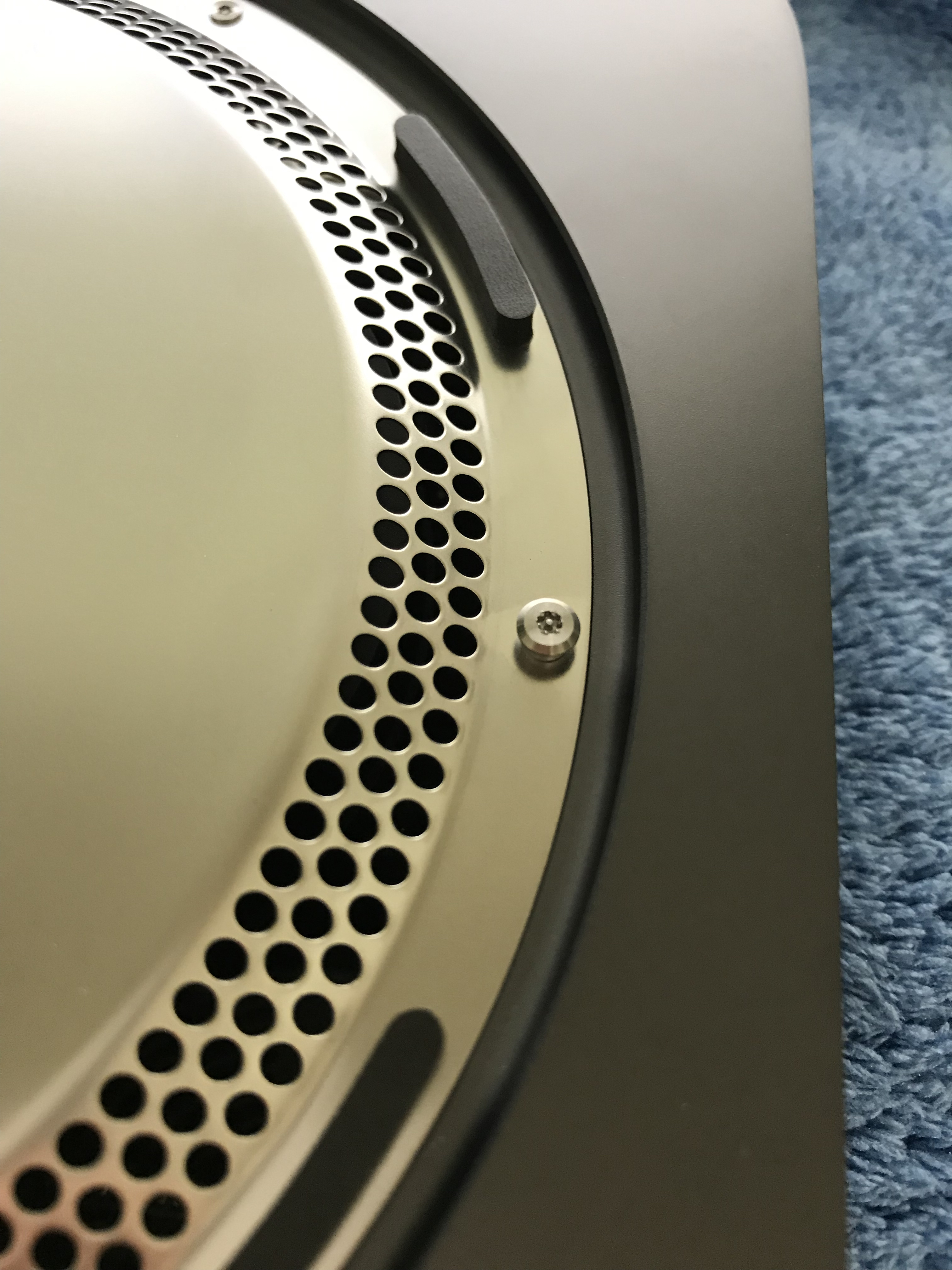

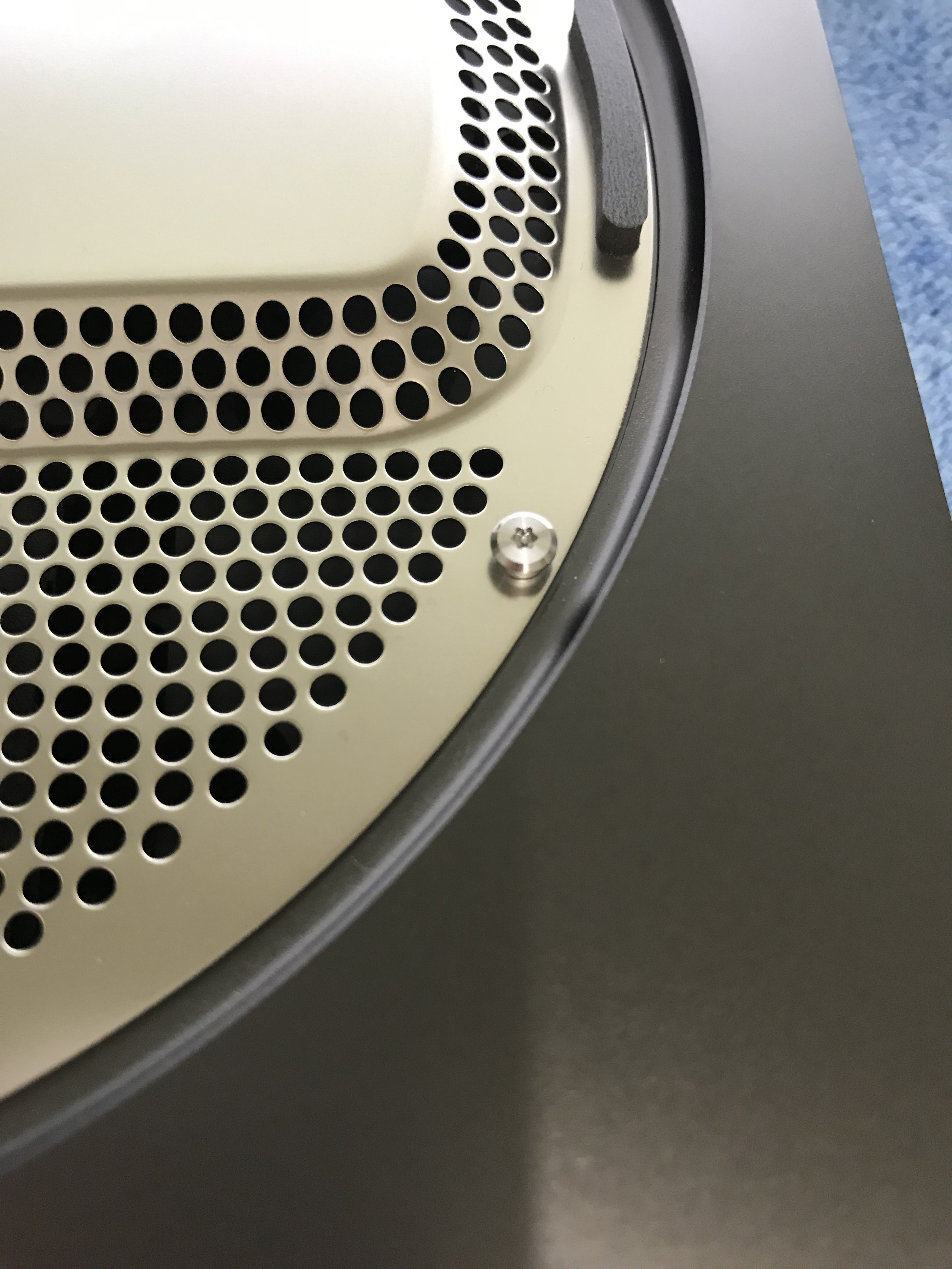

I went the route of ordering my own OWC RAM upgrade for my mini. Just popped open the bottom cover to perform the surgery only to find that one of the three T6 Torx screws/posts that hold the cover on are completely stripped (from the factory). There's no way to get it out.
What is my best course of action here? Do I take this to the Genius bar and explain the whole situation? Or will they refuse to help if I am trying to install third party RAM? Is there another way to ask?

As requested, attached is a picture of the stripped screw, as well as an unstripped one for reference.

This just looks like a standard security screw to me. Grab a cheap security bit set and happy upgrading!
