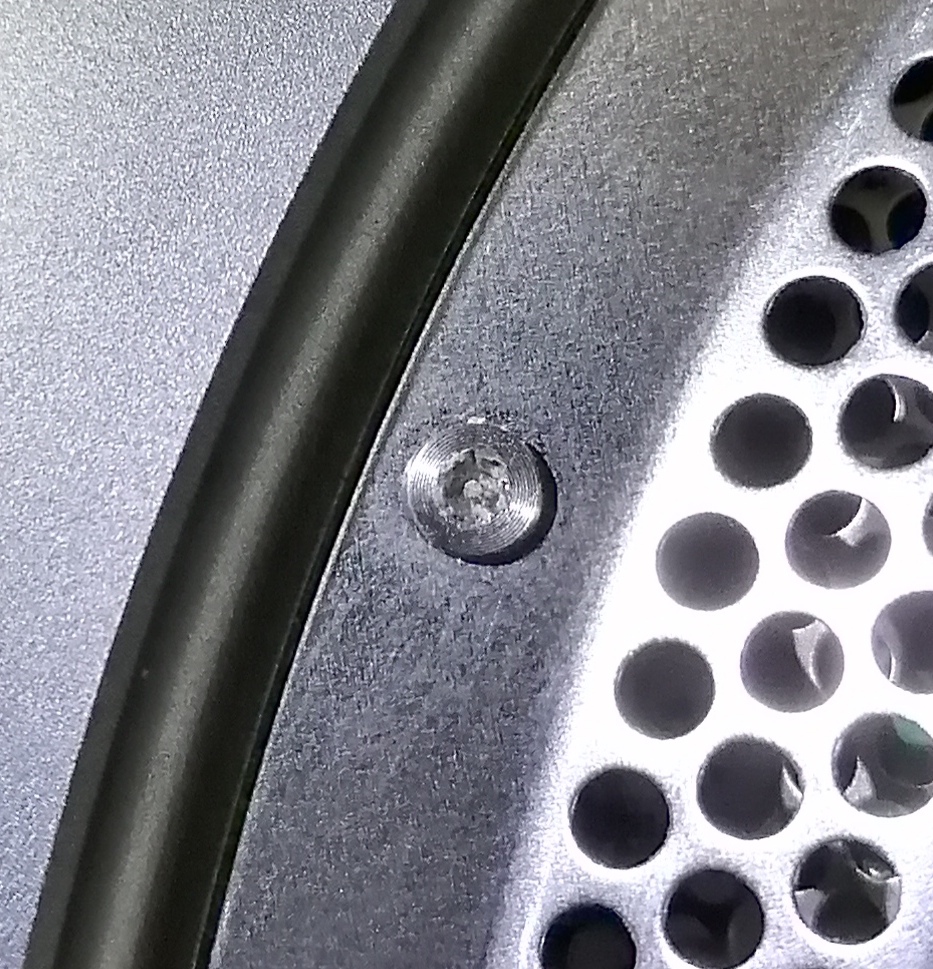

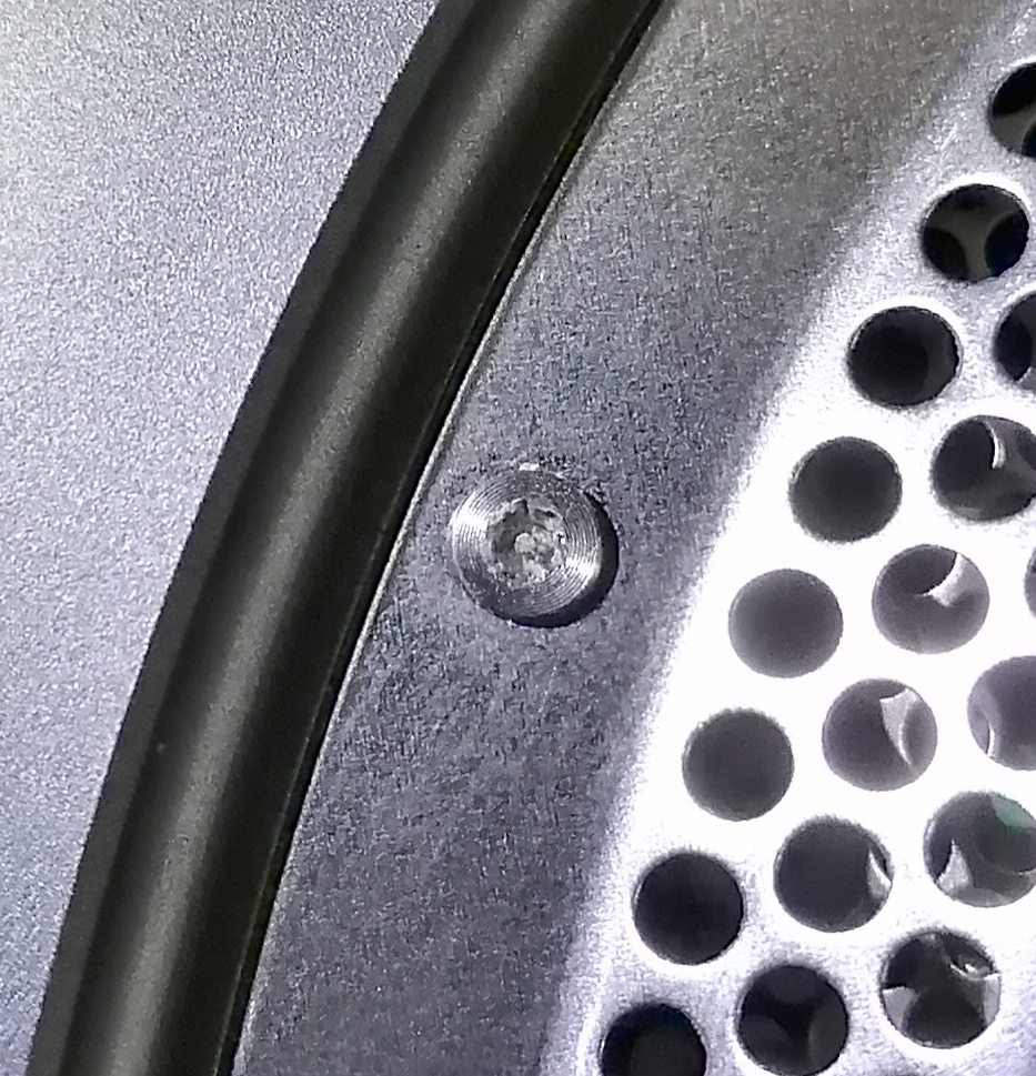

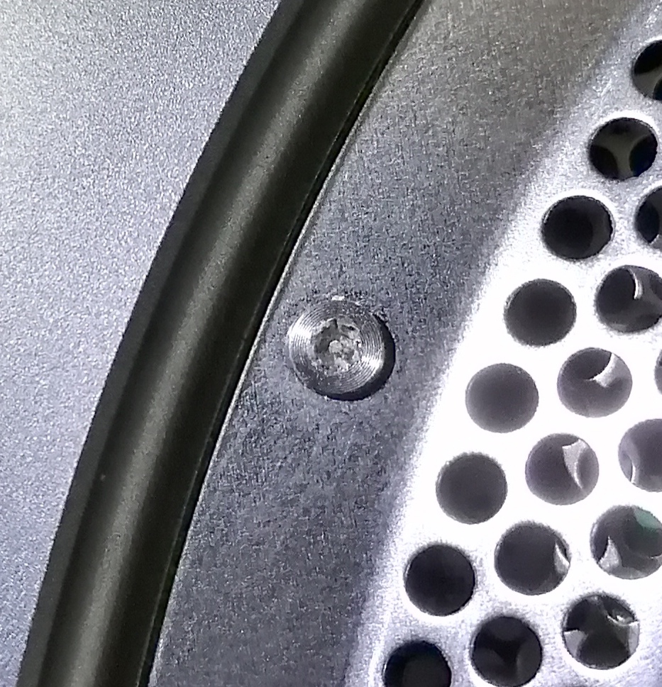

Upgraded Mac Mini 2018 Ram Earlier Today...
The upgrade was very straightforward and quite easy however for some bizzare reason I messed up when putting the antenna grate back on.
I have tightened the TR6 Security post and flush fitting screws way too much and now I have stripped some of the screws.
My Mac Mini is out of warranty, I have tried a few methods as suggested by iFixIt on YouTube including an Elastic Band method and Super Glue method, with no luck.

I have attached a photo of the worst one...View attachment 926643
If you get the right pliers, you should be able to get that out. Granted there's not much surface area, but it's also not torqued down like a lug nut 🙂
Get some small, long nose vise grips, let me find something ...
You probably won't have enough clearance to make a whole turn, but you're just looking at breaking it free, then you can even wedge (carefully) a small straight slot screwdriver to one side of the pin for a better bite - or if it's loose enough after a few times with the pliers, even a stripped Torx will probably remove it.
Try this
The threads go the other way, meant to grip screws.

that screw is protruding. Just use a pliers to clamp on it and turn counter clockwise.

Quick Update...
I ordered a new Security TR6 screwdriver from Amazon which arrived earlier today. It had very bad reviews in regards to it’s quality but was the only one that was available with the fastest delivery service.
Thankfully it came in handy but is already starting to wear away at the tip so maybe I should have gone for a better product.
Good news is that I’ve managed to remove all but one of the screws now, the one remaining is pictured in my previous post.
It’s one of the flush fitting screws and does not stick out a great amount, probably less than 1mm, so I’m very wary of how to get this one out without causing any damage.

Good News!
After much struggling to remove the screw, stripping it even more and slightly scratching the antenna plate surrounding the remaining flush fitting screw. I took the Mac Mini to a local computer repair shop and they were able to remove the screw very easily within 10 minutes of leaving it with them.
I asked the technician how he managed to do it and he said that he just used a bigger screwdriver and the screw came out straight away.
In contrast, I contacted Amsys (AASP) and they wanted to collect the Mac Mini, assess the issue and also wanted around £110 for their out of warranty service, including return delivery. Unfortunately, due to the current pandemic I couldn't simply just take it into my local Apple Store.
I also managed to find a new set of screws online at AliExpress. They are listed as being for the Late 2014 Mac Mini however I do believe that they are the same part used in the Late 2018.
I thought I would update the thread just in case anyone else ever comes across this issue.
For anyone performing a RAM upgrade on the Mac Mini (Late 2018), remember to use a very light touch when tightening the screws.
