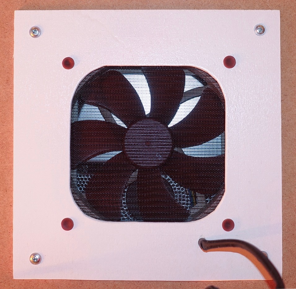

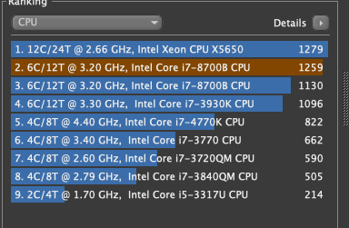

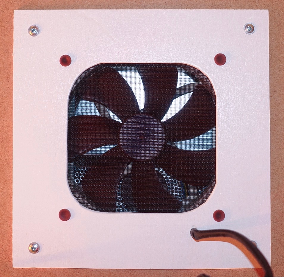

I have finished my Glory Blow Hole today.
The work was worth it. The whole Mac is way cooler now. Especially components like SSD and Airport stay much cooler. And in idle (with watching Twitch) the CPU stays at below 50° instead of 70° (even without hearing the Glory Blow Hole).

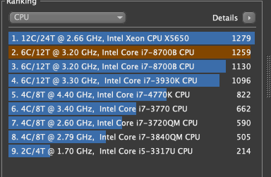

For heavy work loads the CPU got an increase of ~11 % faster rendering in tasks like Cinebench:
Before 1130, after 1259.

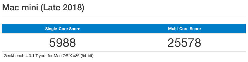

I can do that later.
But I don't expect to get higher scores than other i7 Mac Minis. The CPU at geekbench does not get high temperatures. So throttling is no problem here and my Glory Blow Hole does not really help.
Temperature is a problem in tasks like Cinema 4D, After Effects, Premiere, Final Cut Pro... that's where the Glory Blow Hole helps keeping the CPU cold and the Megahertz higher.

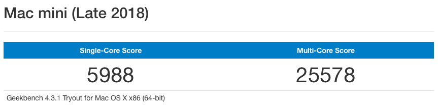

[doublepost=1544300560][/doublepost]Here's my result:
https://browser.geekbench.com/v4/cpu/11172557

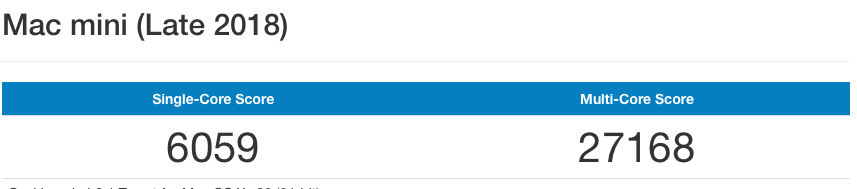

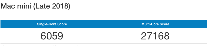

[doublepost=1544301799][/doublepost]Here another run: https://browser.geekbench.com/v4/cpu/11172775
It seems that the first run is always the slowest at Geekbench ;)
But as expected it's in normal range. Temperature is very low at the tests.
Edit: Single Core Speed is not in normal range as user Spectrum noticed later. It's top 3 at Geekbench. Maybe here the second fan helped?

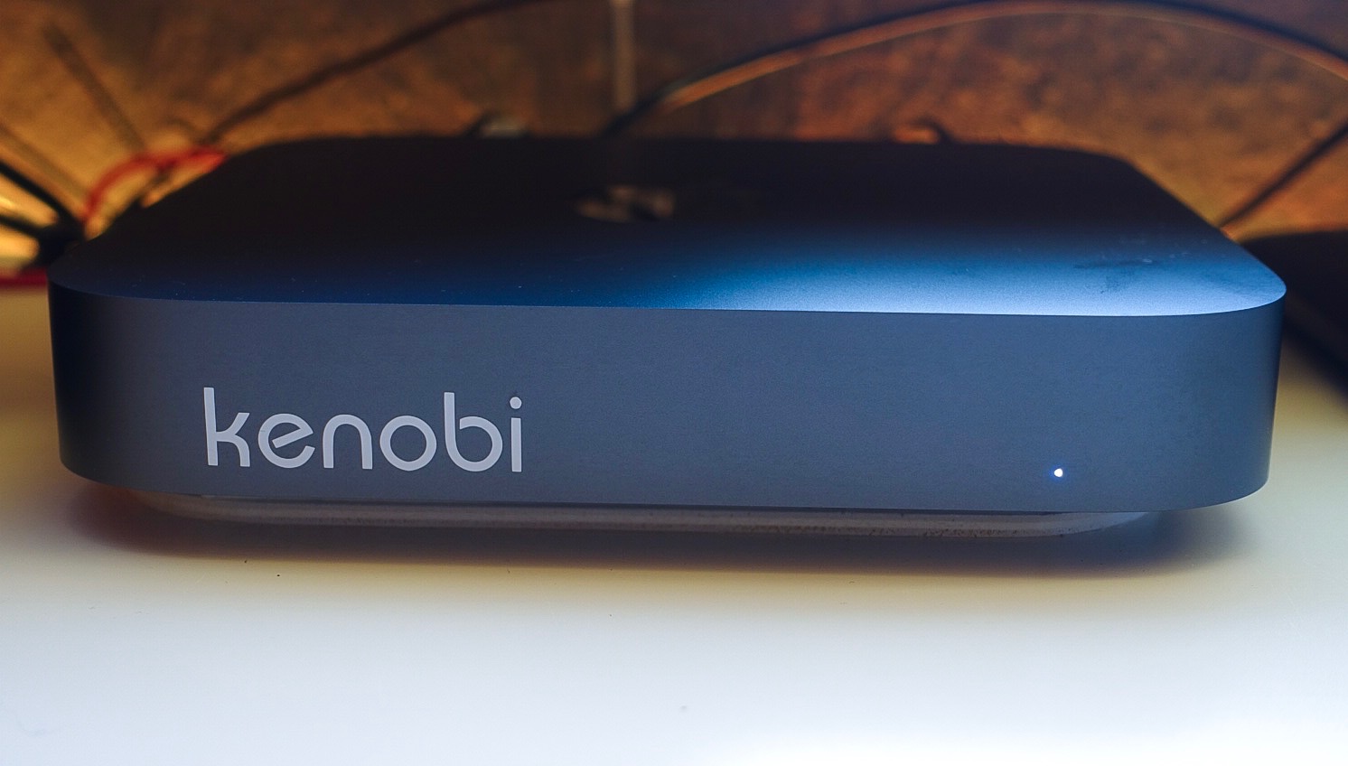

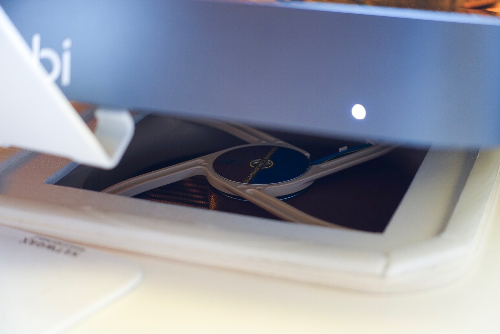

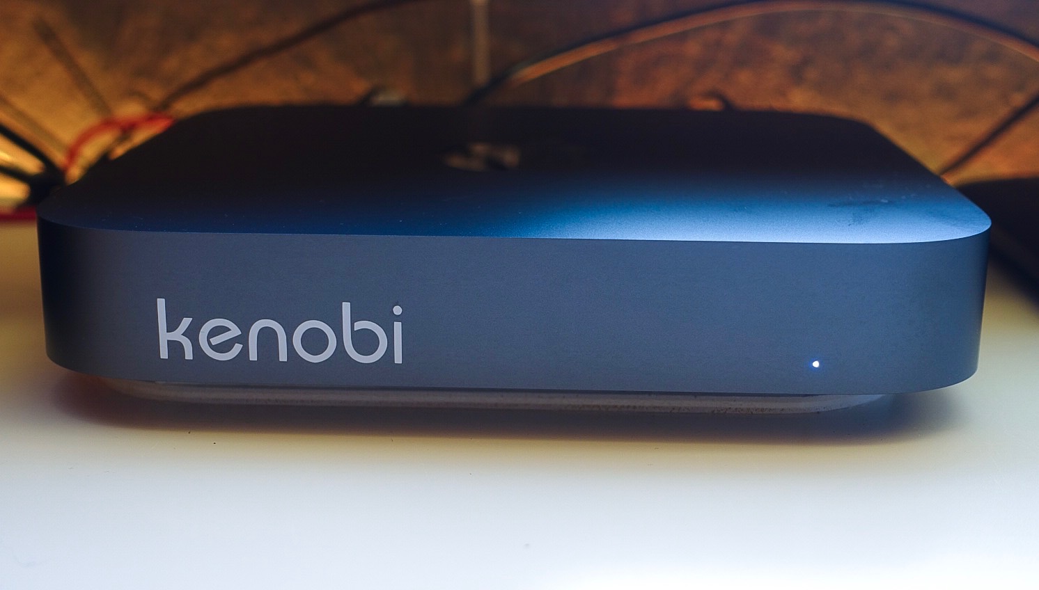

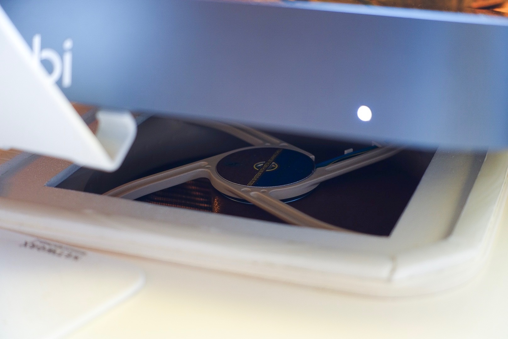

Here's a photo of the Mac Mini called Kenobi and it's Glory Blow Hole. It's almost not visible...
... except if you lift Kenobi.
From below you can see Kenobi without the plastic cap.
