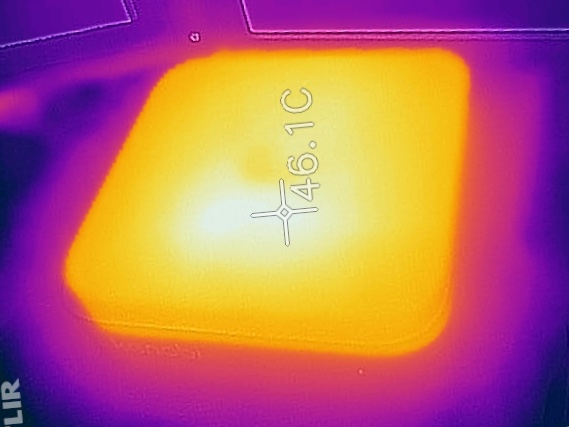

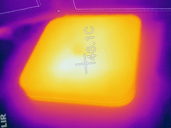

This is my Mac mini (i7, 10GbE) only seconds after wake up from sleep mode.
46.1C° is way too much imho for a not used Mac. Would even be too much for an idling Mac.
My mac mini i7 even does heat up to 70° C when it's in sleep. The case is quite warm too even though it slept for 10 hours straight.

The aluminum case is designed to dissipate heat, so it’s going to heat up relatively quickly. It’s a non issue.
Did you read the entirely message? That post was not about heat problems under heavy load, not even while idling. It was in sleep mode (for 10 hours straight)! Normally a Mac consumes nearly no energy in sleep mode that produces heat. My other Macs are almost invisible in sleep mode to the infrared cameras (maybe 1-2° difference to environment). But this Mac Mini was almost 25° degrees above the temperature of the room. That's even more than my passive cooled Gigabyte Brix based Home server at 50% CPU running for hours.
Next time your Mini sleeps, can you check how many watts it's using?
Maybe he had a nightmare? 😉

It must not actually have been asleep for some reason...maybe display was off but it was doing some background tasks?

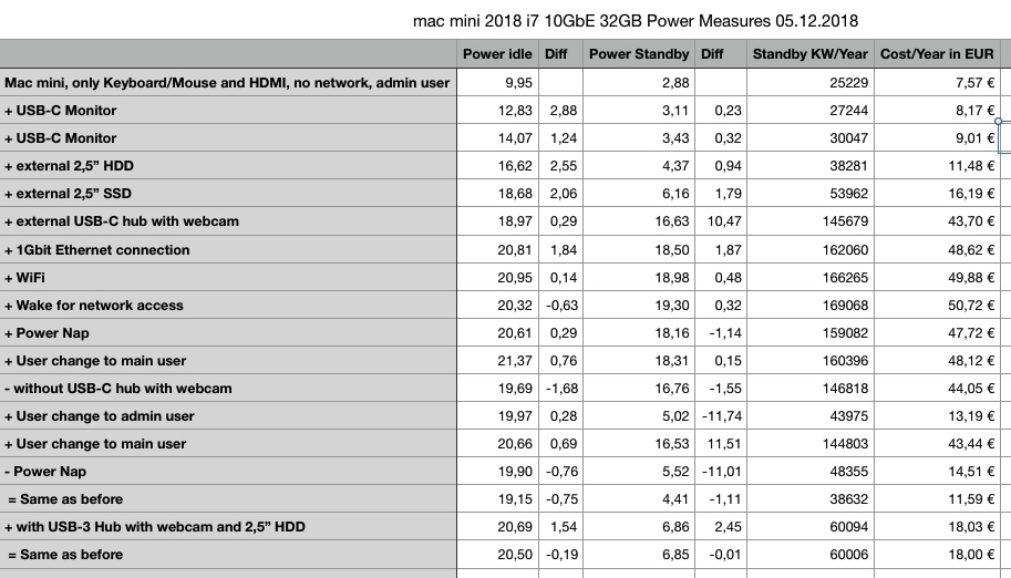

I did it for the last 2 hours. Did about 40 measures (with about 100 seconds pauses between them) and found the two reasons of my sleep problems.
Both reasons have caused to let the Mac mini not completely sleep: Monitors went off, external disks stopped spinning, but other devices like mouse still had power. In this state the Mac mini was still consuming almost 20 Watt constantly. Because the fan was not running the Mac mini heated itself up.
1. Power Nap
With Power Nap the sleep mode does not really work. Always when it's turned on the Mac mini wakes up itself (Screens stay off, but Mouse und unknown other devices are running and keep running).
2. External USB-C hub
This caused the same problem as Power Nap. When changing the USB-C hub (with Webcam in it) to a USB 3 hub the problem was gone.
Here's a screenshot of my measures. You can see that the problem came up when I connected the USB-C hub (but stayed after I've unplugged it when Power Nap was enabled). The problem was gone when both the USB-C hub was disconnected and Power Nap was disabled. Now in sleep the mac mini consumes less than 7 watts.

So heat problem number 1 of 3 is gone. Next problems to solve: Heat in idle and on heavy CPU load. The hopefully working solutions for these problems I've described above.

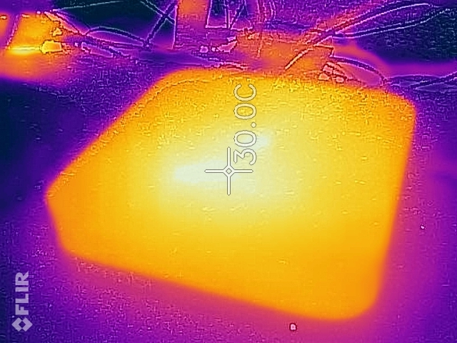

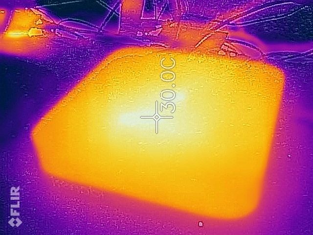

Update: Now the Mac mini has ~30°C with working sleep mode. 7° more than the environment. Much better compared to the 25° difference I had before:

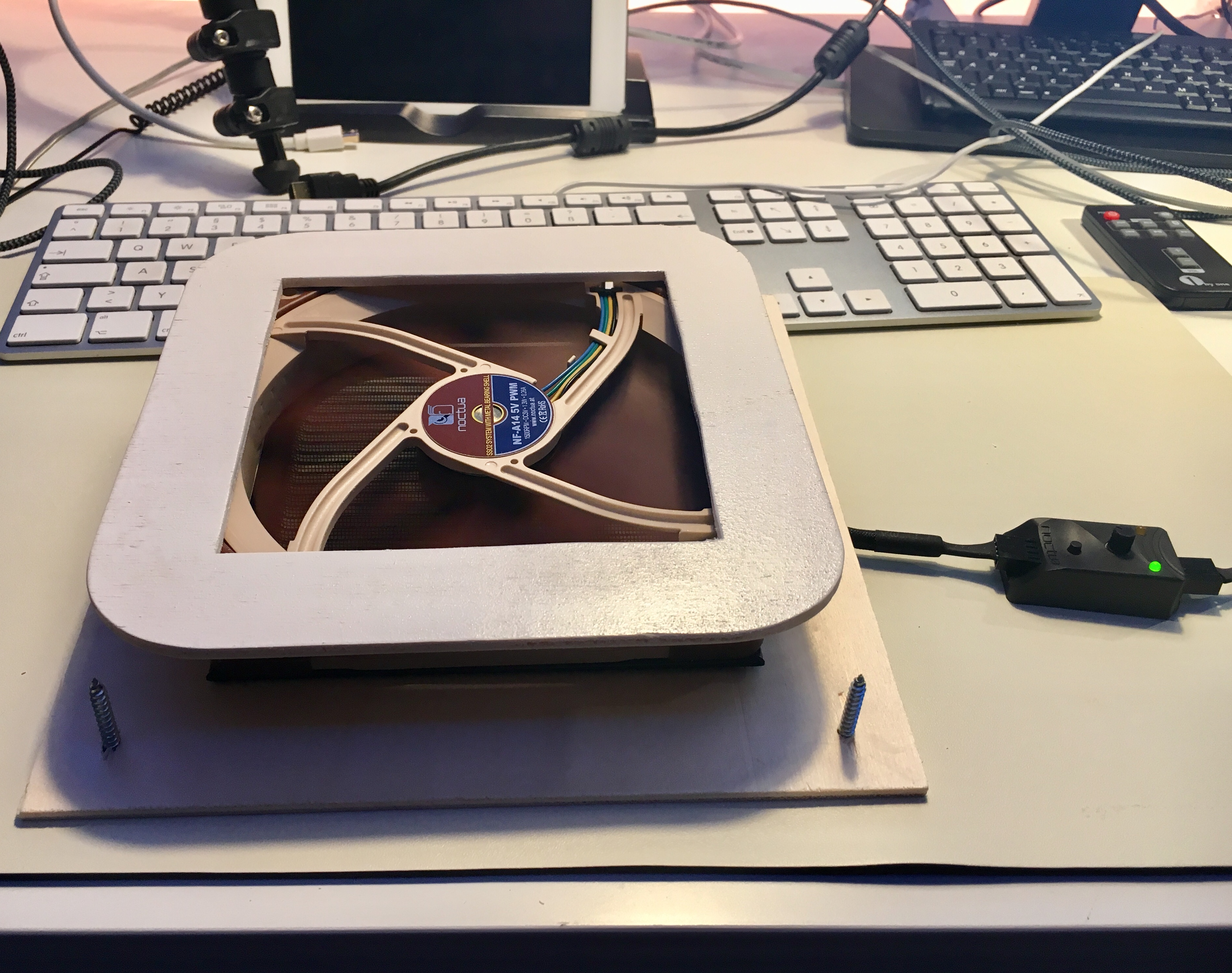

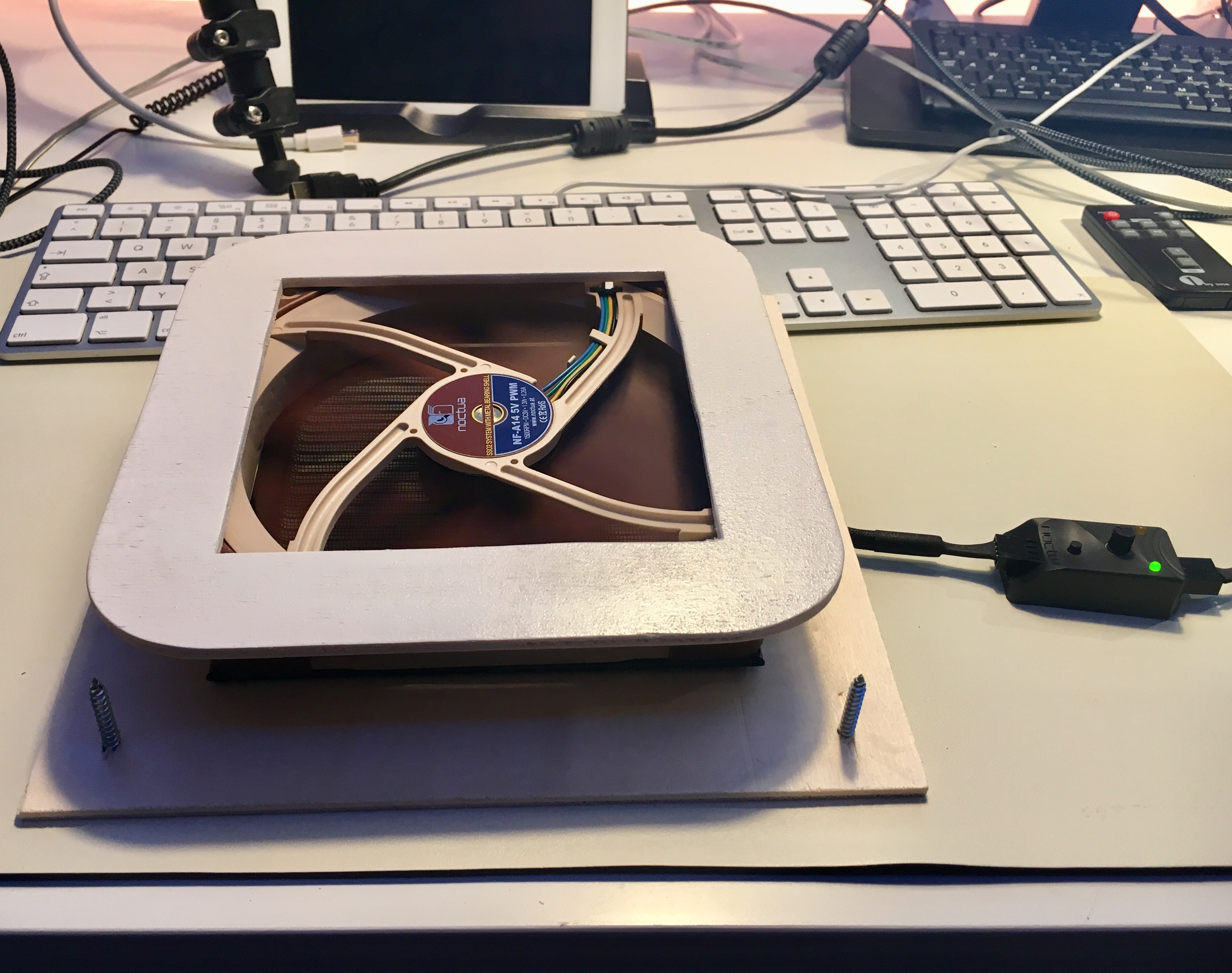

[doublepost=1544117242][/doublepost]And here's the first preview of my glory blow hole: 🙂
On the right side you can see the current PWM controller. With the Poti it's easy to set a speed which you can't hear.
All USB powered.
I realise that you think that this is an improvement, but is it normal for a mini, in sleep mode in a 23℃/73℉ room, to be 30℃/86℉? I've got mine on the sill of an open window, and it's winter here, but I'm pretty sure that mine wasn't anywhere near 7℃/13℉ above ambient when it was in a closed room.
I realise that you think that this is an improvement, but is it normal for a mini, in sleep mode in a 23℃/73℉ room, to be 30℃/86℉? I've got mine on the sill of an open window, and it's winter here, but I'm pretty sure that mine wasn't anywhere near that hot when its ambient temperature was about 21℃/70℉.
It was 46°C before (room had 21°), now it's 30° (room has 23°). Of course this is a huge improvement.
Of course that does not mean that every other Mac mini user has the same problem with Power Nap or USB-C Hubs.
It was 46°C before (room had 20°), now it's 30° (room has 23°). Of course this is a huge improvement.
Yes, but as I understand it you are now getting, in sleep mode, 7℃/13℉ above ambient without the Power Nap and USB-C hub problems. Maybe that's normal, but if so it surprises me.

if I didn't have 3 screens on the Mac mini, an external SSD and an external HDD, it would be less than 3 watts total instead of ~6,9W that it's consuming now and producing heat. But I can live with that even though I would prefer to shut the Mac off instead of using the sleep mode - but Wake On LAN does not work at my 10 Gbit model - which I need to enable remote access over VPN if the Mac is off.
All USB powered.

The glory blow hole will be inside the table and push the air through the mac mini.
Or do you mean heatinks on the Mac mini? Even I would not do that! ;-)
