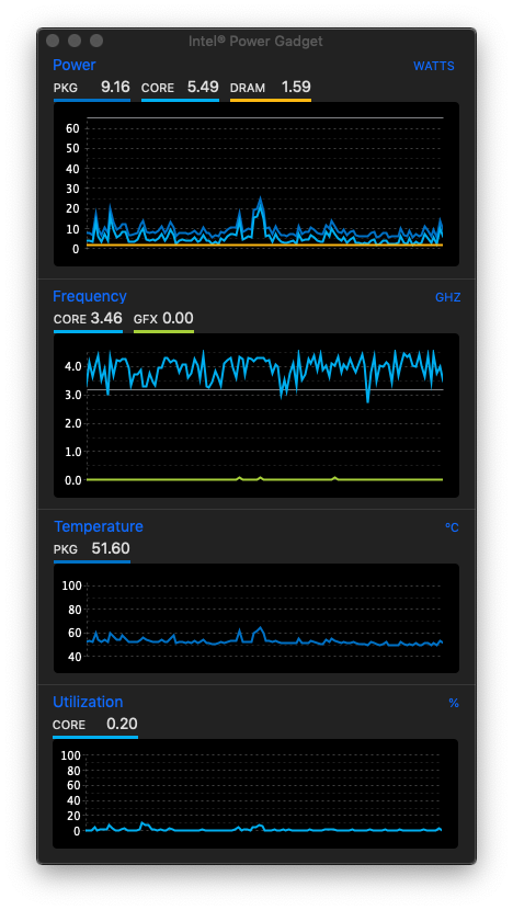

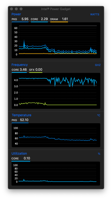

Thanks for the feedback, Spectrum. I quit all apps running in the background and the results (I think) are better. Screen shot added. What do you mean by "What update frequency do you have it set on"? Where would I find this? Thx.
(UPDATE): I believe I found the culprit. I run a Control Panel app called SoundGrid Studio. I require it for use with the DigiGrid IOS Audio Interface. Is this a good or bad thing when it continually reads 4.30 and over? Another screen shot attached, with SoundGrid Studio running in the background, and then Off. Thx
[doublepost=1547155807][/doublepost]

If I use the Focusrite Scarlett 2i2 for the audio output, in my Mini, it goes to those frequencies but only when the audio is playing, not all time.
I think it may not be that good to remain at 4.3 because the processor is in constant stress, but if you need it and it is in actual use, I don't see a problem there (unless it is constantly hot and the fans spinning?)
The Mac is somewhat hot but the fans do kick in when necessary. Even when the fan registers around 1700 rpm, the Frequency remains around 4.3, which I find odd. As you mentioned, it may not be good for it to remain at the level but it seems I don't have much of a choice. Thanks for the info.

Well, the actual CPU usage and wattage is low, so despite being at max frequency, it isn't actually doing much work. Perhaps a very intermittent call on the CPU such that in power gadget it looks constant, but it actually isn't.
If this was a laptop I would be concerned about battery life.
I'm actually glad to hear that. I found it strange that with nothing running in the background, other than the SoundGrid app, the CPU levels is extremely low but the Freq. reading is off the charts but I believe you are correct. Now, if only I can keep the temp down. Thanks, Spectrum.
