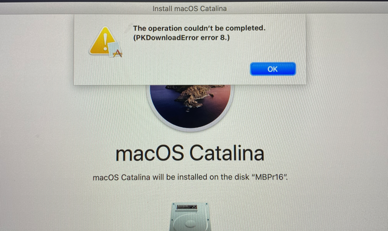

ROFL; can't make this sh*t up. Decided to attempt a wipe and reinstall anyway. My MBPr 16 can't even do an internet install of Catalina because of the wifi issues. Gets anywhere from 10-20 minutes in and then...

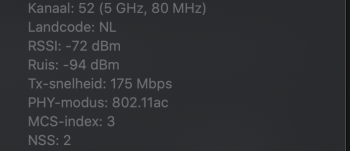

What you're describing is just how 5ghz and 2.4ghz wifi works.
