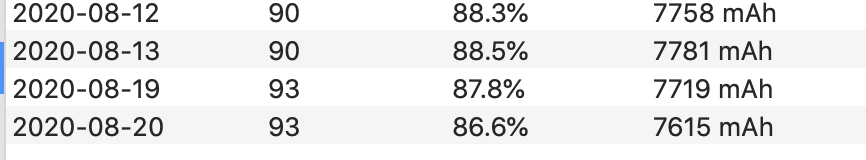

I'm alarmed at my battery health stat and charge capacity. I keep this sucker plugged in almost all the time and yet I'm going down a % every ~2 weeks? Is this a joke? AND these batteries aren't replaceable?
Is this normal behavior? Have you noticed this too? Thanks.
Been using the laptop since mid-June.

Down 7% is very unusual especially for a very new laptop. Apple guarantees that these laptops will maintain 80%+ of their design capacity after 2? years I believe.
Do realize that these apps that you use to monitor battery capacity are not going to be viewed as official by Apple. coconutBattery is probably the most accurate I've used on my 2017 MBP.
The latest Mac OS will reduce capacity especially if you leave your laptop in all the time - I've seen this with my 2017 MBP (and my wife's 2017 MBP).
Do note that leaving your laptop plugged in all the time is actually bad for it. Exercising the cells is a good thing - which is what Apple's latest battery management feature does - will cycle your battery up and down a bit while its plugged in. If you have this option off, turn it on, especially if you're plugged in all the time.
Also note, battery wear is not linear. You can drop a lot in a few months, then hold steady for 5 months, etc.

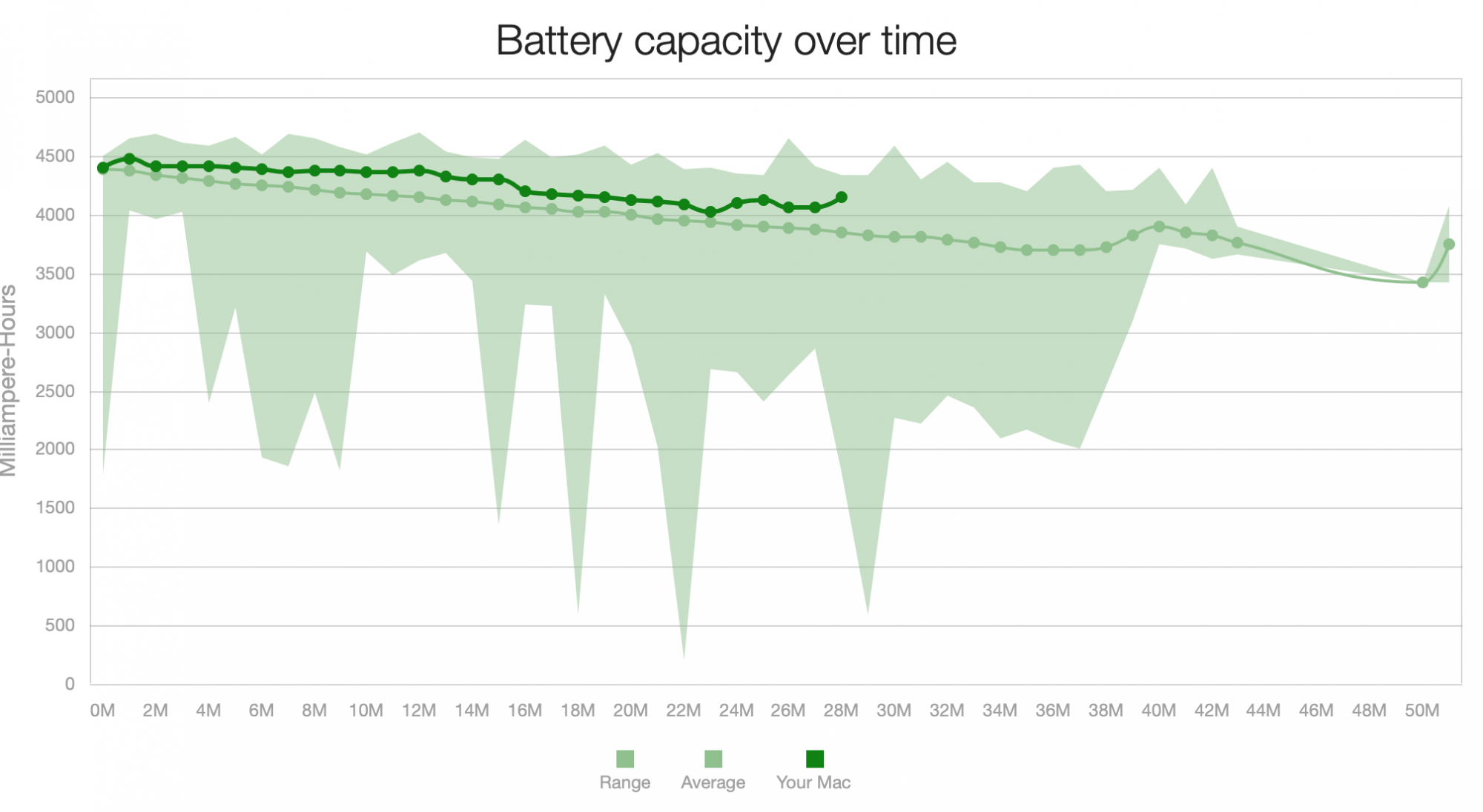

From coconutBattery: --- Note the capacity actually growing as I've started using Charge Limiter recently.

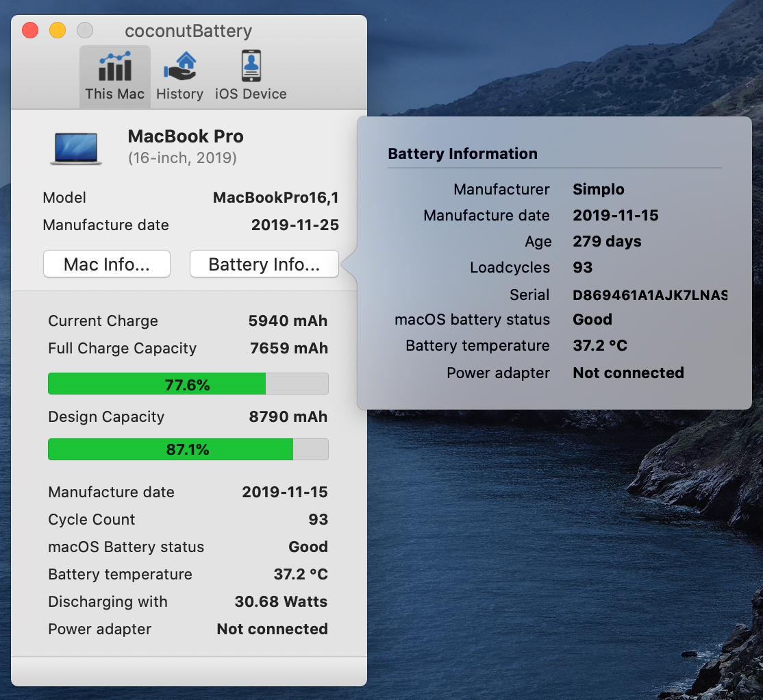

My MBP 16 has 88% capacity after 90 cycles. When I bring it to apple authorized manufacture store, they said the battery cannot be replaced.

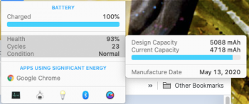

I have checked today the battery health of my less than 3 months old 2020 MacBook Pro 13" and capacity is down to
93% after just 26 cycles- that is insane !!!
This cannot be normal, or ???
Battery can be replaced but it's super expensive and difficult. I think on the later models it requires a whole top end replacement. Outside of Apple, I don't think anyone else can do it easily.

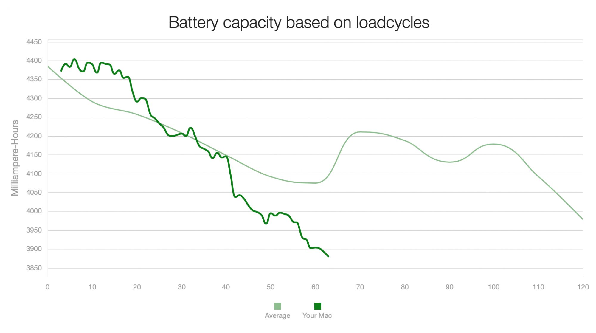

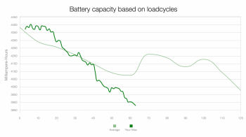

I get that it doesn't make sense to obsess over this, but on the other hand this seems pretty over the top. If CoconutBattery is to be believed, my battery is wearing out much faster than other batteries in the same kind of machine.

My take on this is that the battery management changes made to Catalina have rendered the battery capacity reading at best variable and at worst downright misleading. The experience I have had with a 3-month old 2020 13" MBP normally left plugged in, is that battery capacity readings dropped much more sharply than I expected. Down to 94% with only 10 cycles. However, a weekend away from home where I ran off battery more (still no lower than about 50%), and the reported battery capacity went back up to around 100% of the design capacity.
The Apple write-up on the battery management feature is somewhat vague about what is really going on. I suspect that the OS reduces reported battery capacity to prevent charging all the way to 100%. Meanwhile, the actual chemical battery capacity is where you would expect it to be in a nearly-new machine (around 100%). Short of Apple deciding to publish more details on this topic, I'm not sure that there is anything to be done.
