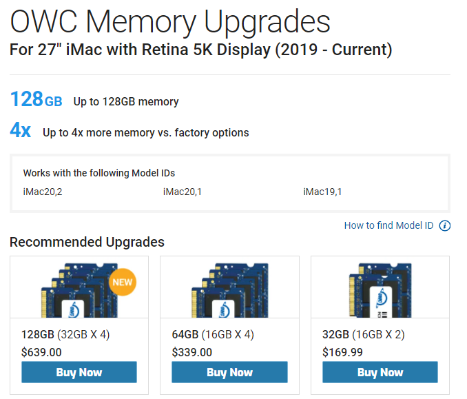

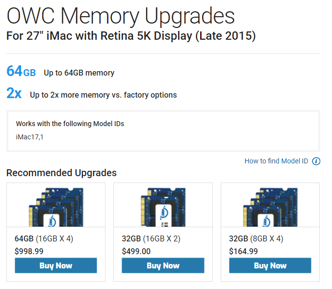

I'm sorry this isn't a direct answer to your post, but I just went to OWC and I taken aback by how much more the memory cost for your iMac than mine (2020 5K). Anyone know what's up with that? Why does the 16GBx4 option for the 2015 iMac cost THREE TIMES as much as the same option for the 2019+ iMacs? Heck, you can 128GB for the 2019+ for about 64% of the cost of the 64GB on the 2015 😮

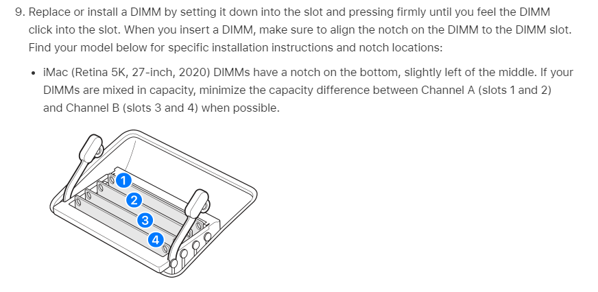

Ok, so more at your actual questions, I found this on Apple's website:
So mixing memory shouldn't be an issue, but Apple recommends minimizing the capacity difference between the two channels. In other words, they'd say avoid having 2x4GB in channel A and 2x16GB in channel B, I assume. OWC also says, "All installed memory should be the same speed for best performance." So if you DO plan to use your existing RAM along with two new DIMMs, check the MHz or your existing RAM and be sure to buy the same speed on OWC (either 1867 or 1600).

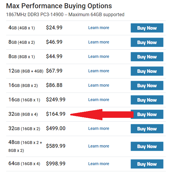

Not sure what your budget is, but if I were you, I'd probably be tempted to get the $164.99 32GB option (8GBx4) and just not use the old memory:
Because 16GB DDR3 SODIMMs are very unusual, very few manufacturers (possibly only OWC?) make 16GB DDR3 SODIMMs, so no/little competition.
Apple only officially supports 8GB memory sticks in the late 2015 iMac, although it appears 16GB sticks do in fact work. I would not recommend using 16GB sticks for the 2015 iMac, unless one has a special need for more than 32GB memory.

I would recommend going with 2x8 GB for $86.88 while keeping the stock memory in. I did the same few months ago and I am very happy. I can bet that 24 GB in total will be plentiful given that you were fine with the base for that many years
