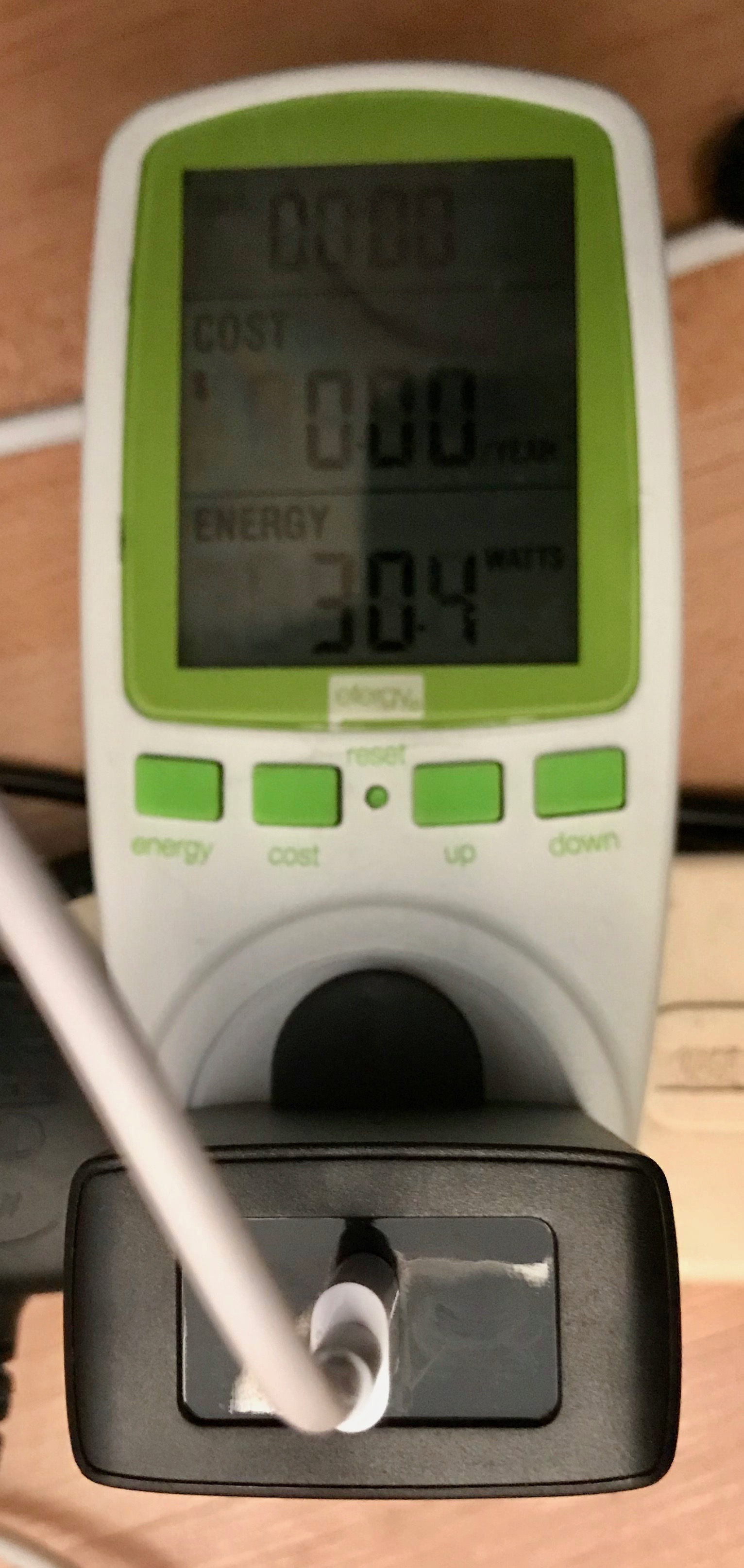

Aukey charger working nicely with my "Genuine Apple refurbished" cable....
Bought the same combo on amazon, how fast did it take you to charge your IPad 10.5 from dead to 100%? Mine took 2h 35 min in total.
I don’t know exactly, but it’s probably around the same as that. The wattage seems to drop linearly after 50%
Got quite a drop from 80/90% too. But that's normal so I've heard to protect the battery.
My other findings with airplane mode on are: 0-64% in 1 hour
0-80 in 84 mins. Roughly 1% per min.
So it seems to be on point with what other people are getting right?
