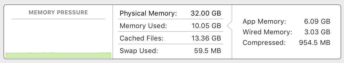

Can someone explain why the swap is used despite my having 32GB of Memory? Nothing wrong happens otherwise. I'm just curious if someone can tell me why? Screen Shot 2019-01-17 at 21.24.55.png
So it is small swap. Does it grow with time? How much time did it take to get to that number?
I would worry more if I saw page outs and they grew. Although I am not sure it shows page outs anymore.
I haven't seen it grow. Previously it was a smaller swap, but I rebooted since and today I saw it at 60mb. I'm not sure when it took place. I've seen my Ram usage go up to 23GB. That happens if I start using google maps or viewing photos or something graphics intensive. Then when I close the photo viewer or the maps tab the ram will drop back down to 20GB or so. If I reboot it goes to 7-8GB. Then as I leave Chrome windows and tabs open It slowly goes back towards 20GB and stays there usually. Typically I'm just surfing the net or watching Youtube at the same time. Occasionally open photo viewer and few other apps that aren't really GPU intensive. Nothing heavy beyond that. I"m not editing 4K vids or photos or anything like that. So I was surprised to see any swap happening at all.
I have only 8GB RAM and my of 9GB SWAP, 7-8GB of it is normally in use, even when there's free RAM. I do always have heaps of tabs open (21 right now) on Safari and LightRoom running, plus Spotify and WhatsApp.
Some critical system apps or functions also page to disk to improve stability IIRC. Same happens for me. It’s normally just a very small swap file.

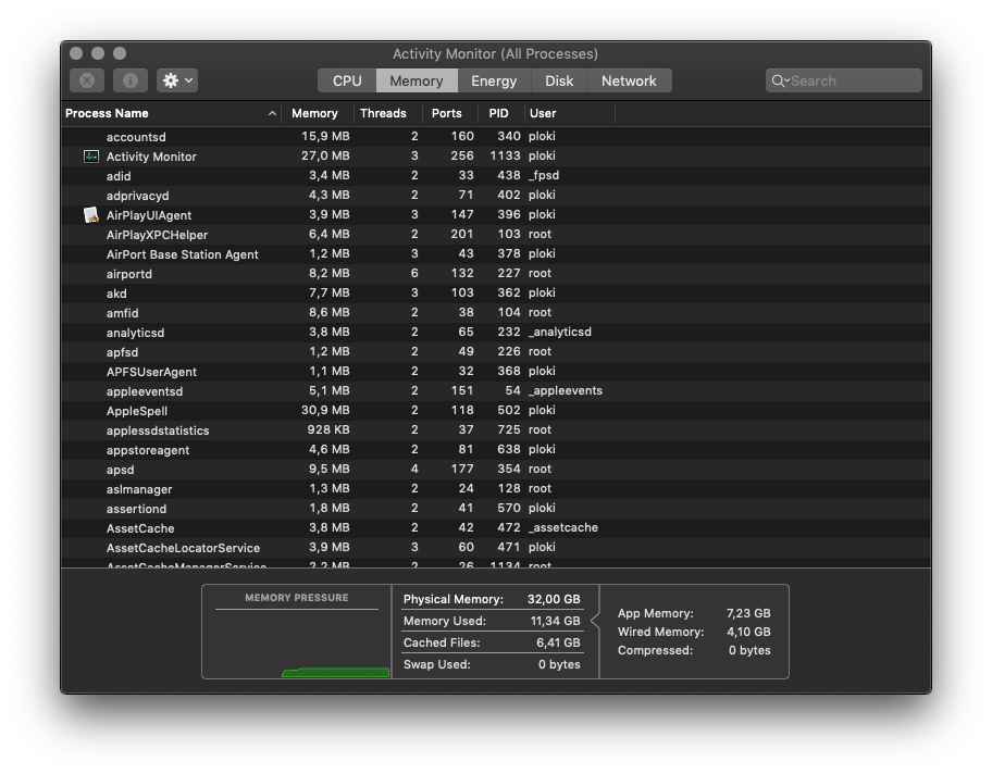

If you have 32gb of installed RAM, and you don't "push things to the limit", you could TURN OFF VM disk swapping. NO VM "page ins" or "page outs" at all.
I've done that on a 2012 Mini with only 10gb of RAM.
It runs fine and never crashes.

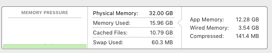

Chabig is correct, don't mess with it unless you know exactly what you are doing. Paging is a normal part of an operating systems functionality and some paging, regardless of memory configuration, is not surprising. 60.3 megabytes of paging activity is nothing to be concerned with.

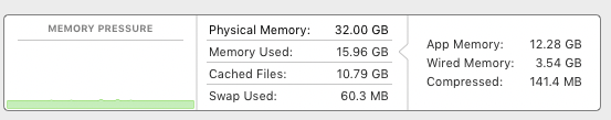

screenshot is with running logic. when i quit logic, cached files dropped for 0.5gb
Ok thanks for the info everyone. Yeah I wasn't really wanting to mess with memory management since nothing adverse was happening during my computer usage. Further reading I see this is normal behavior for MacOS and I shouldn't be too concerned. I'm coming from Windows. I thought I understood that Swap was only used when physical memory ran low enough to trigger swap. So with 32GB it was surprising. Since the GPU shares the system memory and it allocates specific amount of memory for that purpose is what I'm seeing a result of GPU causing the memory swap?
I guess on my windows system I never noticed it because I had a dedicated gaming video card. So any swapping on Windows would be unusual barring me using a photoshop type app or some heavy application like cad or something?
