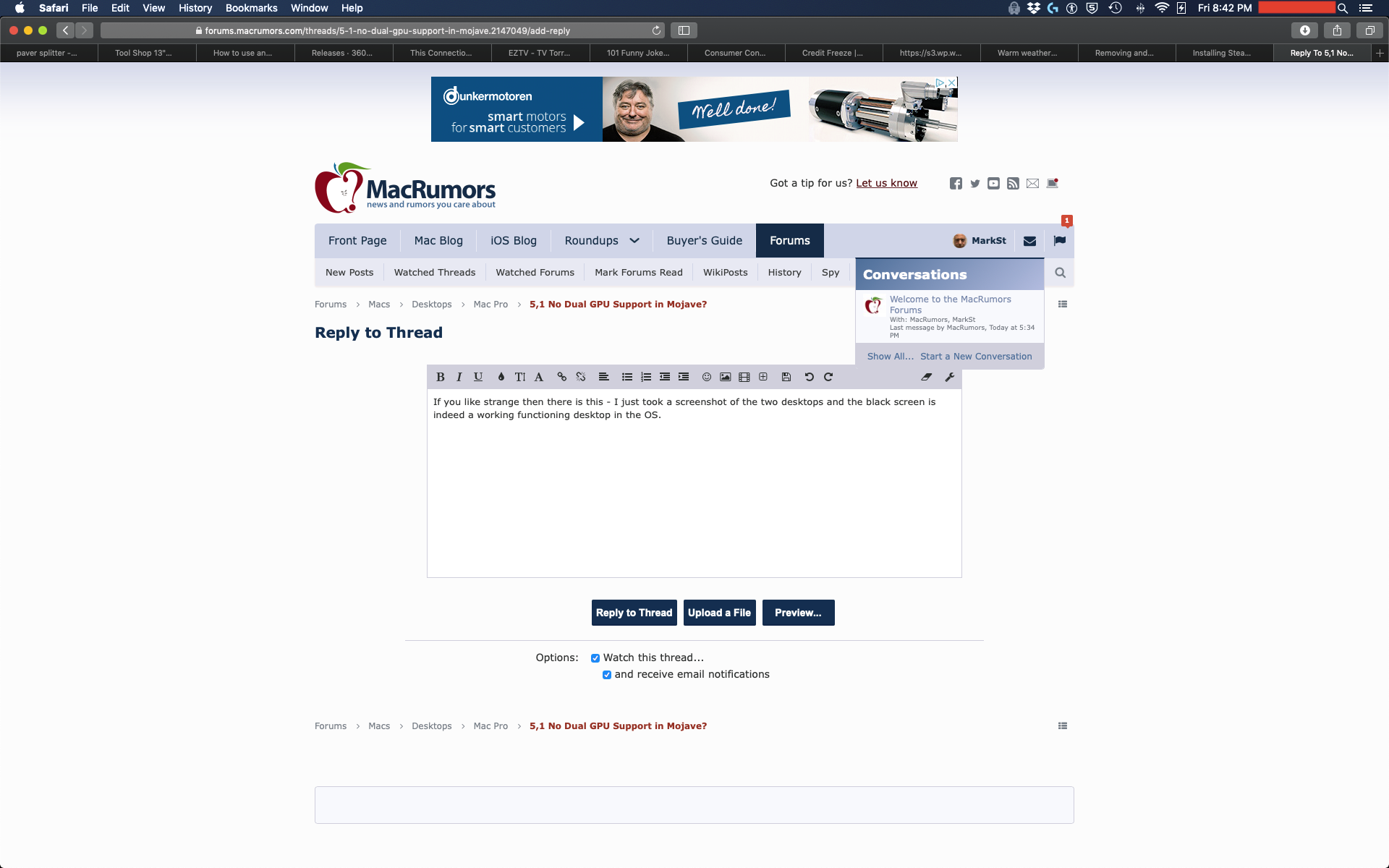

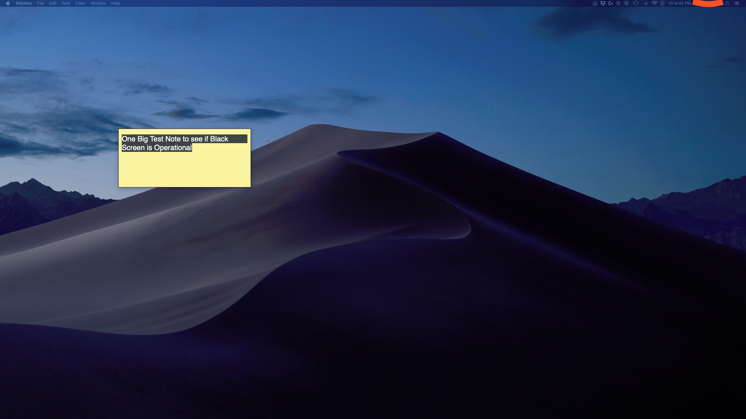

If you like strange then there is this - I just took a screenshot of the two desktops and the black screen is indeed a working functioning desktop in the OS. I created a Stickie and drug it onto the darkened screen prior to the screen shots.
The stickie is where I placed it from the drag as is the typical desktop.
If anyone can think of something that is going on here that I could correct to get both cards displaying correctly I would appreciate it ... I can't even think of a good place to start on this?

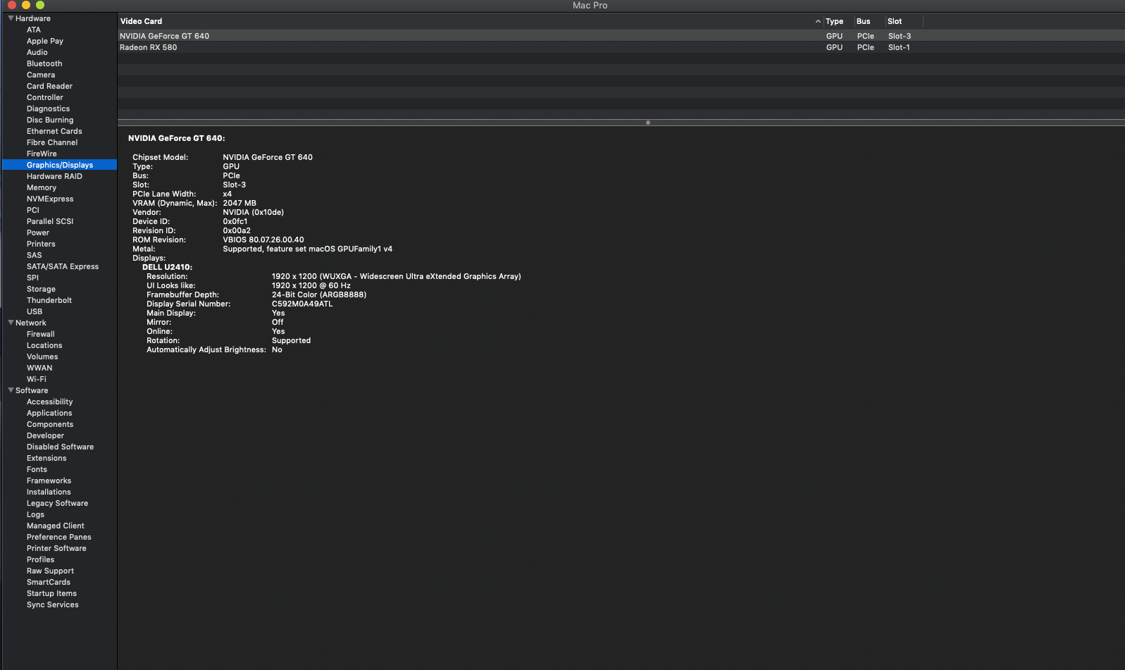

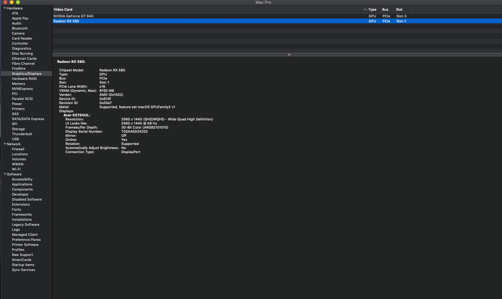

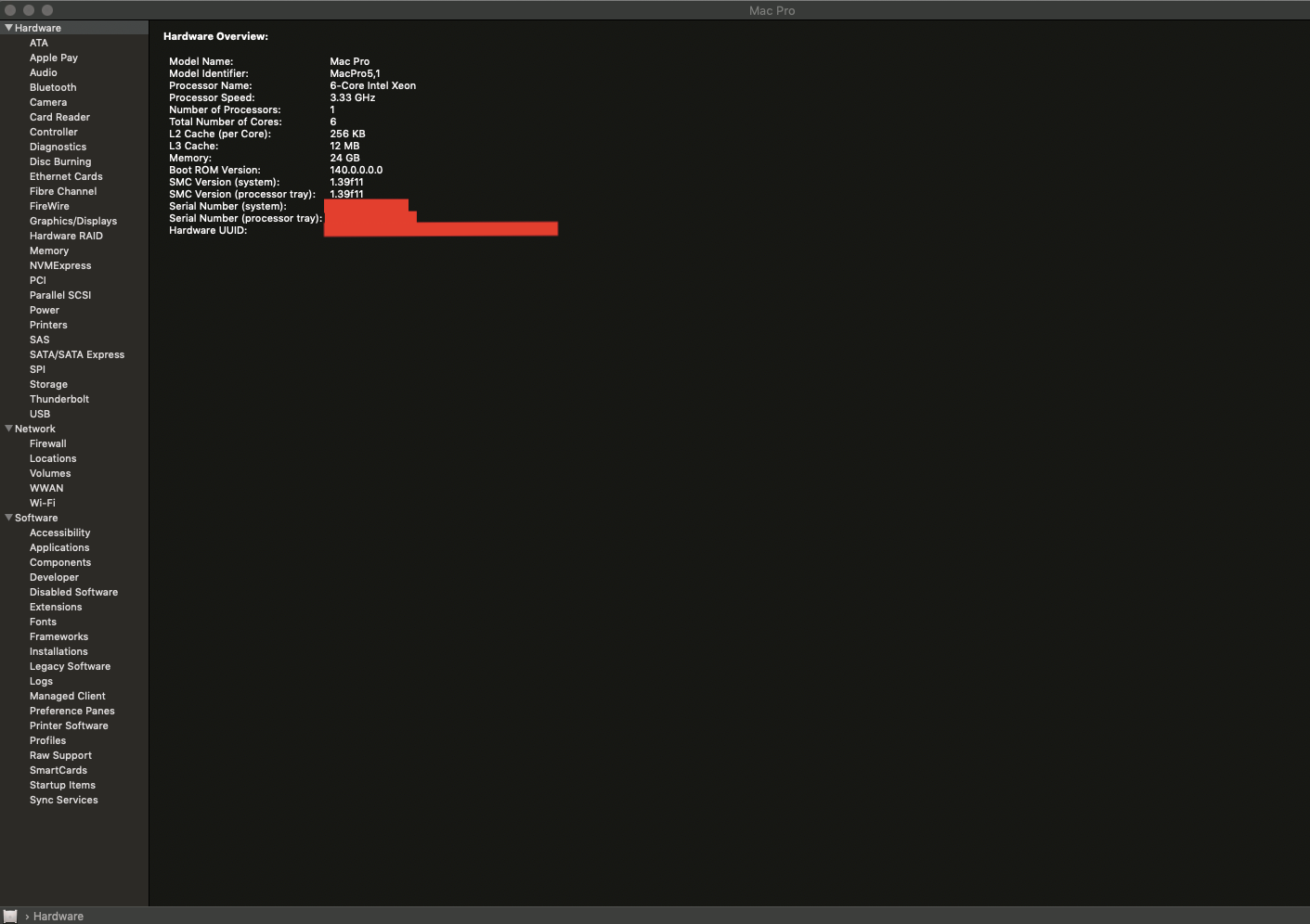

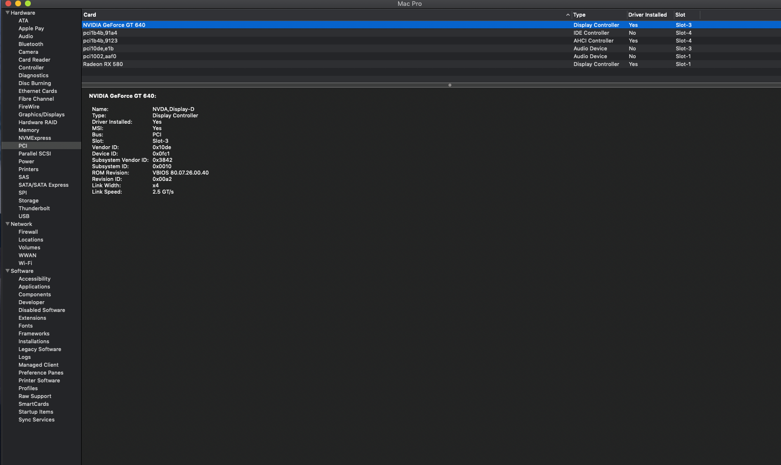

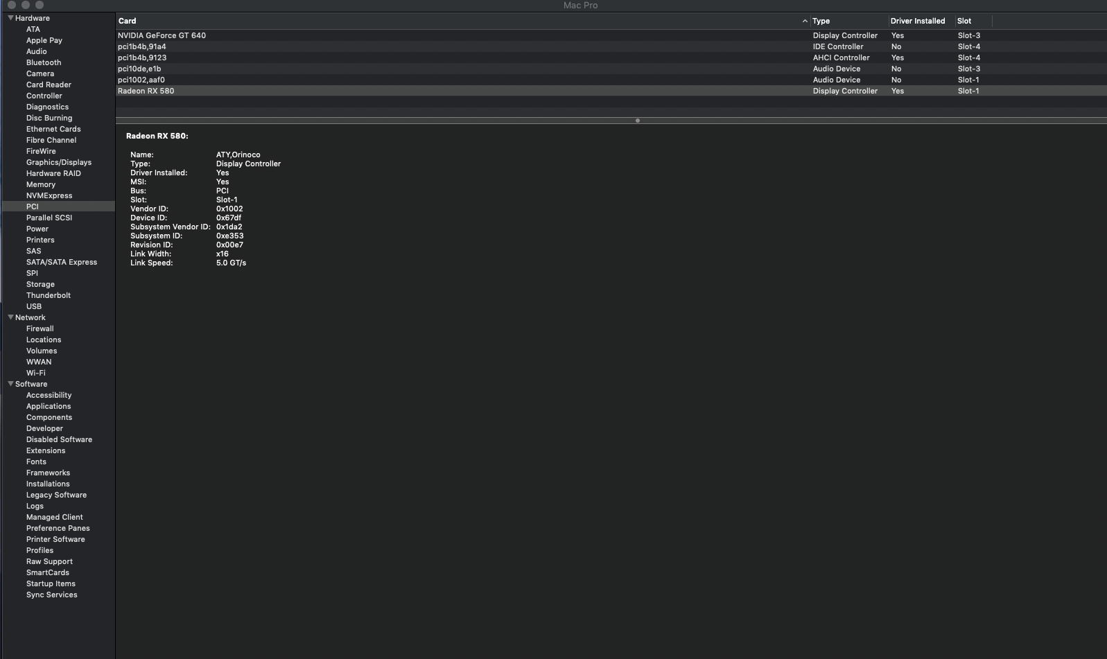

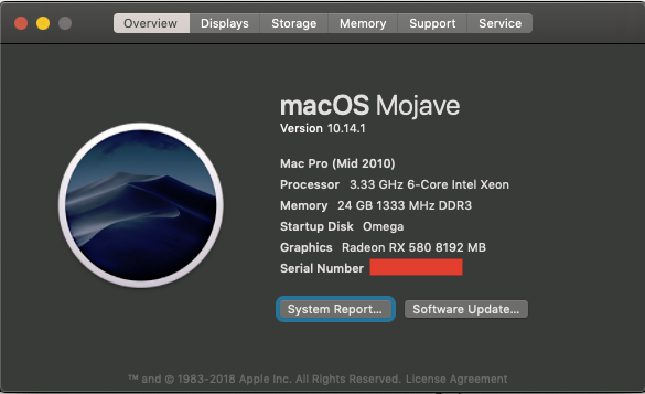

Here are some screen shots from today and last night - not sure what to block out exactly to protect from posting so if I overdid it sorry - If I left something exposed that I shouldn't have please let me know.
Pics from today are with just the RX 580 installed supporting both of my monitors. Those from yesterday show both cards installed with the dark screen problem
