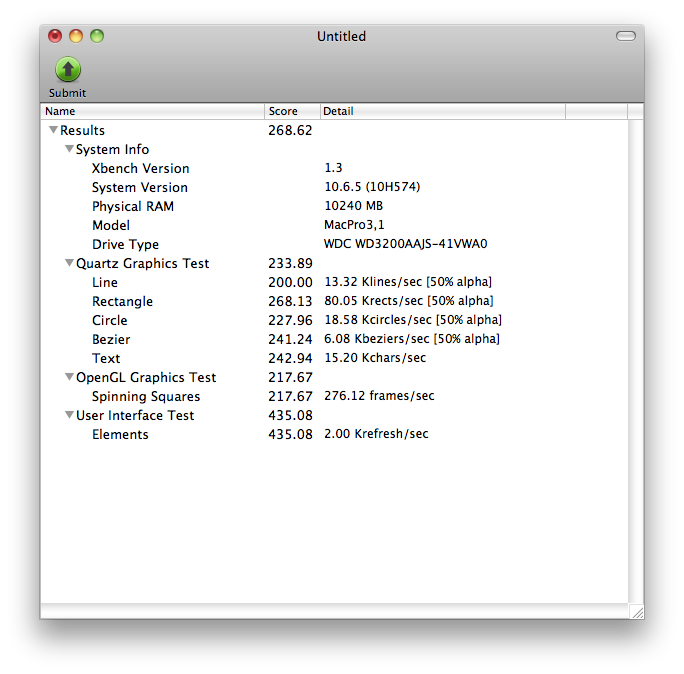

Can someone with a MacPro 2008/2009 post the Xbench results of the Radeon 5870? How does the card perform in the finder versus the stock card? (snappier?)
http://www.xbench.com/
Anyway, the Cinebench results were disappointing.
TIA
Xbench results attached.
The Finder doesn't seem to be any smoother than the 3870 I had in the machine. My apps stack in the Dock (set up as Grid format) also doesn't seem to be smoother than the 3870, which was already very smooth. However, I do remember that the 3870 was much smoother in displaying the apps stack than the original stock 2600XT.

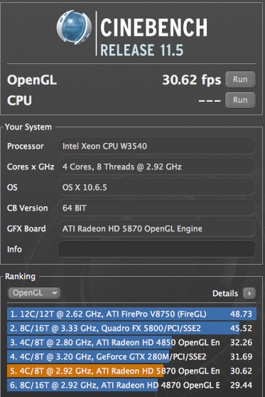

Also ran CineBench for those interested on my 2009 Quad. 30.62fps.
