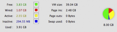

Luke from iFixit.com was kind enough to test out a new NVIDIA-based MacBook Pro with 8GB of RAM (two 4GB chips) to see if the earlier reports were true. NVIDIA representatives had stated that the new chipsets used in the MacBook and MacBook Pro could support up to 8GB of RAM. Previous generation MacBook Pros could only reliably support up to 4GB of memory.
Preliminary results show that while the new MacBook Pro did recognize the entire 8GB of RAM, during actual usage, the computer appeared to be limited to 4GB:
The machine would hit an invisible wall at 4GB and act like it had run out of memory. It's unclear why this limitation exists, as Mac OS X is able to use more than 4GB on Apple's Mac Pro. As a result, MacBook and MacBook Pro owners should not expect to be able to upgrade to 8GB of RAM at this time.

Interpretation of the Graph
On my MBP, sum of Free+Wired+Active+Inactive =~ Used.
This graph showing different number. And the green, free area is at 3.83G.
And the wired and active region is outside of the "free" 3.8GB area.
So, it's not limited to 4G. But it is not fully make use of 8G (looks like).

Based on the image shown, the article is completely wrong. The OS is clearly seeing 8 GB, but the load on the system is such that only about 1/2 that is currently being used. Until swap goes > 0, this is simply a matter of not throwing enough at the system to get it to work hard. The fact that used and free are both approximately 4 GB is completely coincidental.
