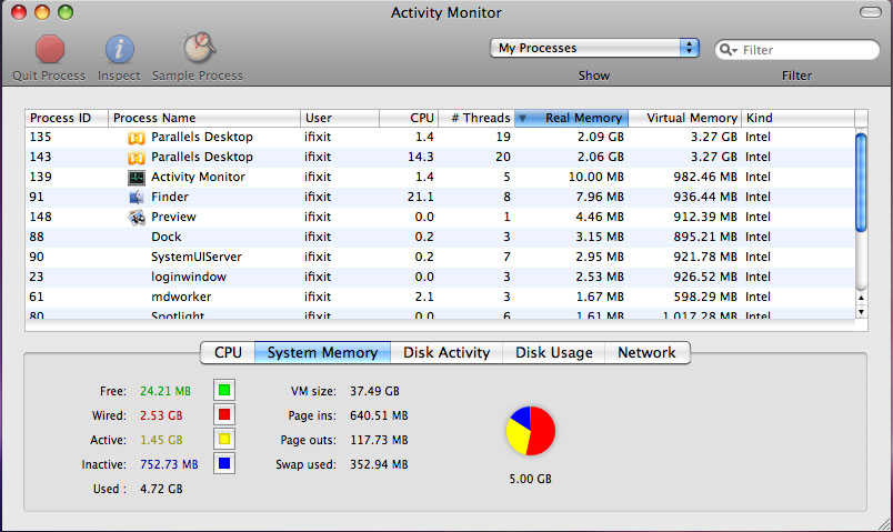

With 5 GB RAM installed, the system appears to perform well. The same test of running two instances of Parallels, each allocated 2 GB of RAM, resulted in the following:
Both instances of Parallels were usable, unlike when we did the same thing with 8 GB of RAM installed.
