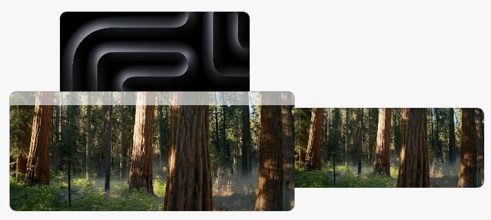

I went as far as purchasing a Studio M2 thinking it would fix my issues but even tho yes, I get 3840x1620 HIDPI in PBP I ran into so much issues that wasn't worth it:
-The color scheme between the two side of the monitors aren't the same, even with the same color profile
-The only resolution on the 11:9 that match the size of 3840x1620 (size as in, I can drag the mouse on the two monitors/arrange at the same height) in 11:9 is 1920x1620.. The issue? It's way lower quality: Why???????? It's the exact same ratio as 22:9 but with just less space!! And even if I was ok to use another one, none of them are high quality either apart the very low resolutions ones
How does that even happen? Do they have a checkbox "ok we will offer this resolution but it will be ugly"? This one is baffling, I cannot make ANY sense of it the resolution is at the correct size, so why is it low quality?
-There is no utility such as FancyZones on Windows that support not having the "display use separate spaces"
These two make it a deal breaker and the worst thing is: They wouldn't happen if there wouldn't be a stupid arbitrarily limitation on the framebuffer, if there was not I could simply push full resolution on one monitor

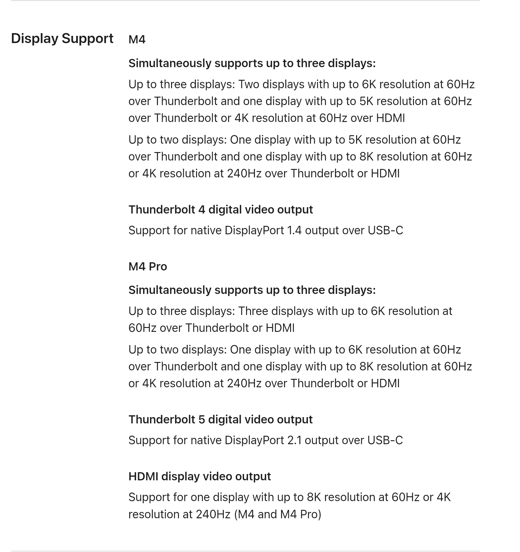

I just noticed that Apple added the following disclaimer to the bottom of the specs page recently:
"Available scaled resolutions for external displays in System Settings > Displays may vary by available system resources and type of connected displays. Scaled resolutions above the macOS default are not reflected in the maximum support listed above."
https://support.apple.com/en-us/102194 (under "Maximum Display Support")
This seems to specifically to address issues/complaints regarding M4 Macs and the dynamic nature of framebuffer size allocation (explained here: https://forums.macrumors.com/threads/5k2k-at-120hz-with-mac-mini-m4.2441289/post-33758270).

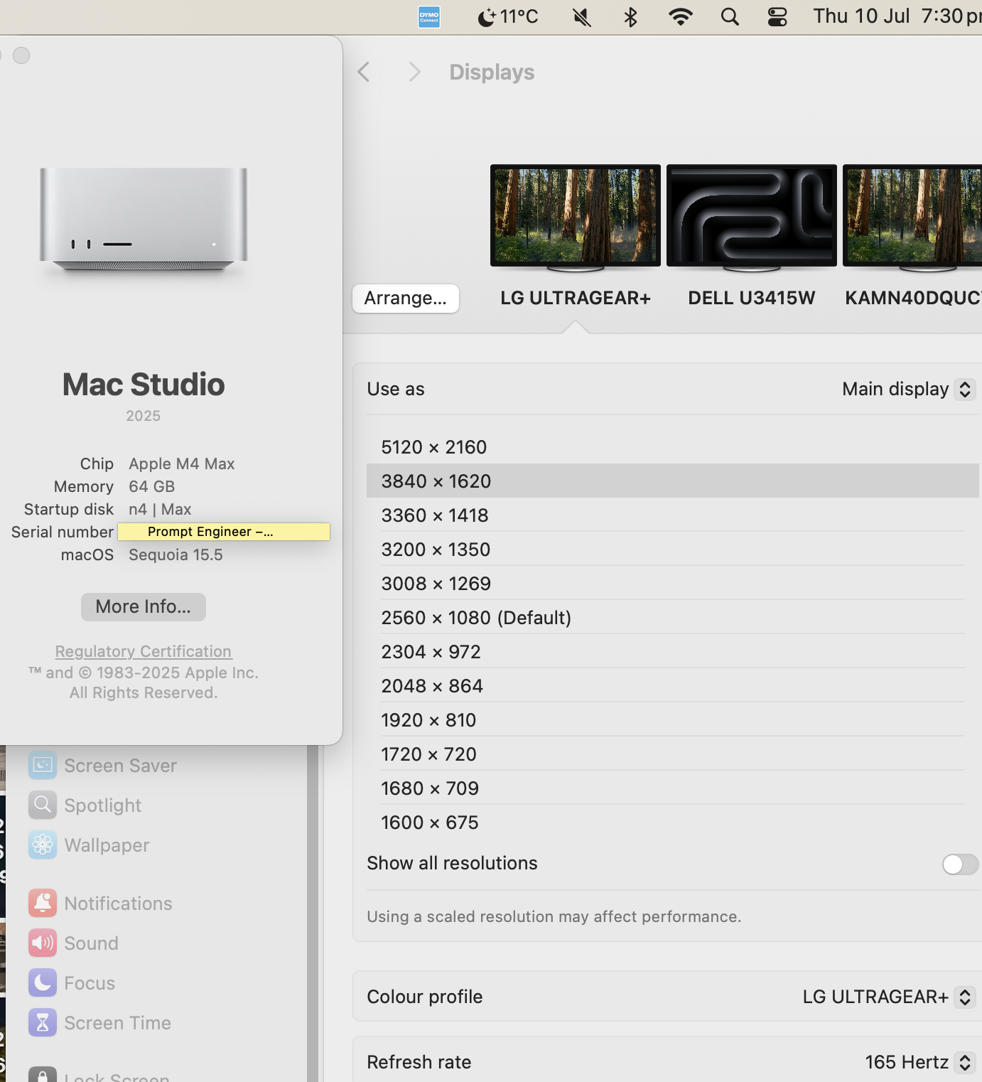

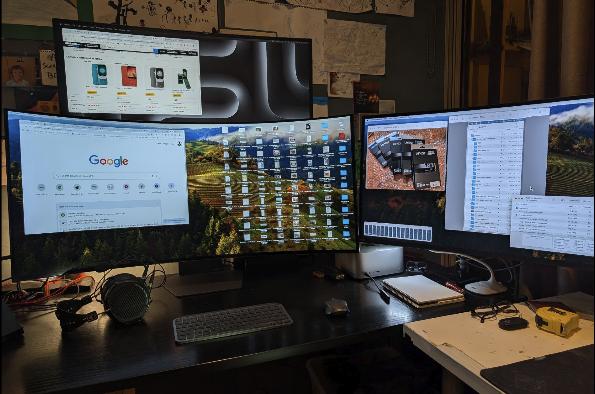

Fine.
I'll take another bullet for the team...

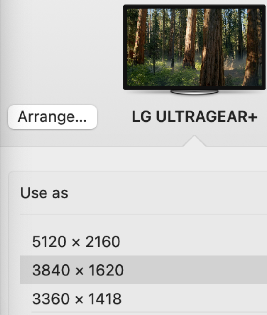

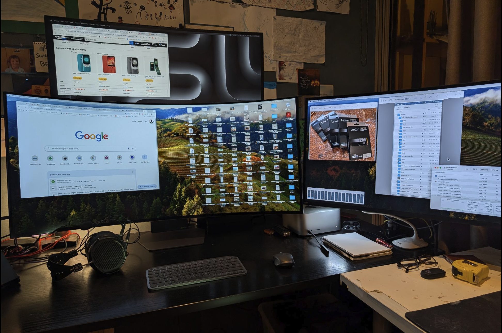

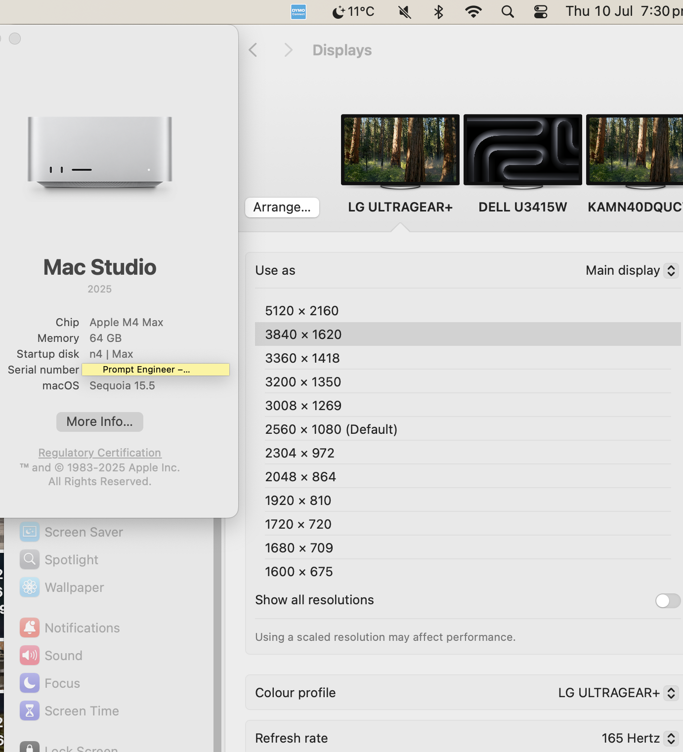

LG 45GS96QB-B 45” Ultragear OLED: aka "GX9".
Using the USB-C (thunderbolt?) cable provided in box, to the thunderbolt port on back of M4 Max Studio.
My odd assortment of monitors, collected over the years.
So, that's two 5k 2k monitors, and one 3440 x 1440.
Do you mean the new 5k2k OLED? Which should be the 45GX950A-B instead? 45GS96QB-B is the 1440 one. But yeah really great news if this is the case, at the moment it is the GOAT ultrawide simply due to the fact of being OLED.
So it proves, that issues with 5k2k 60Hz monitors. If you have 120Hz+ then should have proper scaling options, at least m4 pro/max. :)

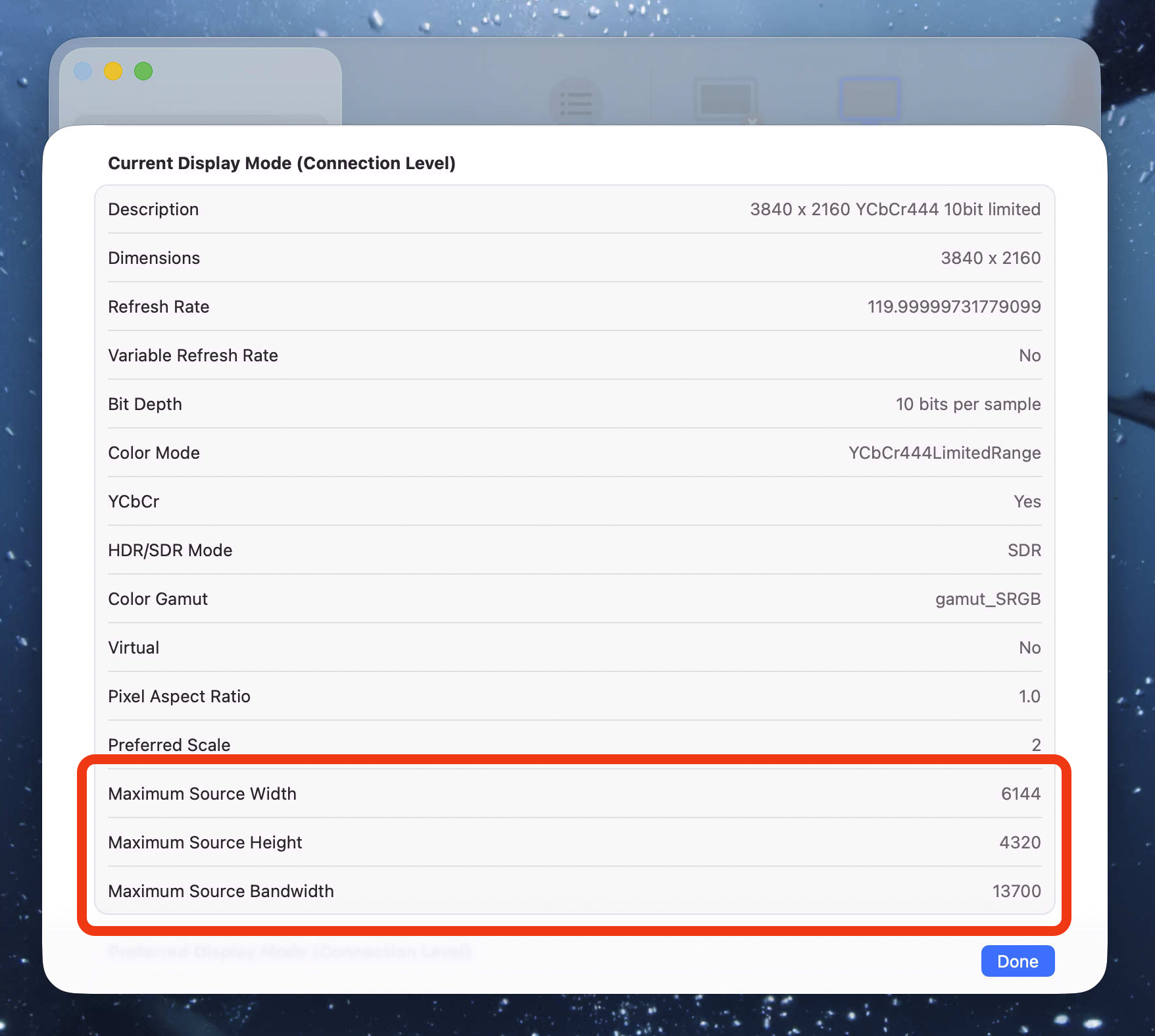

Is this specifically described in the "pipe horizontal limit values 3360 (6270), 3840 (7680)" in BD?
So this perimeter is visible even to 3rd party but you are saying there does not seem to be a way to actively engage one or another?
Yes. There are numerous places in the system where the framebuffer (where the source of the displayed image is stored in the memory) size limits and pixel clock limits are visible (note: the latest internal pre-release version of BetterDisplay will show these under the connection mode as well). This can be extracted from some entries in the I/O registry tree and also there are some APIs that can report this. For example here you see a 4K display, that has 3072px HIDPI (6144px) assigned to it horizontally as max source resolution, all scaled modes have to be inside these width and height limits (there is also a bandwidth limit applied for the source).
The way the display output is produced from the framebuffer is implemented in a very low level, so it's not just that macOS can composite a desktop of any size and then rescale it to the required output (note: this happens with virtual screens, that's why the size limitation does not affect those - but virtual screens obviously do not have to be as efficient and flexible as a native display - which must support all kinds of HDR modes, high refresh rates, VRR etc).
I hope this somewhat clarifies the issue, and why it is that there seem to be no way to get around these limitations with some software hack (at least this is how it looks to me based on all I know).
Not to appear like an LG fanboy, or slipping into advertising territory.... Yes, it is GOAT level.

  • Samsung G70A 4K 144 Hz: 3840x2160 @ 144 Hz w/ HiDPI up to 3008x1692
All these work at the same time. What does not work is single input 7680x2160, it maxes out at 3840x1080 HiDPI scaling which is so stupid. PbP must be used to get around these limitations.
If the M4 Max does not allow for this, then it's a clear step back in ability. M4 Pro might be less capable, which is very non-obvious when Apple's own display support specs are so incredibly vague.
Having tested, the M4 max fall into the same limitations, even worse like I said HiDPI 3840x1620 isn't available on it!
Also for the DP issue: I noticed that I can only get 120hz through the HDMI 2 port, the 1 and 3rd one doesn't allow me for it
So doing 21:9 and 11:9 with the 21:9 part through HDMI 2 and 11:9 through DP adapter I manage to have 120hz on both, not sure why u can’t seem to have that
On the other side: I had to use betterdisplay for the 11:9 split cause macOS wasn’t offering me HiDPI for it
