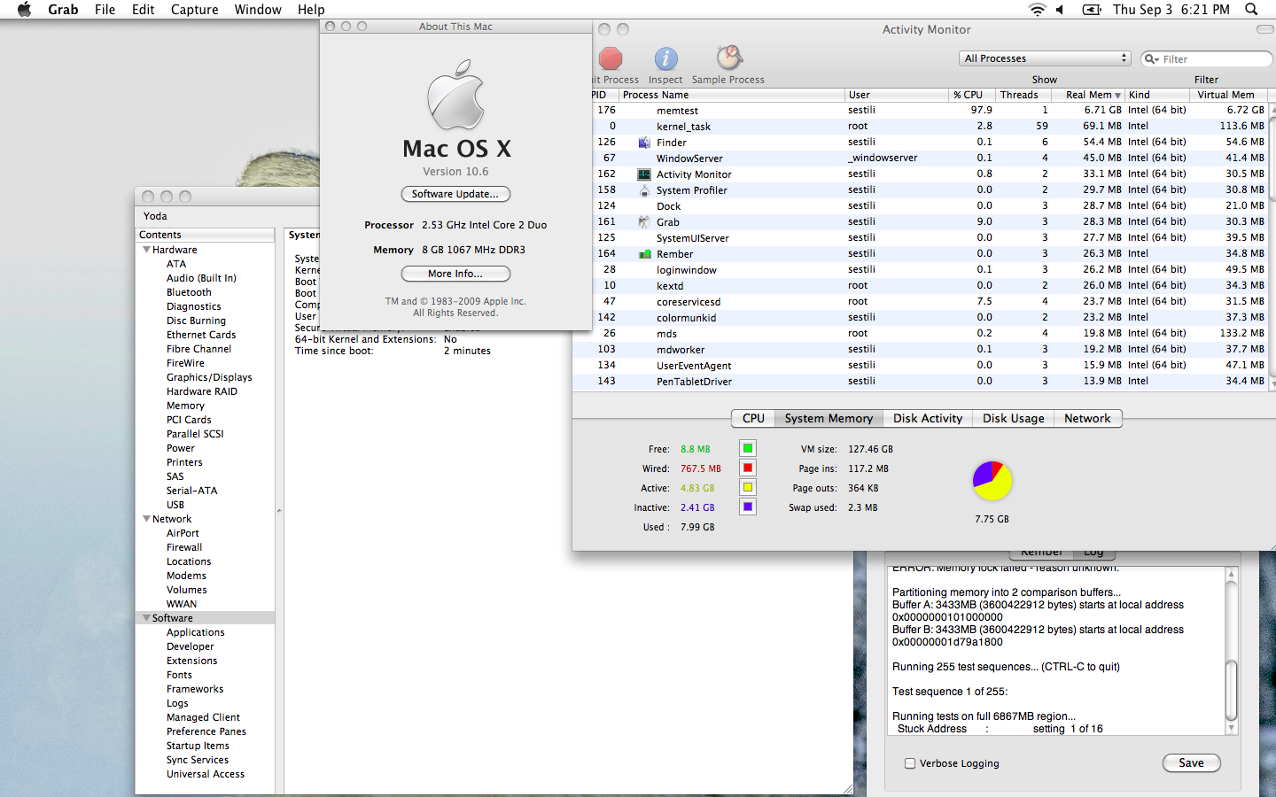

I found a app called rember, http://www.kelleycomputing.net/rember/, which runs memtest which is a app that runs a bunch of test to test and find problems with your memory. Thought I would download and try it out and see what it does. So I ran it and opened activity monitor to see how much ram it was using. Activity Monitor reported 7.98gb of ram being used, memtest using 6.05gb. System stayed very stable and very responsive. Below is a screen capture of Activity Monitor from grab showing 7.98gb ram being used.
I would like more info on piggy app please before I ask someone to send it to me and run it on my system.
Piggy is unnecessary since the Rember program clearly shows that you were able to execute more than the 4GB ram barrier that was originally established. Now the question remains is that, is it because the 64-bit kernel allowed this or does the kernel not matter and it's the firmware?
Apple originally listed 2.4GHz as not possible for 8GB ram. Not sure if that's changed. The 2.53GHz randomly showed up as 8GB capable on Apple's upgrade parts site but there was speculation to which revision it referred to.
I will test it in 32bit mode little later and post my results shortly after. Thanks for everyones help and insight in testing these, glad I can help clear up this.

Actually, the system being slow is just SL being retarded for a vanilla OS and most likely not the 8GB's fault. But the OS didn't crash, so the Late 08 2.53GHz models are supported for 8GB.
However, it works in 32-bit, therefore, the system's firmware allows it.

As for the 8GBs of ram under 32bit mode the system seen it and was able to address it as I showed in previous post, but the system really slowed down to a crawl and was struggling and apps where having a problem opening. The system did not crash but I have a feeling it might have if I did not reboot back into 64bit mode. Even if the system did not crash I could not use the system on a normal basis with that much shakiness and slowdown, nor would anyone want to that needs to run VMWare or Parallels, I do not think it would run good at all even though it could address all 8GB of ram. No I have not tested those 2 programs but from my experience of how really slow the system became it would think it would be a bad user experience, if it ran at all or if it didn't crash the system. I was having trouble even coming on to this forum and posting my test results under 32bit mode, I rebooted into 64bit mode and posted.

We currently only find that the unit is stable with 6GB of RAM in the unit. The issue that that person will run into is when he tries to address the whole 8GB of RAM....it is not stable. 6GB is the max that unit will support and be stable.
