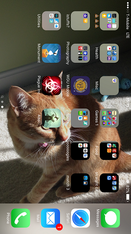

Just tried it and I got the same thing - told me I needed to restart to apply it, I hit okay, then the screen went black until I force-rebooted. Happened both times (switching to zoom and then changing it back) No luck on the home screen rotation either, it still sticks until I switch screens or open a folder.
Oh, and I noticed something else - when it's stuck in the wrong layout (i.e. portrait when the phone is in landscape), if I pull up the app switcher and cancel back out to the home screen things get weird. Looks like the background rotates to the correct position, but nothing else does?
Might be a glitch with the perspective/depth effect? I'll try setting it to still later and see what happens.
Edit: Set both my wallpapers to still, nothing changed. Oh well
