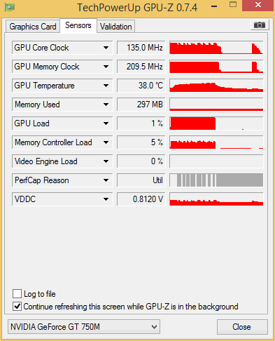

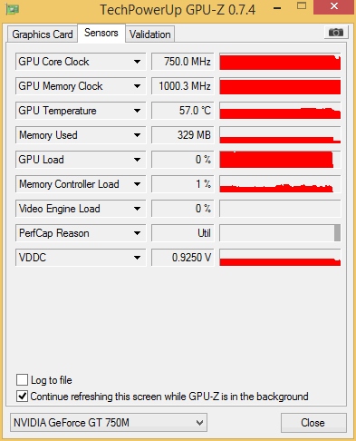

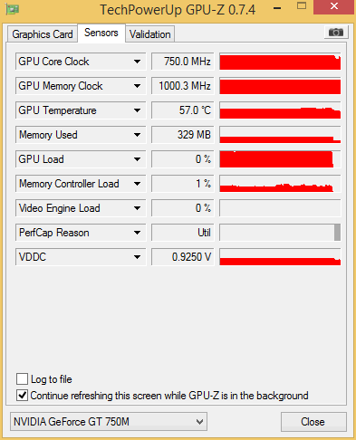

Also, couple of shots from GPUZ during 2 tests. First being Furmark, throttling as normal, with the fans maxed out using the app you suggested before starting.
Second is a good 10-15 min stint in a demanding area of FF14, GPU constantly at 99% load, sitting around 70c mostly, sometimes at 71/72. CPU didnt go over 79c on any cores, likely due to throttlestop. No throttling at all on the GPU at +100MHz core OC / -500MHz mem reduction.
Setting both fans to max definitely helped in regards to keeping temps under control a little better. Not sure how good that will be for the machine in the long run, or how long the temps will stay cool enough to stop the throttling during longer sessions. But its a start 🙂
Sorry the screenshots arent in more depth, don't have MSI afterburner so reporting is basic. But you can still see the fluctuations on furmark, which replicates what I usually see during gameplay.

The easiest way to underclock the CPU is to switch the powerplan to battery savings in Windows. This will basically disable all Turbos and if you go into the powerplan settings and set the max cpu to around 70% it will also effectivly cap it at around 1.6Ghz I think. In many games it will never even bother to run any higher than 800Mhz as speedstep is set to aggresive power savings. It may cause some lag though. You don't need any extra tools.
I don't think that is really needed except when you want fans to run slower because they bother you while playing older not too demanding games.
For the GPU. Just download MSI Afterburner or NvidiaInspector. Afterburner is better imo but Inspector works as a standalone app (You don't need to install anything, just run it).
All it allows you to do is set +/-135Mhz on the GPU core clock. You can change memory clocks too but that won't do much one way or another. Turbo clock rate is what I would like to be able to change but I don't know how.
Only change clocks on PM-State 0, don't touch the others. 0 is for full load, 1 is furmark and medium load, 2, 3 are the very low power states.
Beware though. Furmark doesn't work for testing heat or stability. Some games cause less heat then others at the same clock, so don't automatically assume that heat is fine just because one game runs cool enough.
It also makes sense to activate the higher performance profiles only for the games that need them.
The tools are easy to use as the +/- 135Mhz slider is really all you can make use of and that is a maximum of 14% additional performance. For me that pushed GPU temps only by 3-4 C and at times seemingly not at all.
