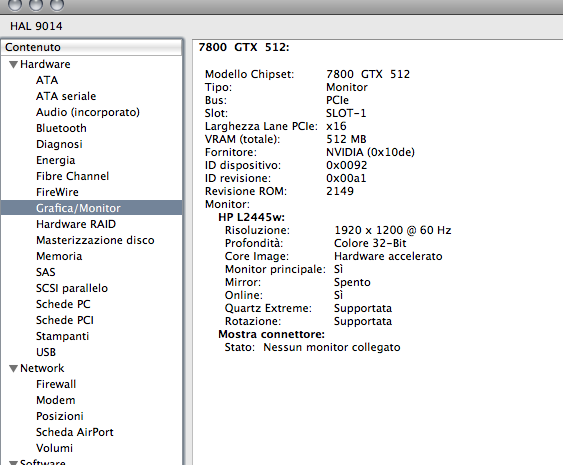

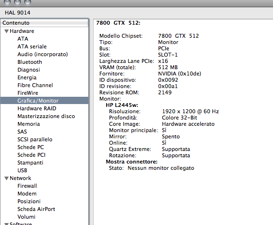

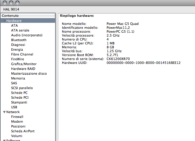

How about some evidence? A screenshot? A video showing you loading "About this Mac"?
ROM posted by pm7300 is FCode PowerPC. Good, working one. The same I have and flashed few cards with it without problems.

Okay, 7800, with two zeroes, not 780... Whew. I misread it the first time and thought you were talking about a current-gen card.
Still, great work getting it to work!
