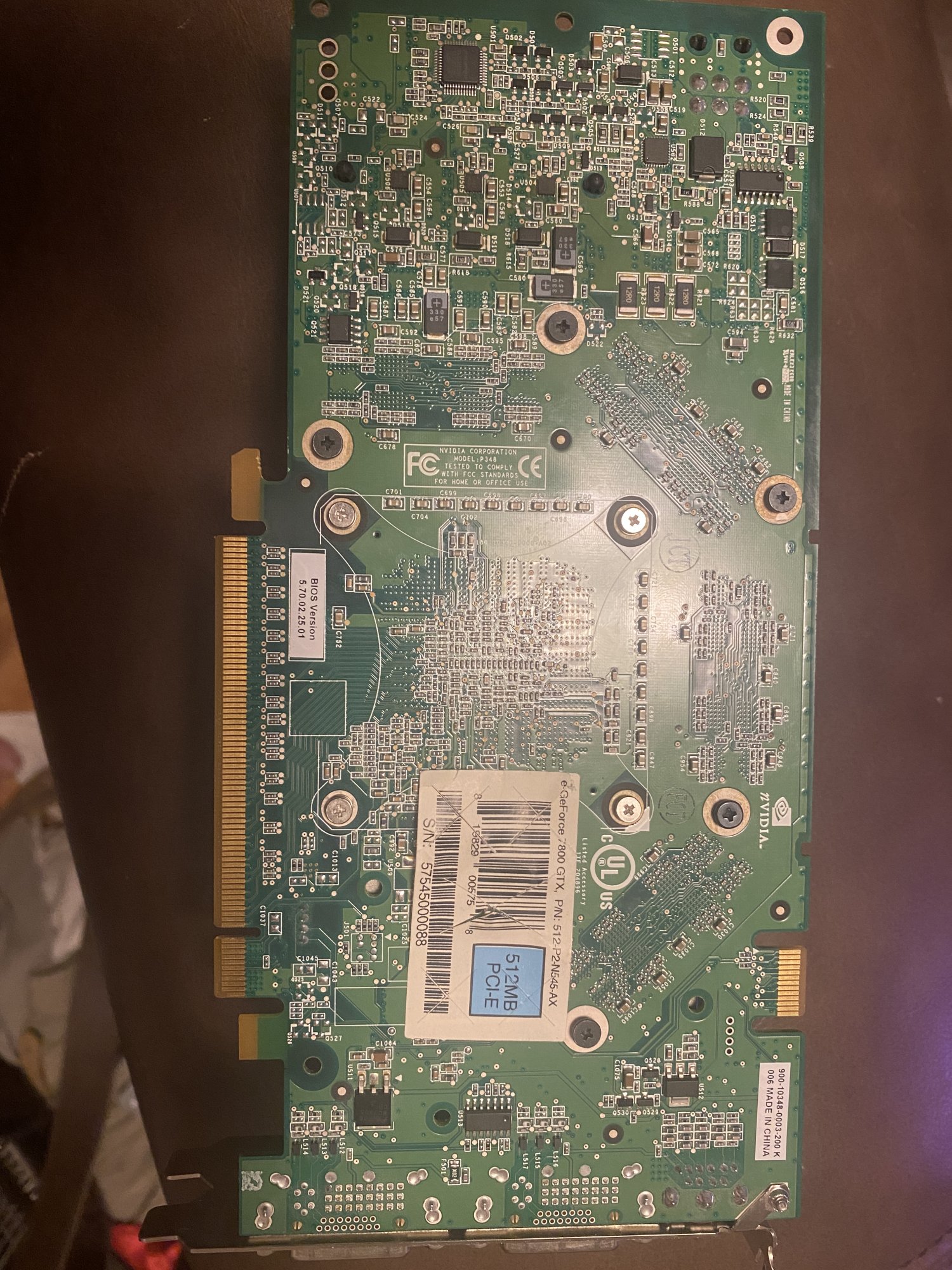

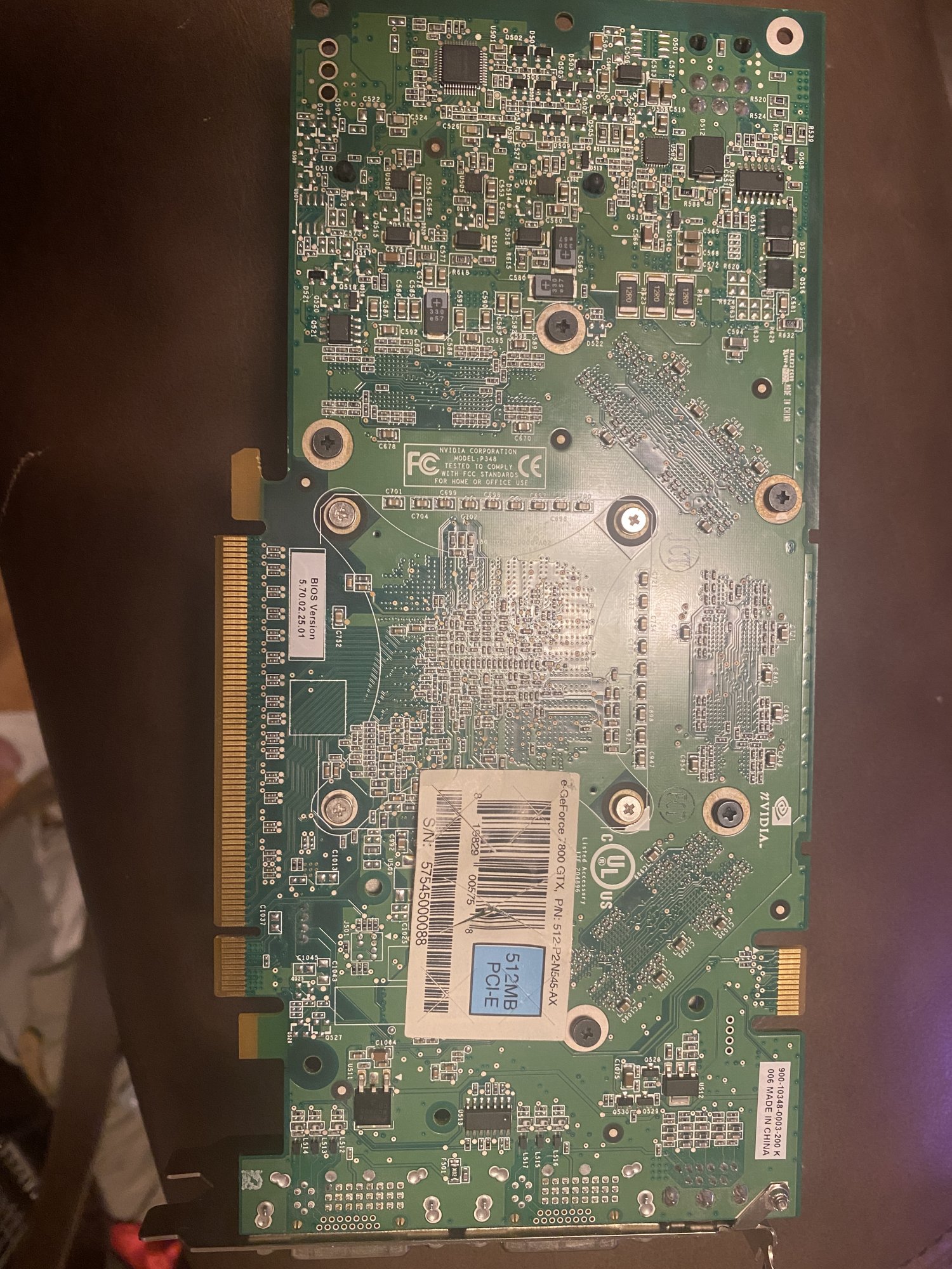

I can't identify which chip on the back is the BIOS chip. My eyes aren't good enough to read the small text. Think you can tell me which one it is?View attachment 1948633
Unfortunately, all of my native PCs are older models without PCIe slots or 'office' computers with only a single 16x slot.
EDIT: Crap. Accidentally double-posted while trying to edit my previous post.

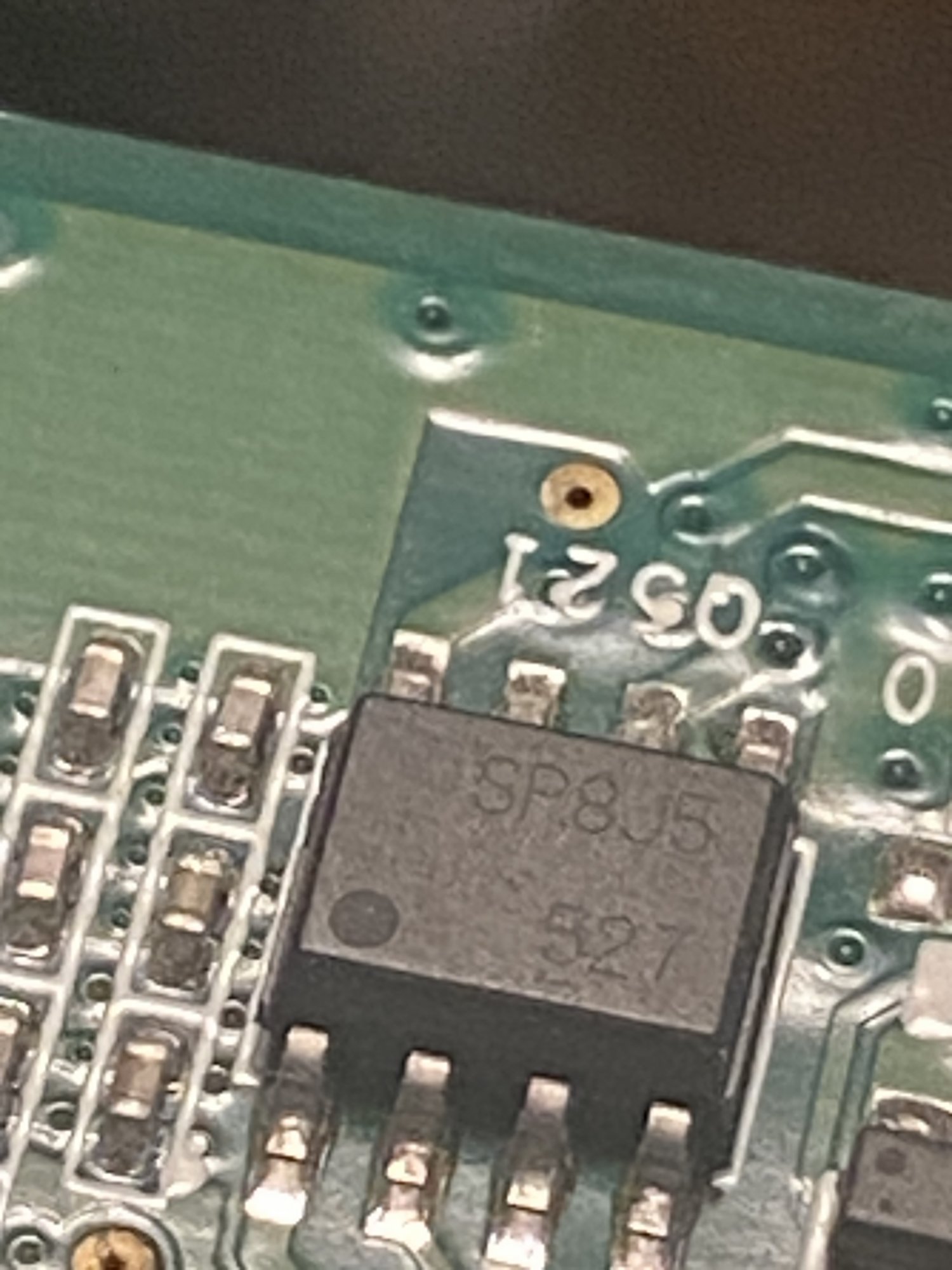

0521 looks like an EEPROM, but beware it could be on the front of the card too, maybe under the HeatSink.
I can't read the markings on the chip @0521, you'll need to find the one with the markings of an EEPROM and Google the markings to ensure you've found it.
SP8J5. It's a MOSFET, which the Q in Q521 indicates (identifies transistors). Not the BIOS chip.

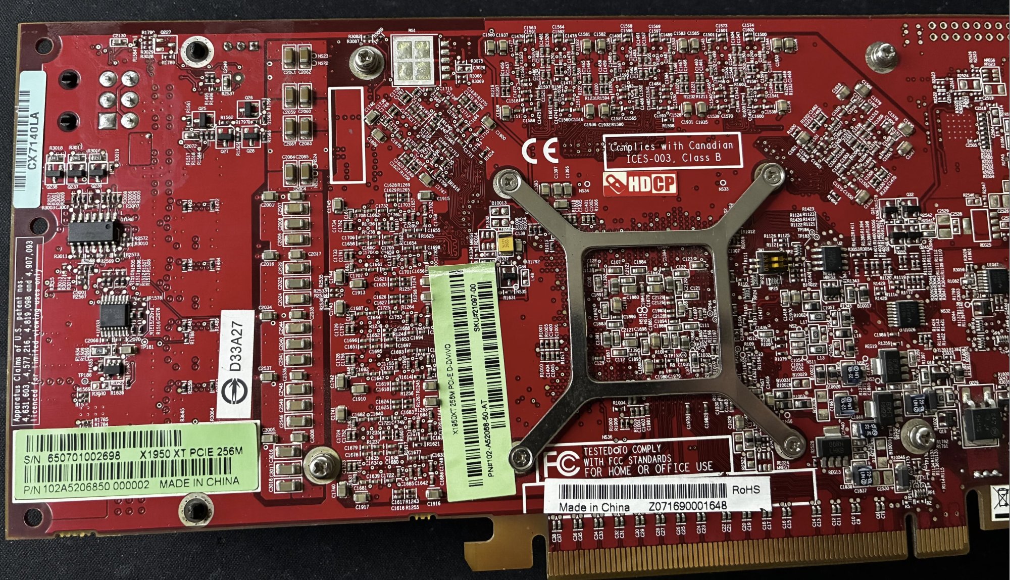

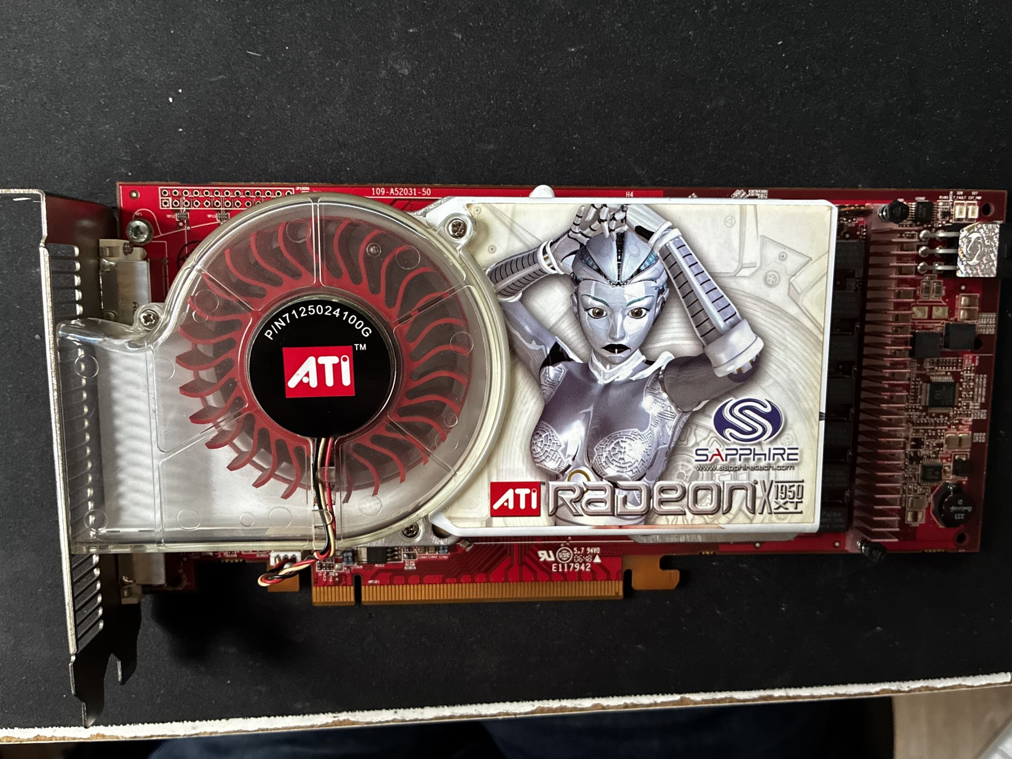

Well, I successfully flashed the X1950XT ROM into a X1950XTX. The result?
See that smaller glitch box? That's the mouse icon, which I can move.
Needless to say, turns out using that ROM on the 512MB version of the card doesn't work, and the myth of claims of it working is false. (With that ROM, anyway.)

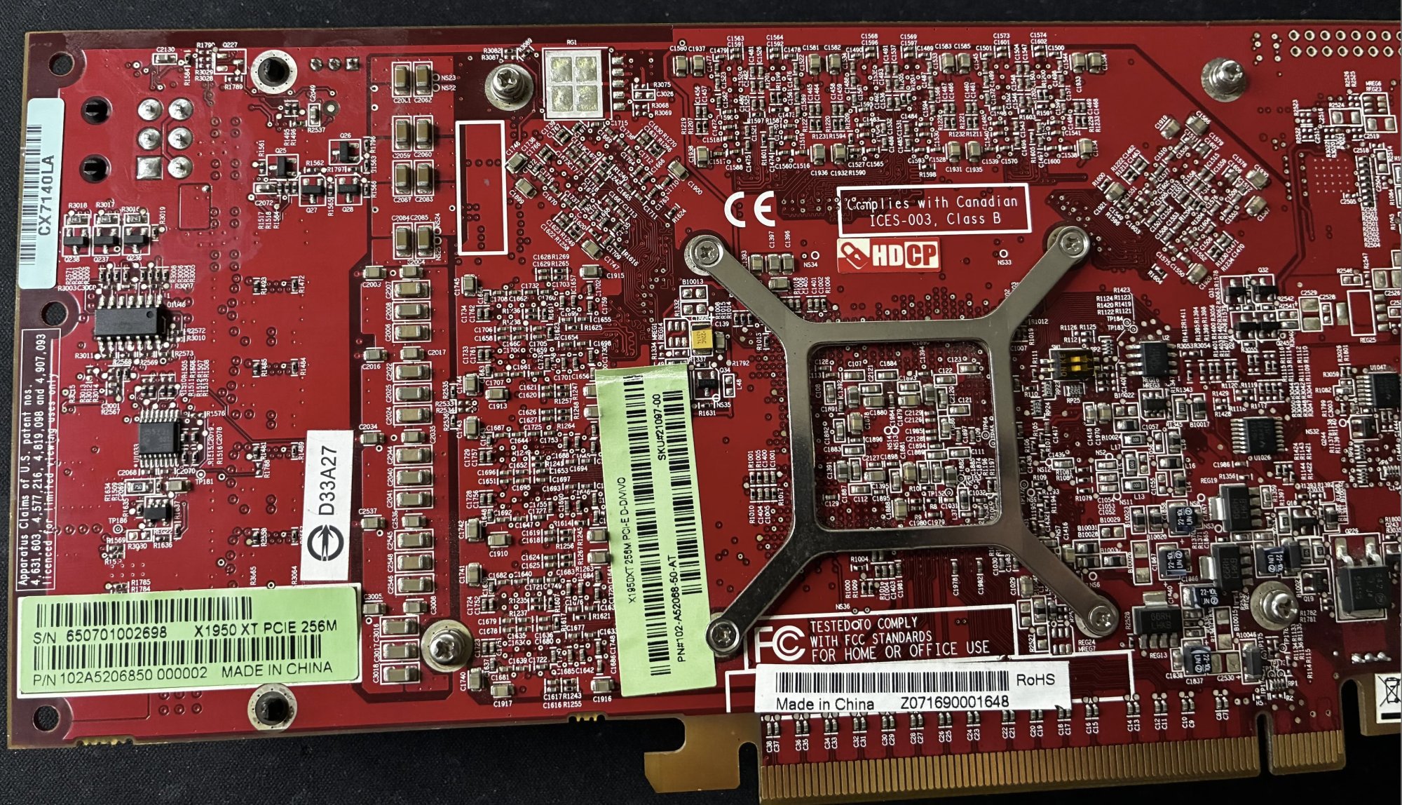

Before flashing, I backed up the original XTX ROM, and turns out it's 128k big. The Mac one we use on the XT is 64k only, though. (Not sure how big the original XT ROM is for PC. Gotta check.) So it fits, but I'm not sure if we are supposed to write another 64k of 0s to avoid leftover garbage and prevent it from interfering (if it does).

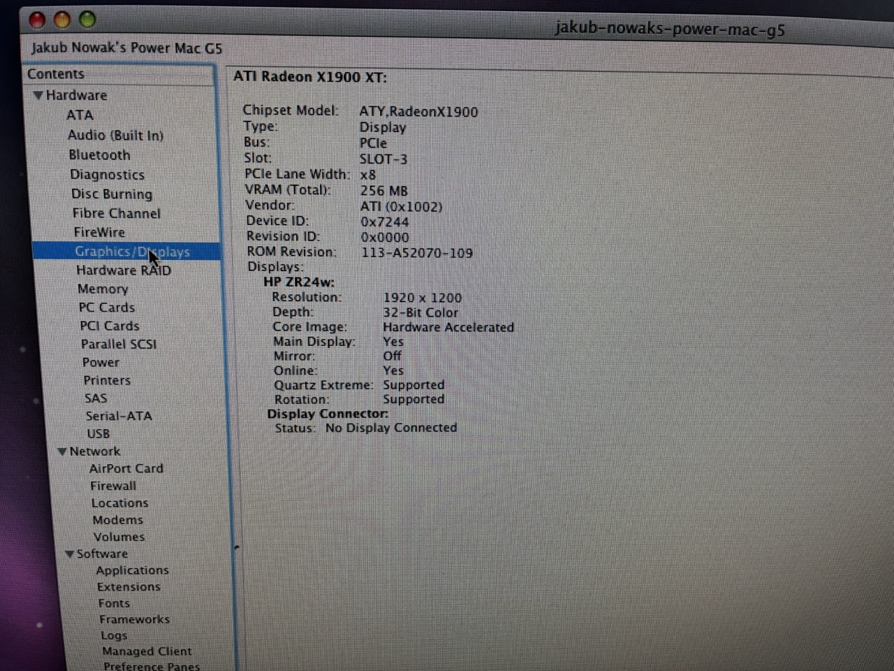

With a second GPU on SLOT-3, I could boot normally and see the XTX (as X1900) and all, so I know the flashing itself worked. 256MB and all.
But this ROM has to be modified beforehand. At first, we knew that was a requirement for the VRAM to be fully used. But now, we see it's also a requirement for the card itself to work properly at all.

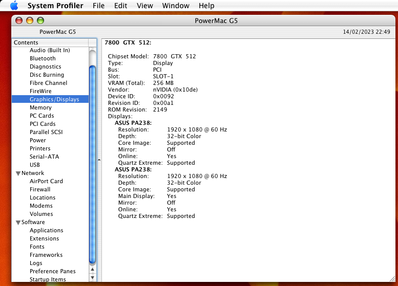

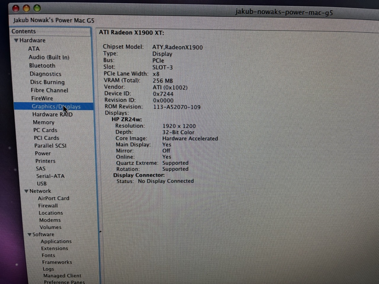

Hey, new user but been following these posts for a little while. I've flashed my 7800 GTX with the rom pm7300 uploaded and it nearly worked as my G5 posted and had a display working but sadly with serious artificating/corruption and then kernel panics. I've modified his rom use the timings of my Leadtek card and it's a solid machine now. The only downside is that it appears to only have 256MB VRAM, but what the hell it's stable for me. In the spirit of this site, I thought I'd upload this in the hope that it helps someone.
I appreciate that I'm an unknown user, so in an attempt to be as transparent, I've included my original VBIOS, an image of the diff (between pm7300's rom and mine) which shows most of the changes, but please do check for yourselves. Of course who could forget, the obligatory system profiler screenshot.
Enjoy!

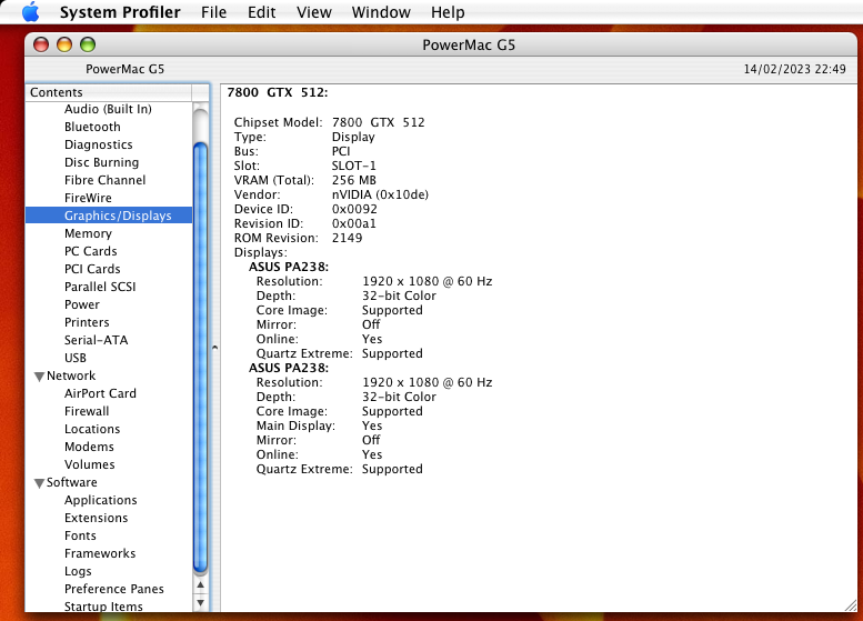

Enjoy!
You did not copy over the nvstrap from the PC VBios to your Mac FCODE ROM.
If you want all 512MB you are going to need to do that.

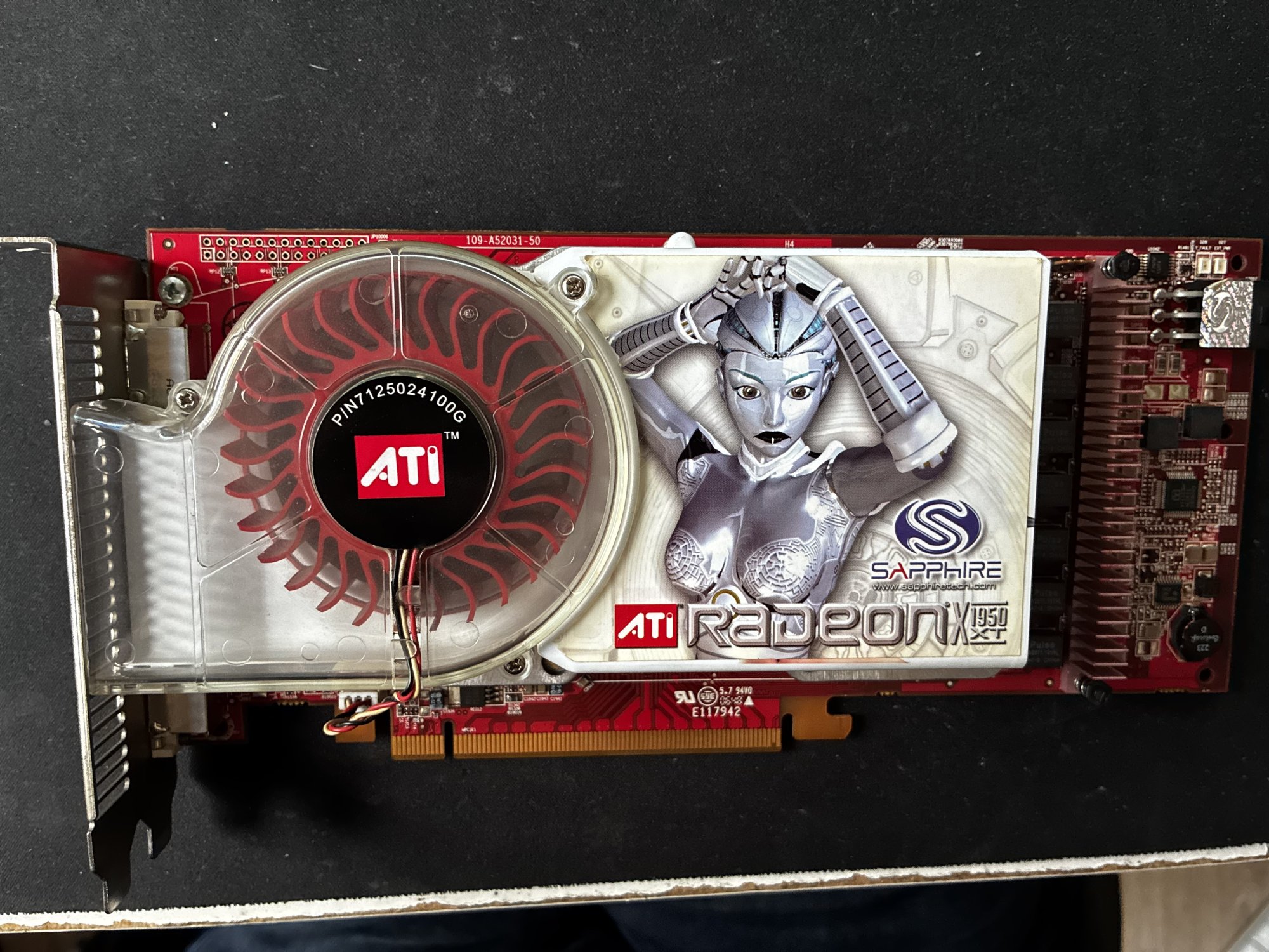

I run freedos, successfully flashed x1950 xt with this one, on first shot: https://forums.macrumors.com/threads/need-help-flashing-a-radeon-x1950-xt.2192094/post-30671833
The problem is the card doesnt wake up on first pcie slot in my quad - no chime. When I try second slot it works, boots up. I think I must be doing something wrong. Second slot is not satisfactory 🙁
Can you help me?
PS: There's one more detail. For now I'm running the card from external ATX PSU as I'm still waiting for the adapter. It works no problem on second slot though.
PS2: Geforce 6600LE works on first slot
PS3: I heavily tested before the card in windows 7 3dmark 03 05 06 - worked fine
PS4 I flashed on optiplex 9020 i7 4790, gpu - Intel® HD Graphics 4600. Don't have any pci card.
