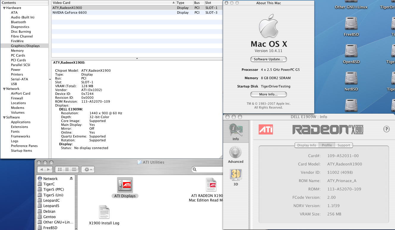

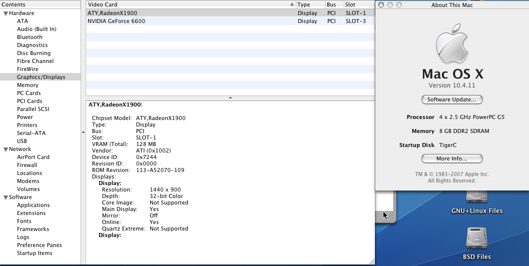

I bring results! Turns out that I didn't even need (yet?) to import Leopard drivers to Tiger to make Tiger fully use the ATI X1950 XT 256Mb! Just downloading and installing the driver (for X1900) straight from ATI/AMD worked! Direct download link for every Late 2005 G5: https://www2.ati.com/drivers/MacX1900G5.dmg
Really didn't expect to see results from just this, considering this came out when Tiger was at 10.4.7, which is far from 10.4.11, and that no extra downloads are required for Leopard.

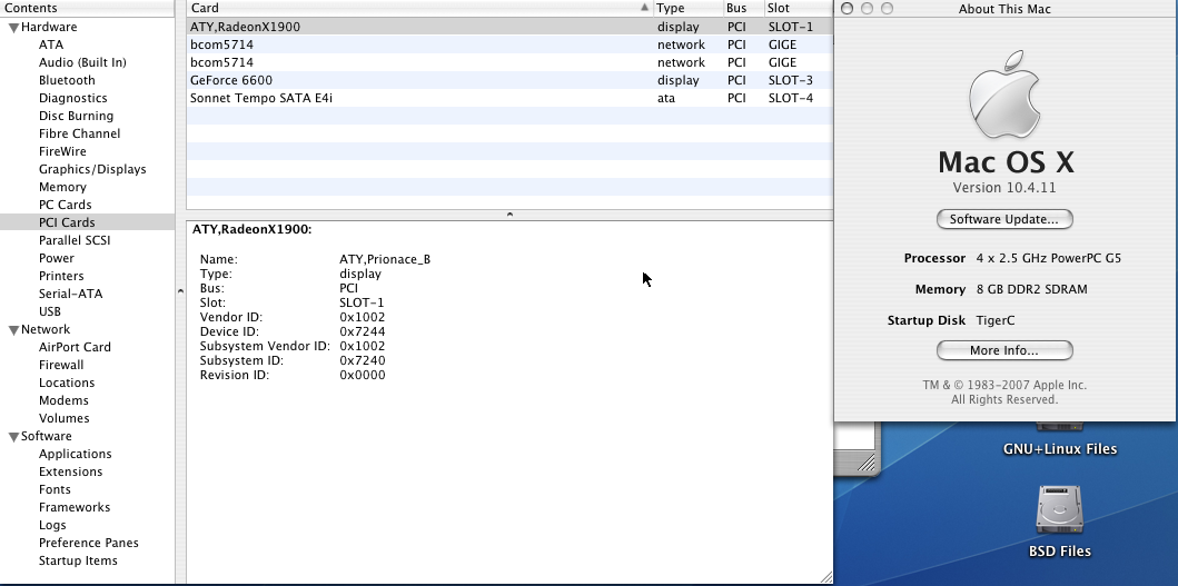

Now the pictures.
Before:
After:
Notice how Core Image and Quartz Extreme went from "Not Supported" to "Supported", and how Rotation, which was missing altogether, is now listed as "Supported".
But the issue? System Profiler still reports 128 MB of VRAM. But the ATI program correctly reports it as 256 MB. Is there any way I can find out which one is correct? Say I run enough games simultaneously on Tiger to fill up the VRAM: where can I check or monitor the VRAM?
Still, this is awesome. I can tell the driver actually works, because without it, the GPU fan is "ignored" (it forever spins super fast or, if you were on Leopard then rebooted straight to driverless Tiger, it's weak), but with the driver installed, it behaves exactly as it does under Leopard.

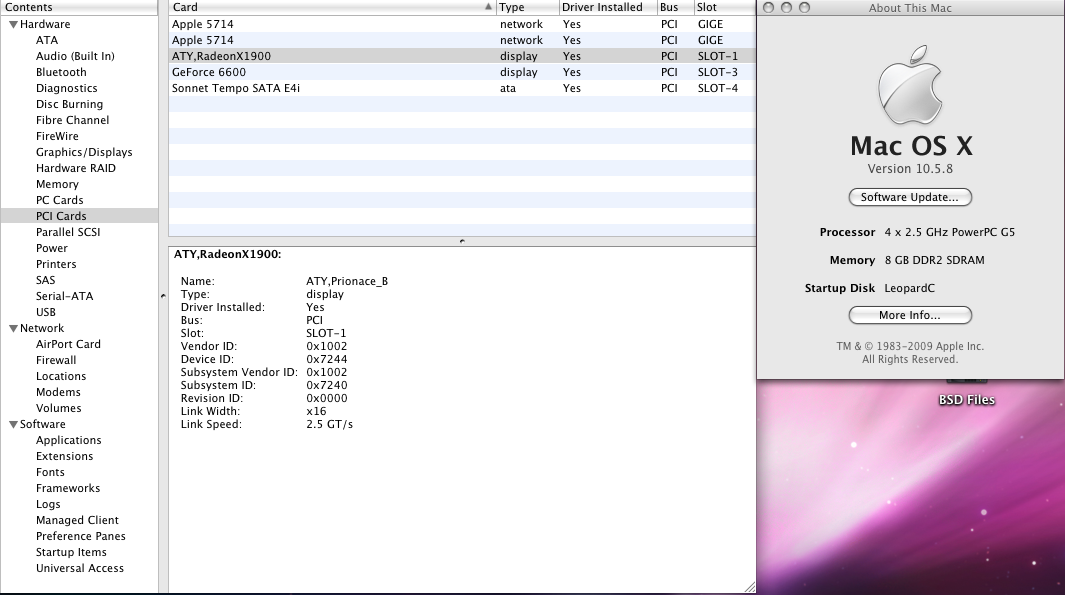

For completion, here's what Leopard shows:
Notice how it says "Hardware Accelerated" instead of "Supported" for Core Image in Leopard, but that's just how Leopard and Tiger report support for Core Image regardless of GPU. Nothing more than a change in nomenclature. The Leopard System Profiler reports things in general a bit differently compared to Tiger's. I just personally confirmed this with a stock NVIDIA GeForce 6600 on both Tiger and Leopard to make sure.

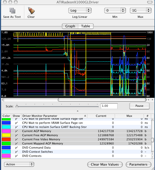

Install Developer Tools and use OpenGL Driver Monitor, it has the features you seek.
Alright, great news! Thanks to DearthnVader's life-saving suggestion, I confirmed the card works PERFECTLY under Tiger, VRAM included. This means although system profiler reports 128MB of VRAM and ATI's program reports 256MB, the latter is not only correct, but also is what is actually used by Tiger. Here is one piece of evidence (look at the "Current Free Video Memory" line):
Tiger:
Leopard:
GPU benchmarking from XBench also gave it the exact same score under both systems, if that's worth anything.

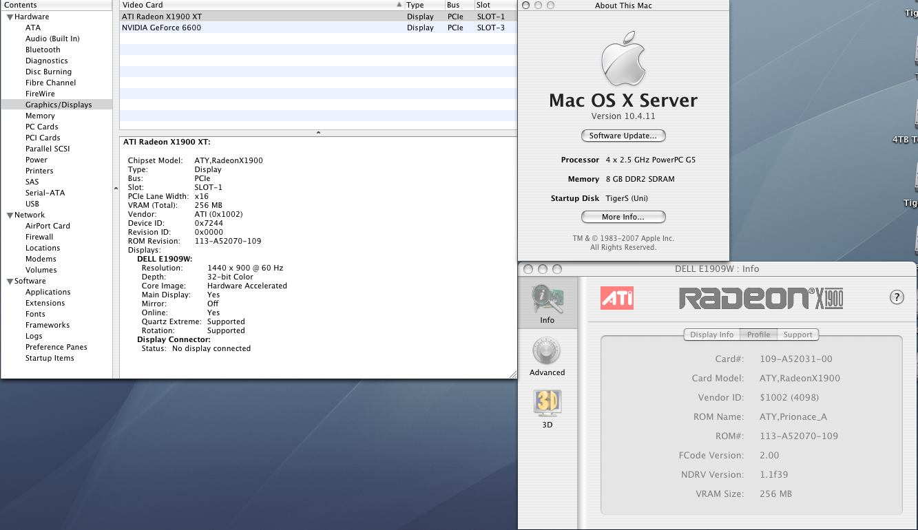

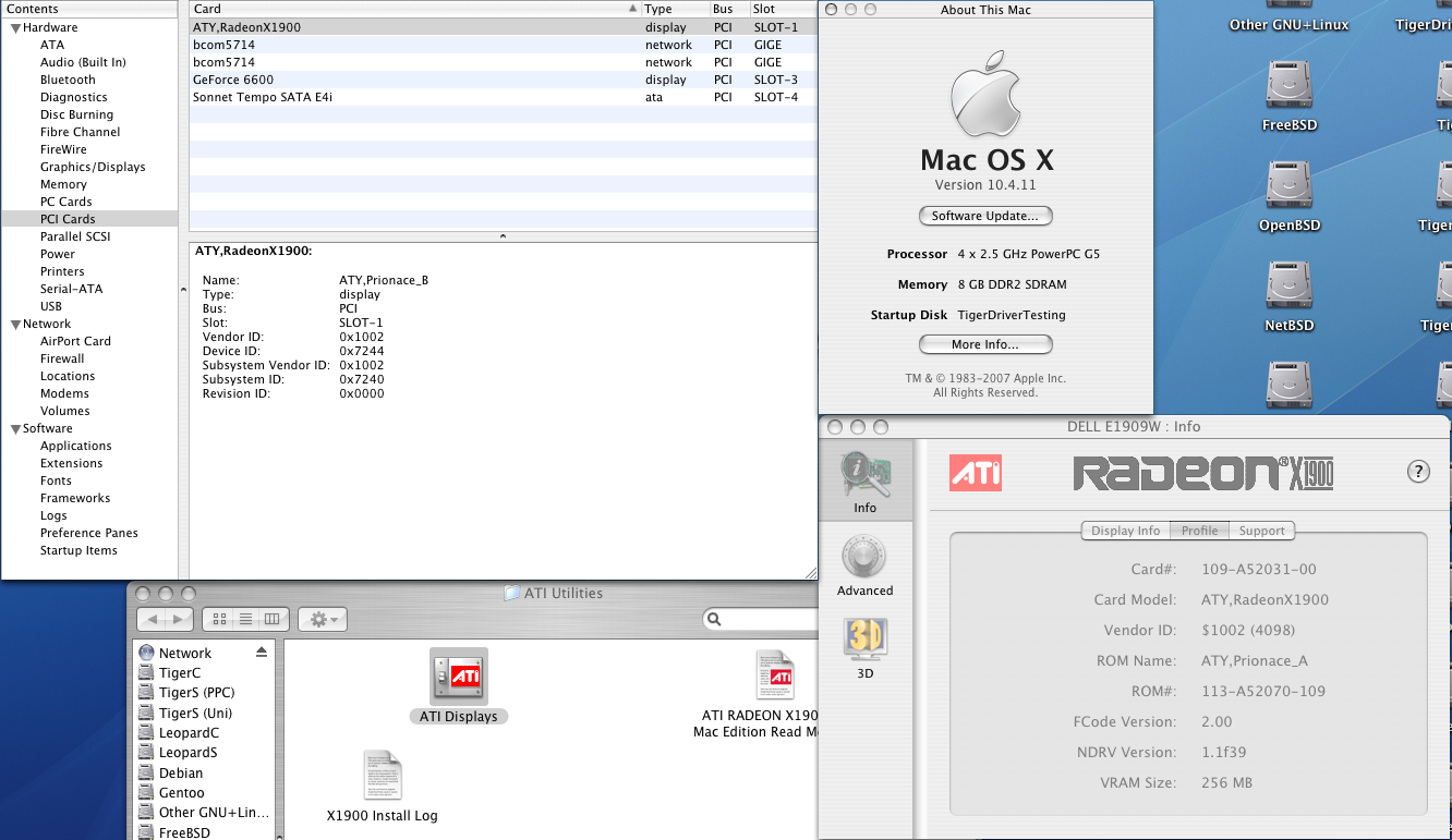

I installed the driver on 10.4.11 Tiger, Server Tiger PowerPC and Server Tiger Universal. It works flawlessly in all 3 PowerPC-compatible versions.
But there was an unexpected catch: with specifically Server Tiger Universal, the system gets a kernel panic late during boot. Which means I couldn't get to a point I could install the driver. So for that end, I had to unplug the X1950XT, turn the G5 on, and only then could I install the driver. (I used the stock GeForce 6600.)

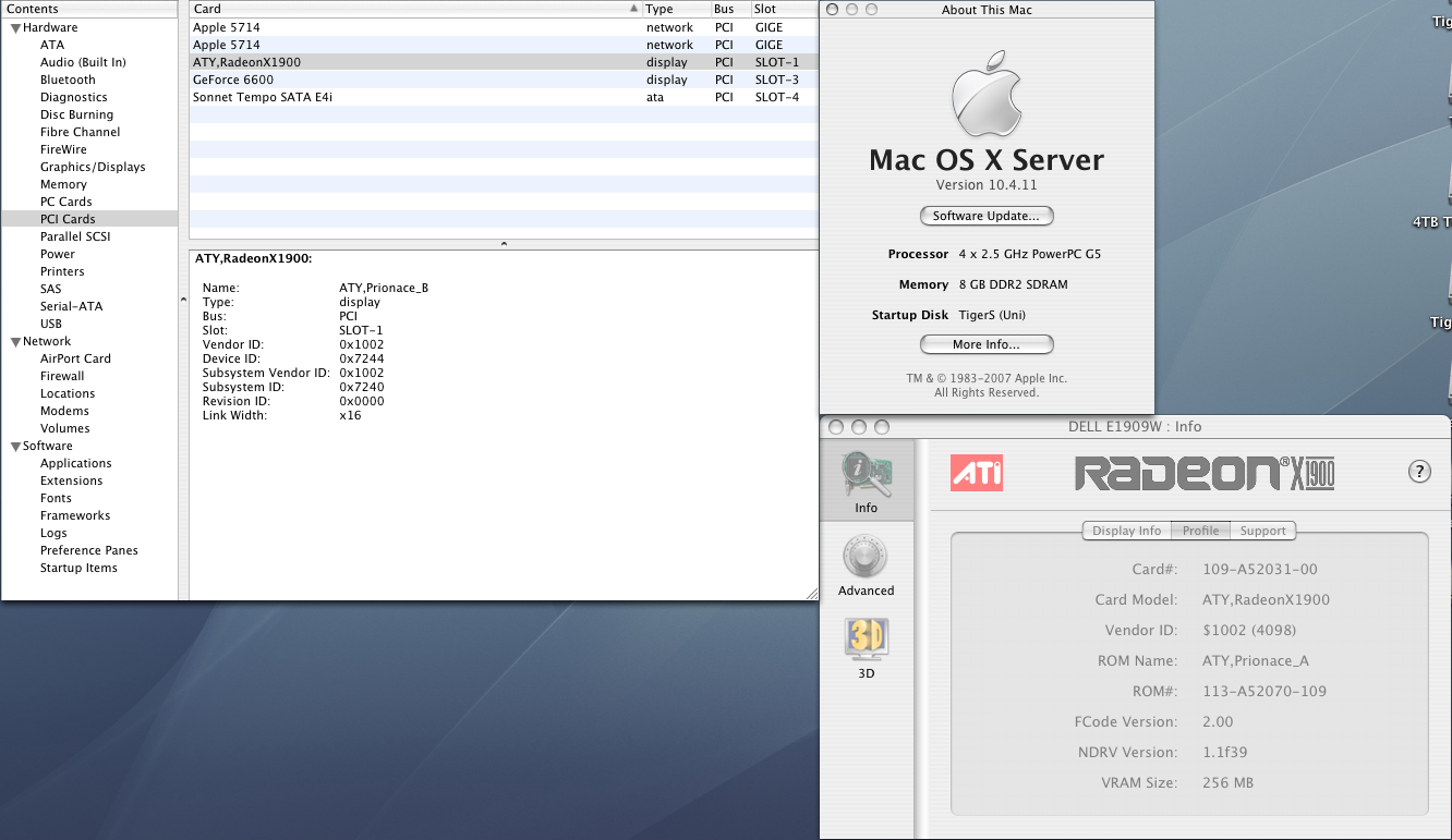

With the driver installed, I put the X1950XT back in, and boom! It works!

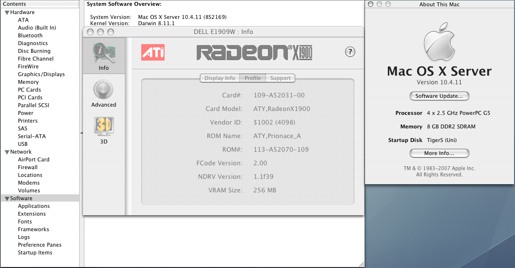

But then I noticed something VERY interesting. Have a look:
The system is reported to have 256MB VRAM even in the system profiler! What the?! And what's more, looks how it says "Hardware Accelerated" for Core Image! In other words, this version of the system profiler is behaving just like Leopard's! Although it's just a visual difference in nomenclature, it's as if the Server Universal version of Tiger is slightly closer to Leopard than Server PowerPC and "Client" PowerPC are!
I didn't expect that at all. Kinda really cool.
For completion, here's the PCI Cards page:
And the system version code/number:

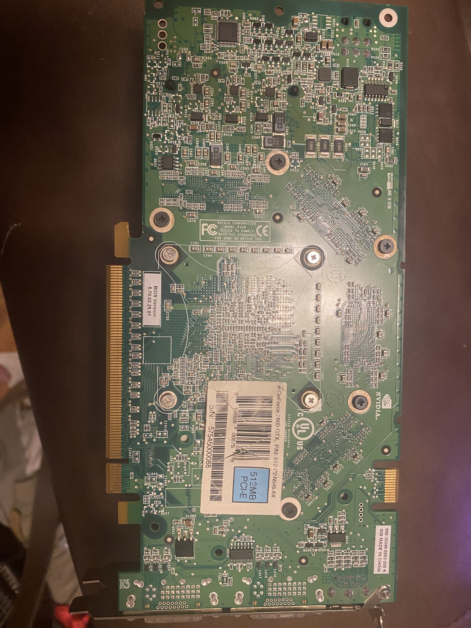

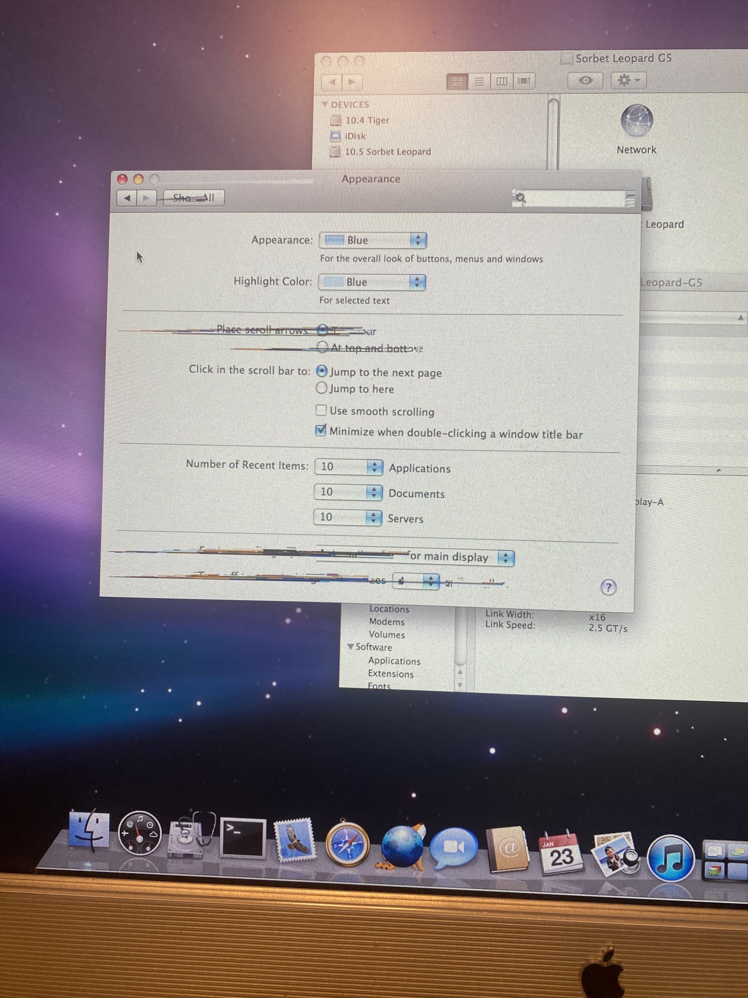

So I flashed a 7800 gtx 512 with the ROM from post #14, and it 'works' but I have graphical corruption. I dumped the original ROM before flashing, but I can't boot my flashing computer with the now Mac compatible 7800GTX in it - I just get beeps on boot. How do I reverse this?
Lift the ground leg of the EEPROM and install a simple switch. Boot the PC and make the switch, then run NVFLASH to restore the PC ROM.
I can't identify which chip on the back is the BIOS chip. My eyes aren't good enough to read the small text. Think you can tell me which one it is?
In the past i have used a second graphic card for flashing the "mac cards".
