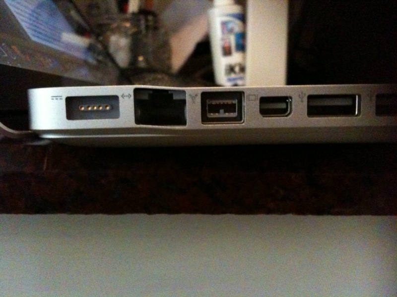

Before my new case of Macbook Pro unibody had a dent. Is there a solution that would hopefully not cost anything without creating further damage. Eg bending it back. Is it safe?
I wouldn't attempt any repair to the case without removing the logic board, as you could damage the connectors (which are mounted on the board).
Since the top case is a single piece, there's not much else you can do except have it replaced.
I'd take the back off, get two strips of soft wood, ideally flat and not too thick then place the whole lot in a vice and slowly tighten it. The objective isn't to crush the uMBP, you wanna straighten it.
You might like to cut a supporting groove in one of the pieces as the understand of the uMBP isn't completely flat.
yup, do not hammer the wood, use a vice or something that will slowly bring its shape back.
My MBP 13inch looked almost the same as yours. The damage was in the same place. I sent it to MyService.com in Santa Clara, Ca for repair. As they are near Cupertino they got the part the next day. I sent mine in last Tuesday and received it back at noon on Friday. The top case (the Unibody) was replaced at a cost of $295. They offer round trip next day air. shipping at $79. Check with your insurance company, mine paid for the shipping and repair less $100 deductible. I am very happy with the workmanship.

It happens on the 15" if you pick up the MBP with one hand holding it at that edge where it is weakened because of the ethernet jack and the speaker holes on top.
What? Those aren't from holding the laptop too hard, there from dropping it. You are correct that that's the weak spot in the design.
Yeah that Ethernet port is a major weakspot. Mine was bent at the optical drive side. The section of the case below the slit was bent horizontally into the optical drive by a few mm. I was able to easily bent it back into place after disassembling it, and there is no sign of impact now.
Aluminum is pretty strong because it doesn't flex much or crack, but it's very soft on impacts, it dents rather easily. Mine fell less than 0.5m in a padded laptop bag, with an Incase sleeve, and it still resulted in a nasty looking dent. I have a feeling that a plastic MacBook case would have done better in that situation, unless it cracked.

i dropped my 17" Macbook pro ($3000.00) inside my 1/2 inch padded bag which was on my shoulder at the time, so it only fell about 2.5 ft. completely warped at the ethernet port due to thinness of aluminum there. Unable to fit ethernet jack into port now, much worse than the pics to start this forum. I will take to Apple to see what they can do. I am very disappointed though, i never carry around my house or anywhere like some dummies. It goes in its protective bag and then i gingerly carry to where i am going. First time i ever dropped it and bam 3 grand down the drain.....nice design apple. Perhaps they should warn anybody who buys one for this price that yeah its thin, but one drop and it will bend/break(as mine has now) at the ethernet port.
