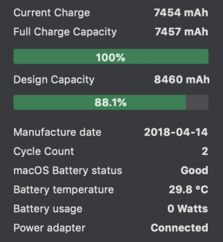

Hi everyone,
I just replaced the battery of my mid-2012 15" MacBook Pro for the first time. After calibrating it (steps I took below), I checked the battery with coconutBattery and It's showing that the design capacity is around 88%-90% after only 1 cycle. This isn't normal, right? I didn't check the battery prior to the first cycle.
I've read that coconutBattery's percentages fluctuate because of error margins, so was just wondering what y'all thought. I don't think it's dropping a bunch per cycle, instead, I think it just came missing the 10% charge like its been already used. I did another cycle and its now at 88.1% as I'm writing this (7457 mAH/8460 mAH). Not too knowledgeable when it comes to batteries and their capacities. I have warranty, so should I return it? I attached an image of the coconutBattery info.

Apple batteries haven't required calibration for many years. Just run on battery whenever you need to and plug it in whenever you can.
It is normal for a new battery to be somewhat above or below 100%, but not that far below. Where did you get the battery? If you got it from someplace other than Apple, all bets are off. If you had it replaced by someone other than Apple, it's not covered by warranty. If Apple replaced it, take it back and let them take care of it.
As others said you did more damage to your battery than anything else, give it a few charge cycles and see how it is by around 10 if it’s no better send it back.

If it's an original battery, then it was most likely laying around in a storage for a while — and these batteries age, even if you don't use them. If its a knock-off unit, well, why are you even wondering?
Yes I plan to use it for a couple more cycles to see how it performs and I'll be returning if it stays bad. As of now, it actually jumped up to 91.1%.
