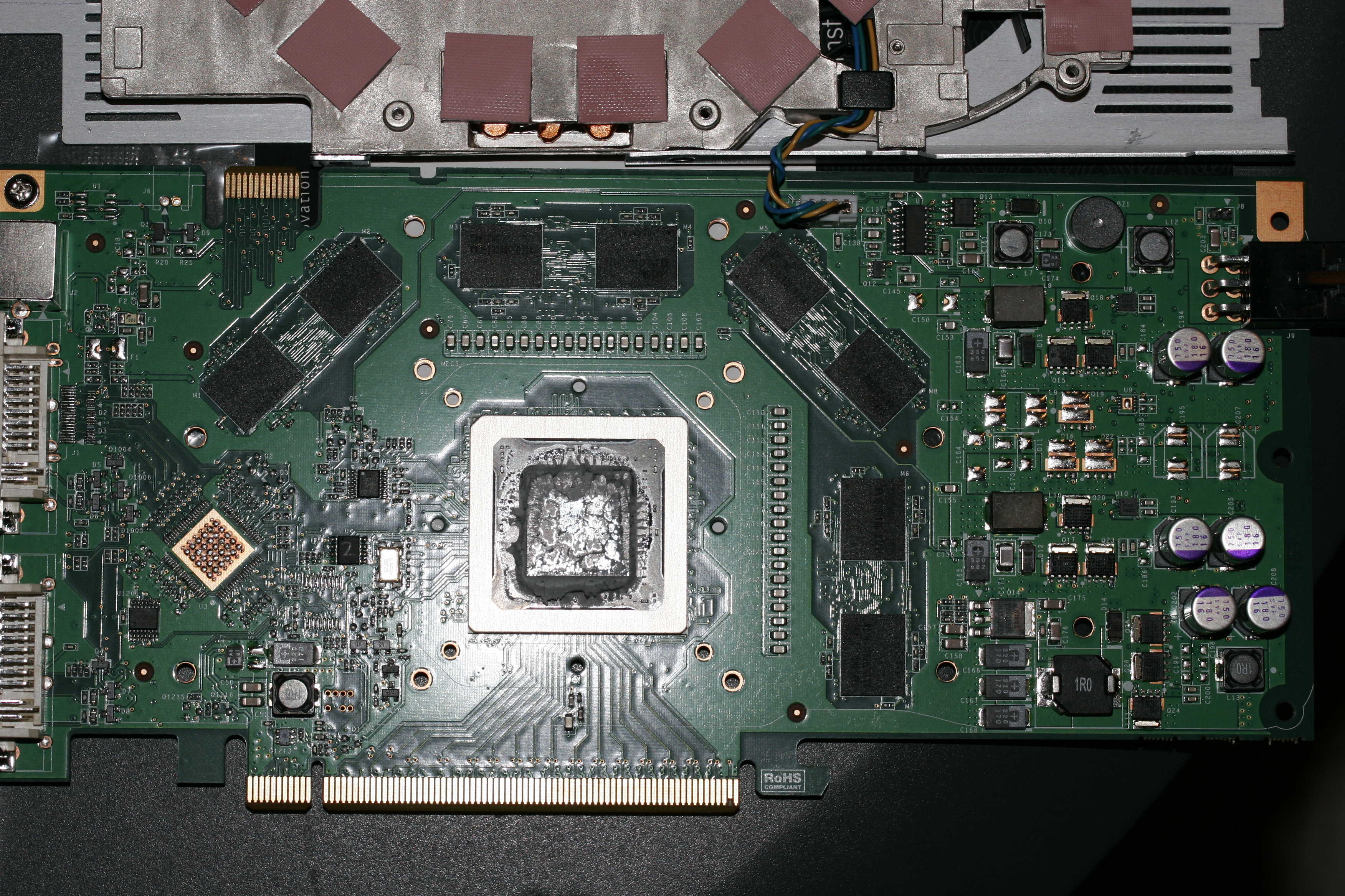

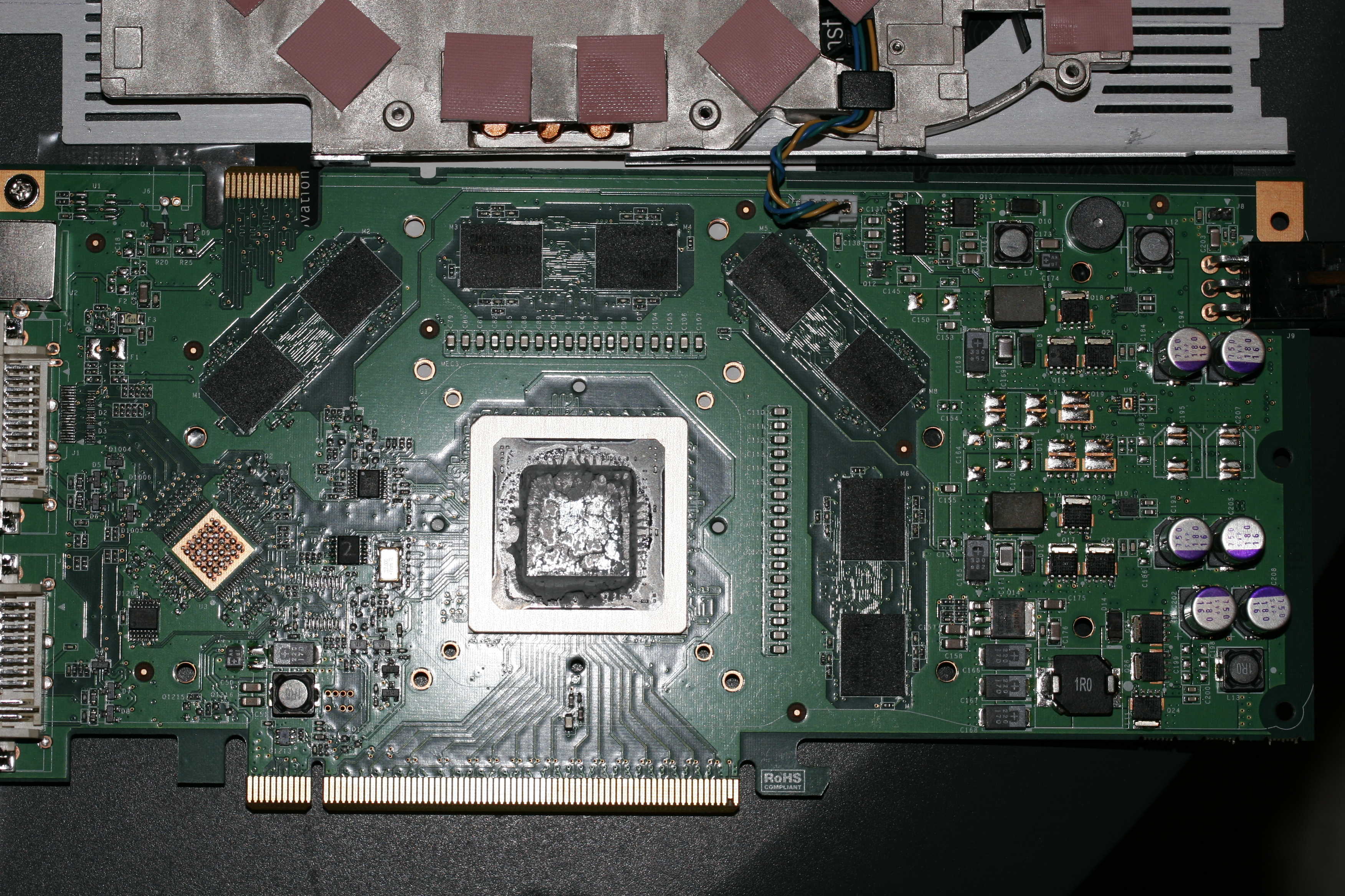

could you please post a Picture of the CARD with the COOLER mounted off ?it is not too much Trouble !
i wann have a look on the PCB Layout !
FRONT SIDE and BACKSIDE !

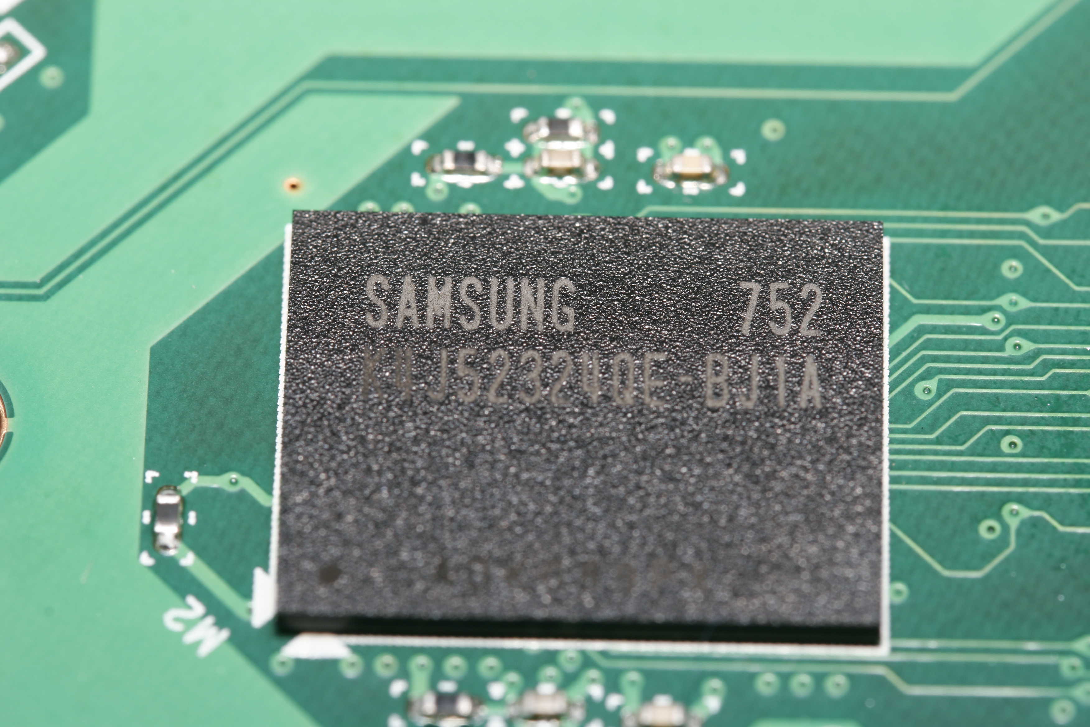

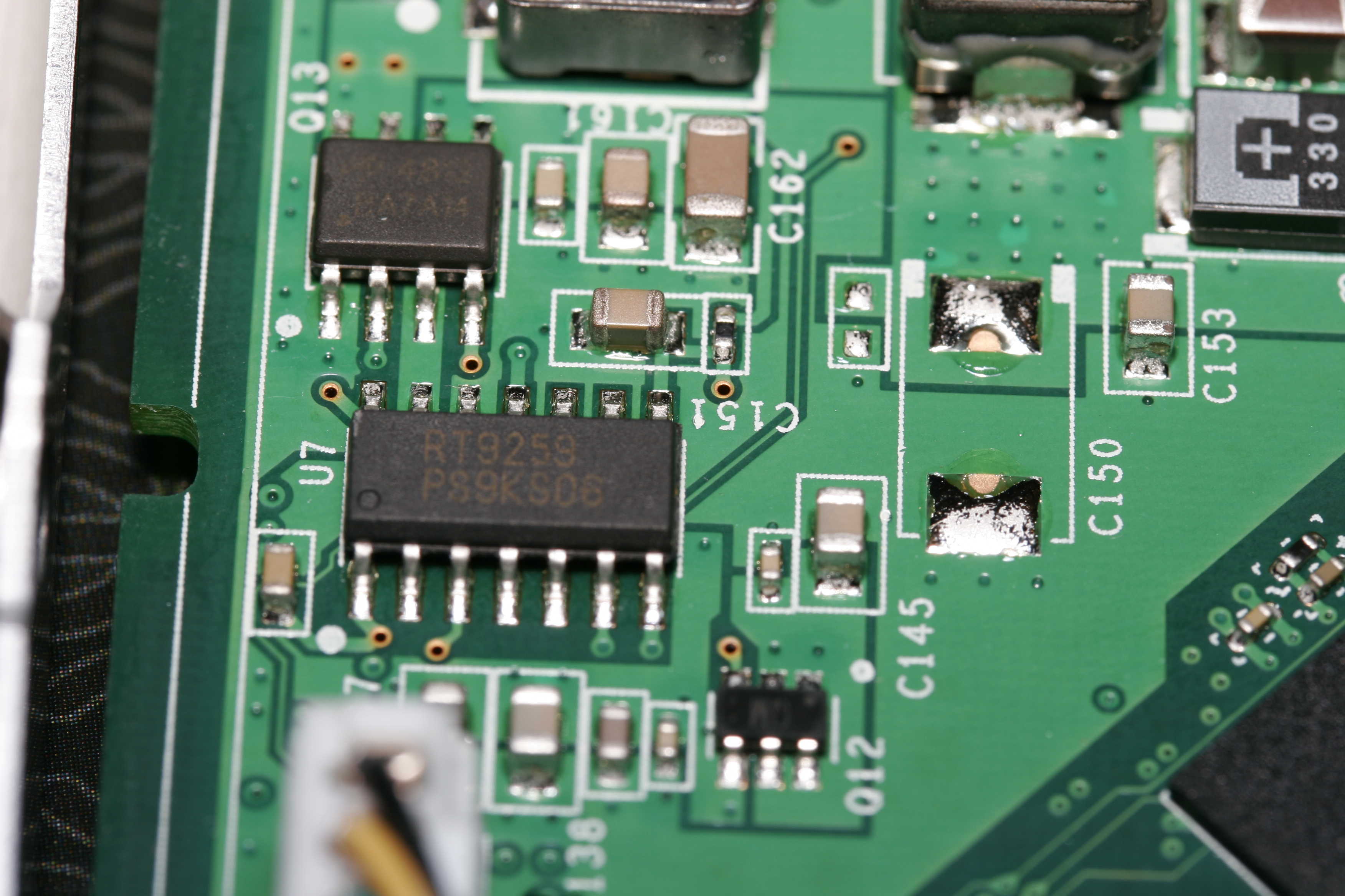

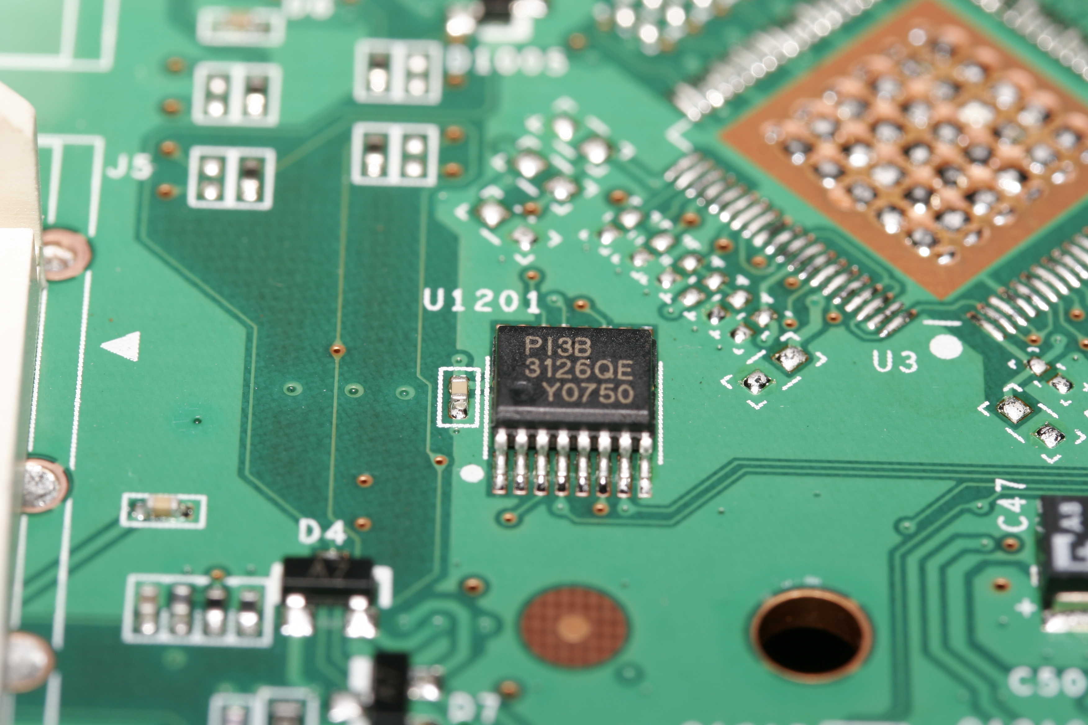

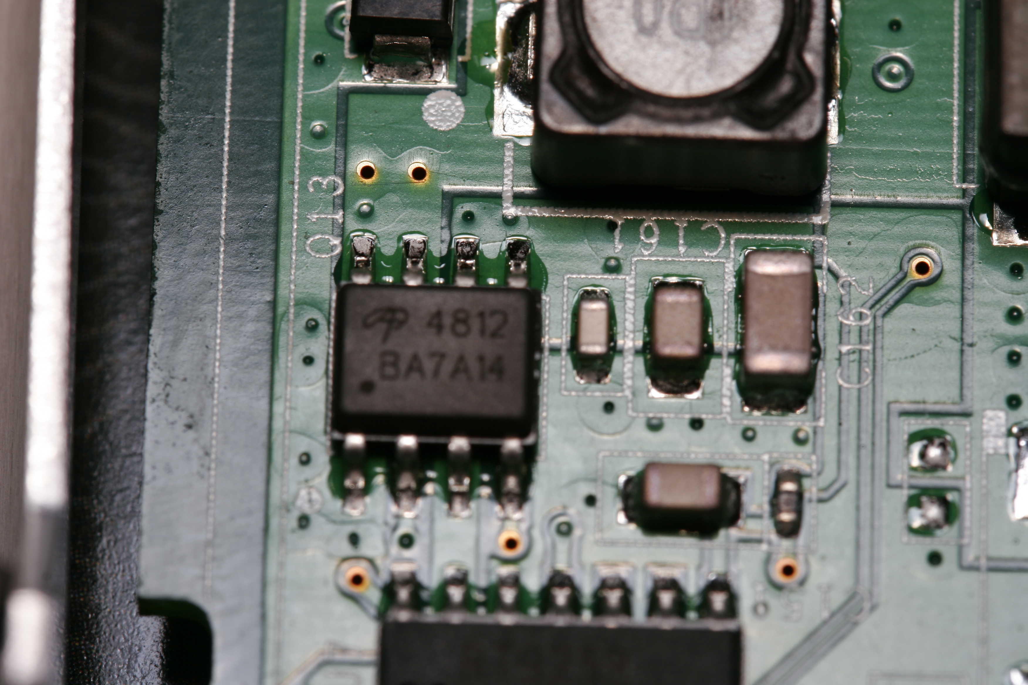

Can you confirm -- this card has a 128K flash? Would you mind checking with nvflash --check

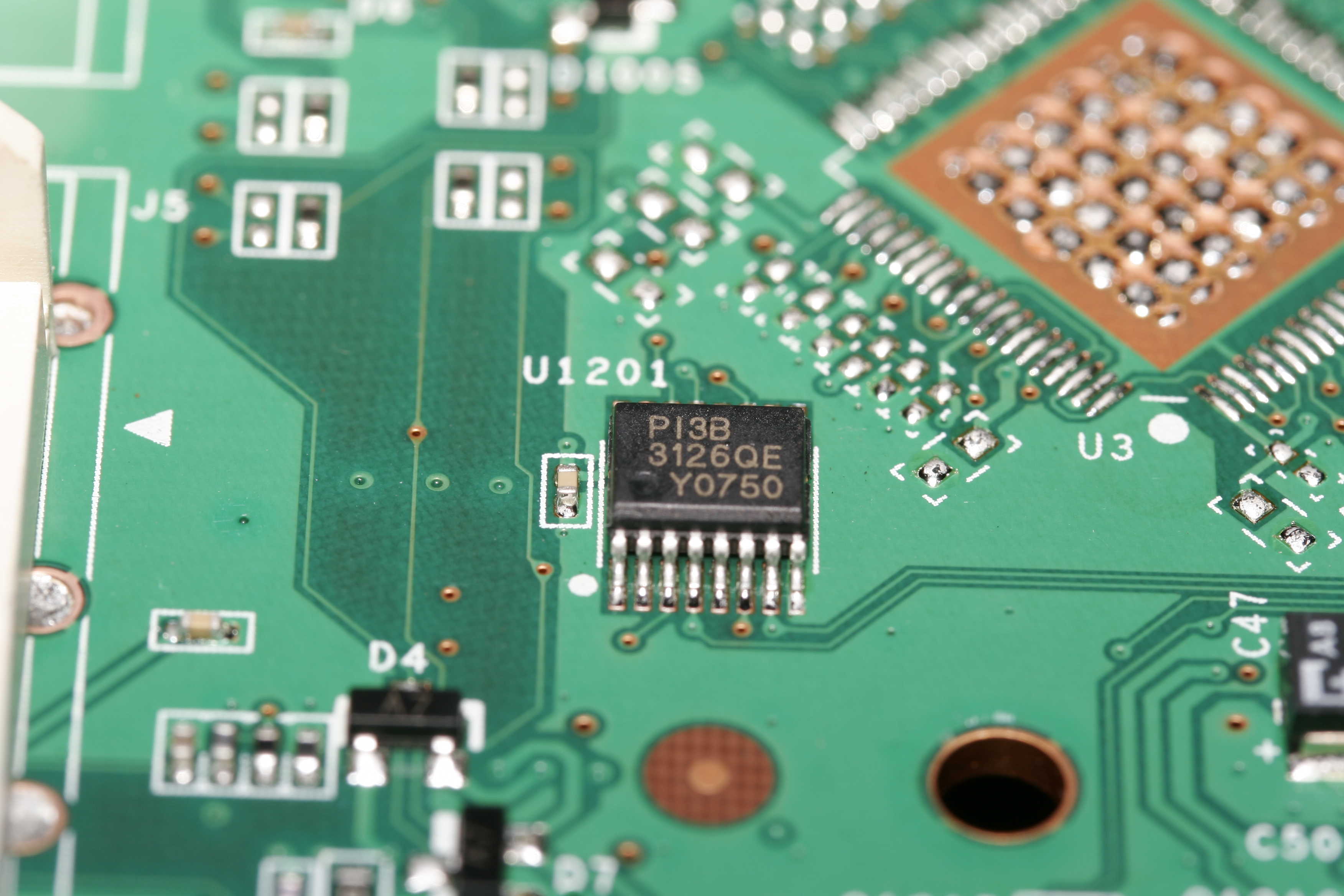

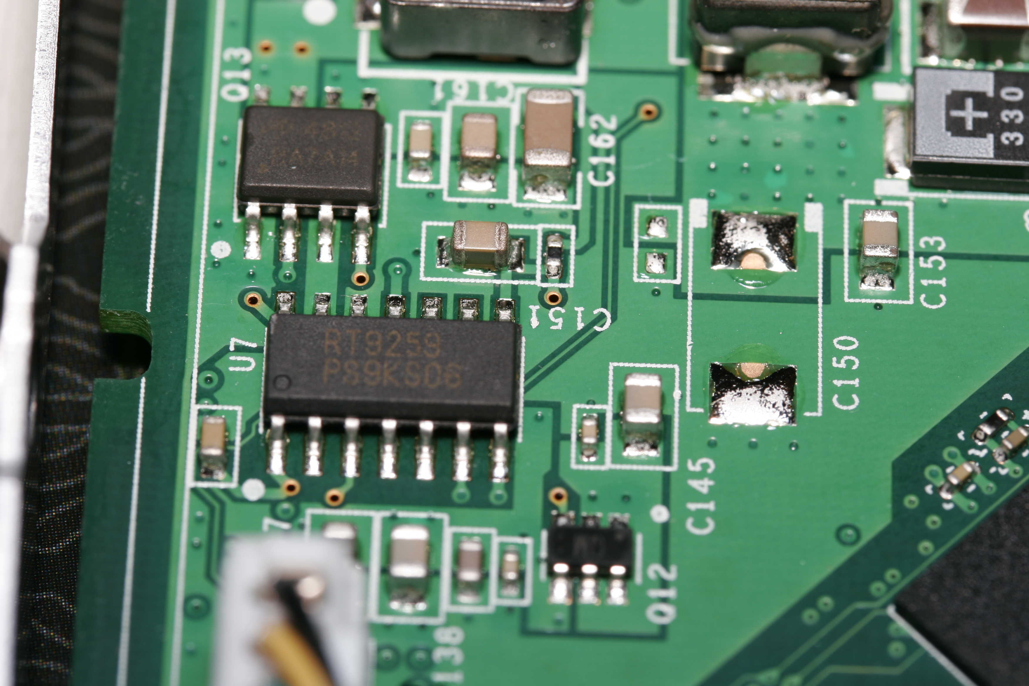

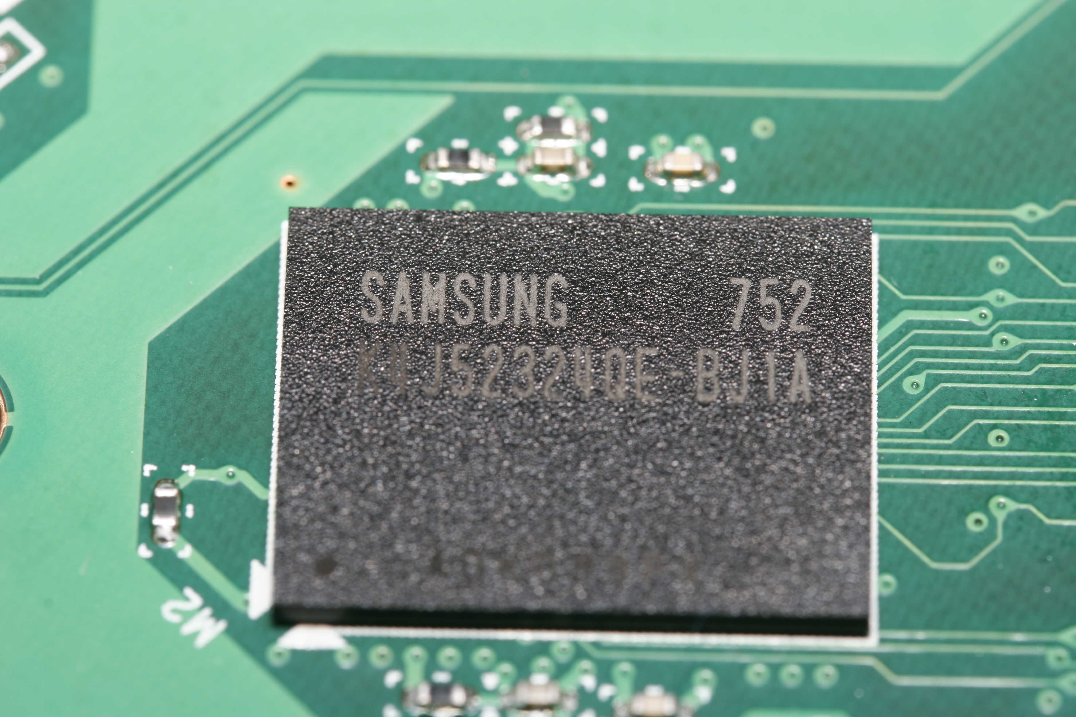

Pictures as requested, not sure what you'll tell by looking at the PCB layout, but I included closeups of each chip that might be the flash... The large Samsung chip is one of eight and comprises the main 512MB of video RAM. The thermal paste seems to have eaten away the printing on most of them, the above is the best of what's left.
Seems there's a limit of 5 jpg's per post, so remaining shots will be in a subsequent post.
