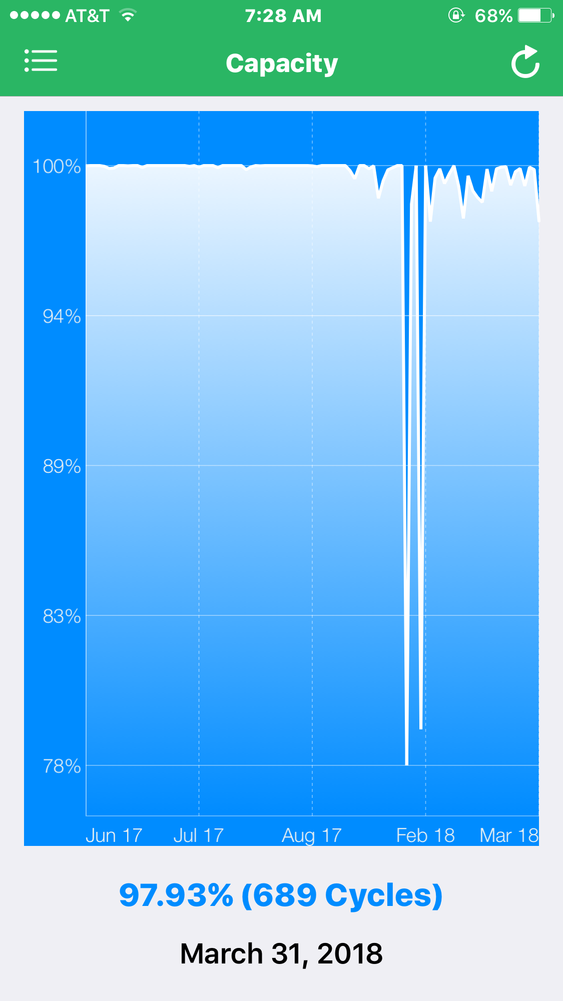

The battery capacity reading (%) will change up and down based on temperature, current charge level, the type of charger you use and because of general variability. It isn't a dead set number set in stone. I still have my iPhone on iOS 9.3.5 so i have always had battery health data available to see using coconutBattery and Battery Life app. The battery capacity has always wavered a bit and is different every day by a couple percent. One percent is nothing. Pay attention when it drops below 90%.
Here's my graph over the last few months using Battery Life app. iPhone is 2 years old with 689 cycles. You can see that it varies a bit every day. (This function doesn't work with iOS 11- Apple took it away).
You can also see that one day, the app said the battery capacity was 78% (both apps). I guess the battery was having a bad day.

What do you have to do to get cycle count ? I don’t see it on that battery app !!?? 1 month iPhone X and it’s still
Apple disabled battery data accessibility starting with iOS 10 (probably to hide the fiasco that was about to develop). Previous versions of iOS allowed apps to access this information. It's been blocked in iOS 11. Kinda a dastardly move if you ask me. The phone still records capacity & cycles but you're no longer allowed to view it. Only the Apple Store techs have access to it.
just plug in and use coconut battery on your mac, then you can see the cycles still

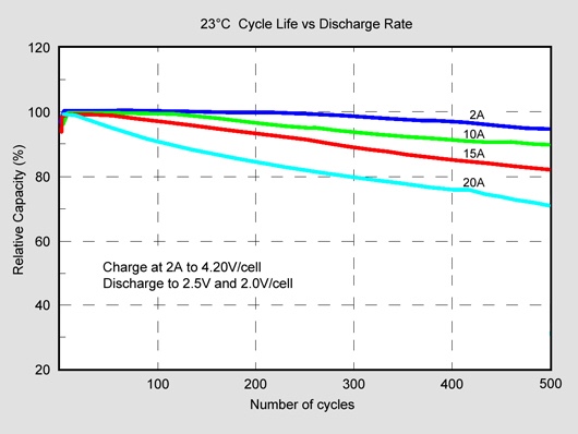

Of course you will not find a scientific paper explaining the difference in charging an iPhone 8 with a 12 watts charger after two years compare to the same iPhone 8 charged with a 5 watts charger .
But if you want to know exactly what is happening with lion battery and charger just read all the material at :
http://batteryuniversity.com/learn/article/sharing_battery_knowledge
Have a nice day
Btw , high discharge is also a problem for battery longevity
