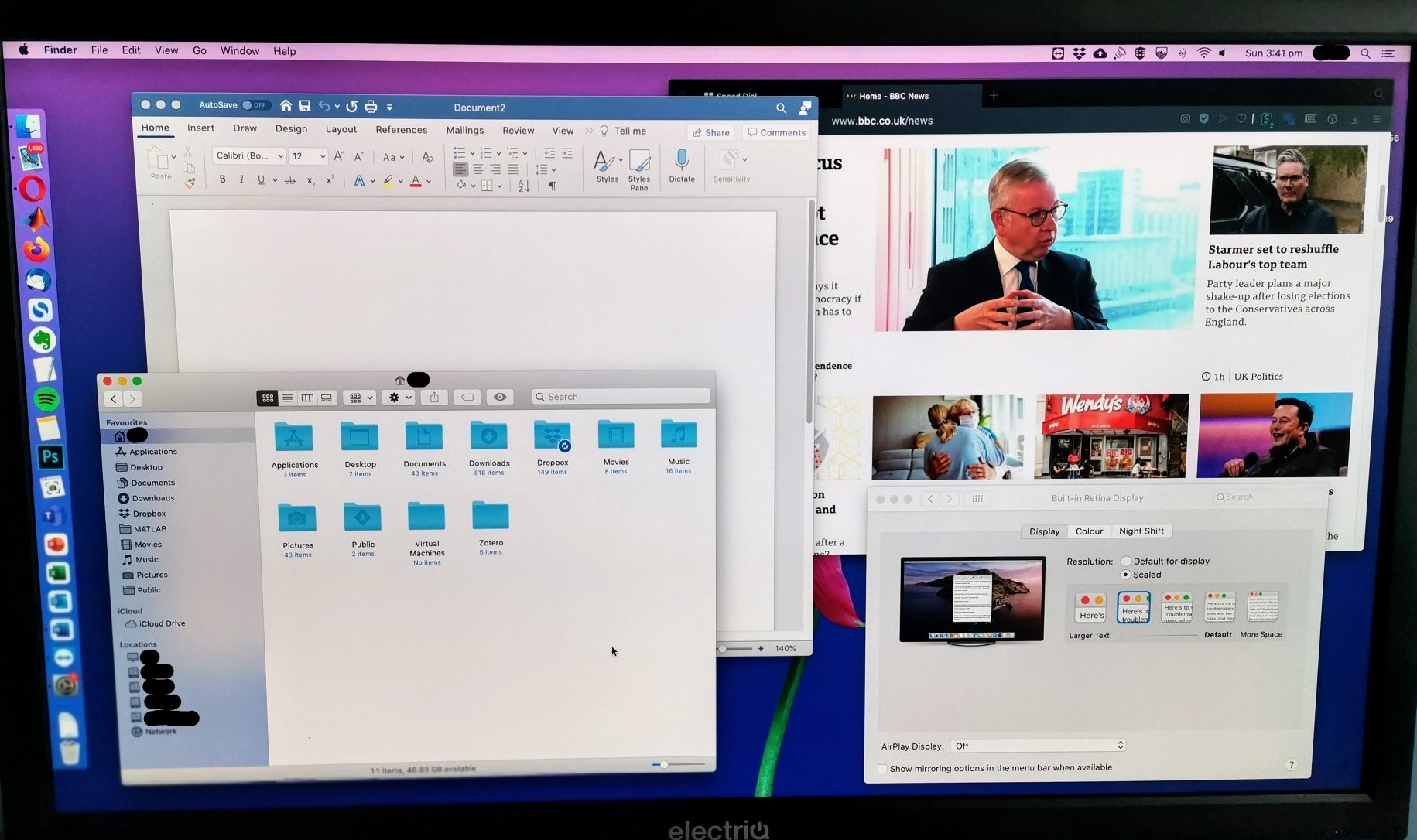

I have been on the hunt for a 4K 24 inch monitor, and finally I found one! The Electriq Eiq-244kMHDR.
It has a light matte AG coating, 10 bit IPS panel, 300 nits, and costs £140 ($190). Text looks ultra-smooth like a printed page on this screen! It works perfectly with my Mac and is detected as a Retina Display. Even though it's only 185 dpi (instead of 218 dpi), 200% scaling looks fine sitting 20" away. Calibrating with a colorimeter I get 99% sRGB, 82% DCI-P3, 285 nits brightness, contrast ratio 950:1, and deltaE 1.9. The default manual sRGB values 50,50,50 gave a color temperature of 6700K, and 48,50,48 gave 6500K - perfect for desktop usage.
The driver board is also great. HDMI 2.0 x2, Displayport 1.4 x2. I can use this with my Linux laptop too. Flawless switching between multiple sources and sleeping/waking up.

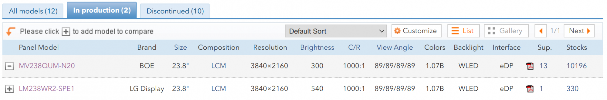

What panel is inside?
There are only two 4K 24" panels in the whole world currently being manufactured. One is the glossy LG used in the Ultrafine, so this must use the BOE MV238QUM-N20 panel. The larger version of the BOE also appears in the Asus ProArt:

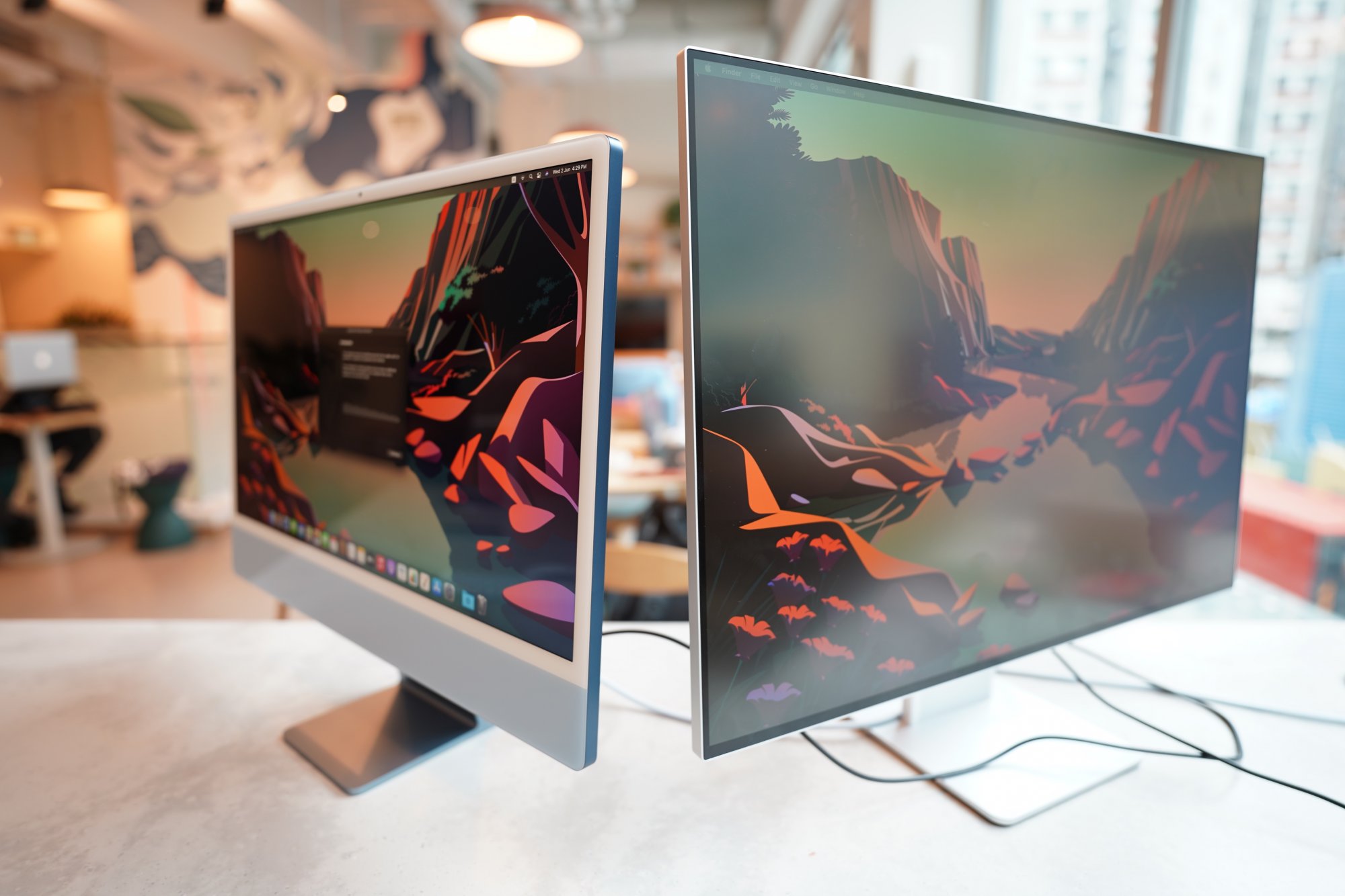

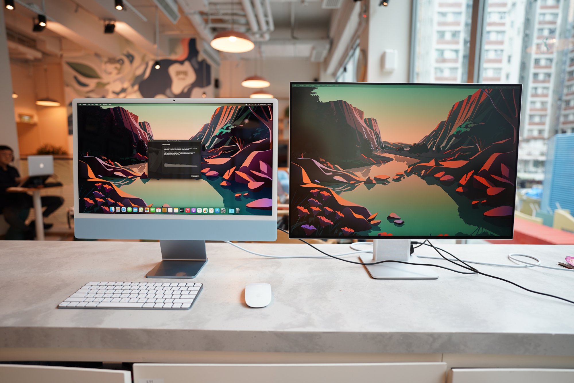

Interesting new developments! This is the Hauwei Mateview 28 inch 500 nits P3 3840 x 2520 3:2 160 dpi matte aluminium framed monitor next to the new iMac. Released in Europe now for 600 euros (Hauwei regional websites/Amazon).
Thoughts?
From my perspective the extra height is unbeatable for actually getting work done, although I do wish there was also a 24 inch sister model.
