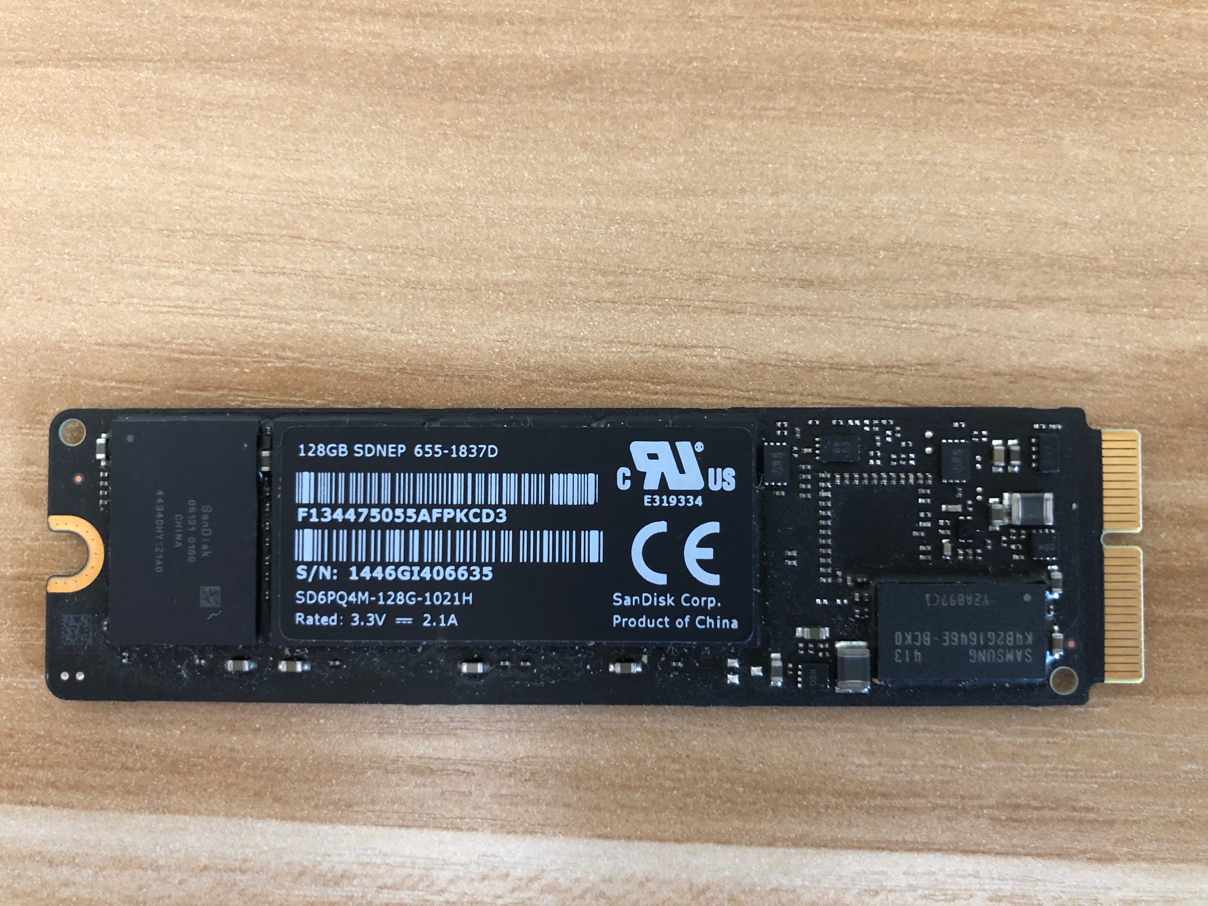

Great info here but I’ve read through the 8 pages and am unsure of something. I will be attempting to update either the Blade and/or the SATA from my yet to receive, 27” Late 2015 iMac 1TB Fusion.
I will have a couple of Apple 128GB SSD’s and wondered if either would fit right in without issue, and by this I mean no sleep/hibernate/need for adapter issues? One is from a Mid 2014 MacBook Pro, the second is from an Early 2015 MacBook Pro.
I’m tempted to go the adapter route and use a larger capacity Blade but the issues are putting me off. I plan to up the SATA to an Crucial MX500 1-2TB and leave the drives separate - really my aim is to increase the boot drive 24GB to something useful and self manage the data.
Thanks all.
If you have a SSUBX and a SSUAX, use the former. That's likely the 2015 one, and it's faster.
Magnus
See pic -
My eyes aren't great but I can't see mention of either on the Mid 2014 one... Mid 2015 is buried some place at present.
Thanks all.
