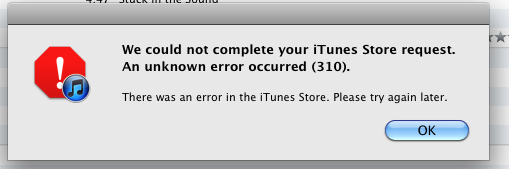

Ok, so I installed MacOS 10.6 and installed the proxy app, and my main use is music but i got this error on itunes
what can I do ?
Because I want to add my Apple account to download artwork
The proxy fixes https connection issues. So if the reason an app can't connect to the internet is because of https incompatibilities, the proxy will fix it.
If there's some other reason the app can't connect (for example if the servers for an old version of an app have been shut down), the proxy isn't going to magically fix it, I'm sorry.
I don't use iTunes but my guess is that Snow Leopard iTunes simply doesn't work anymore.

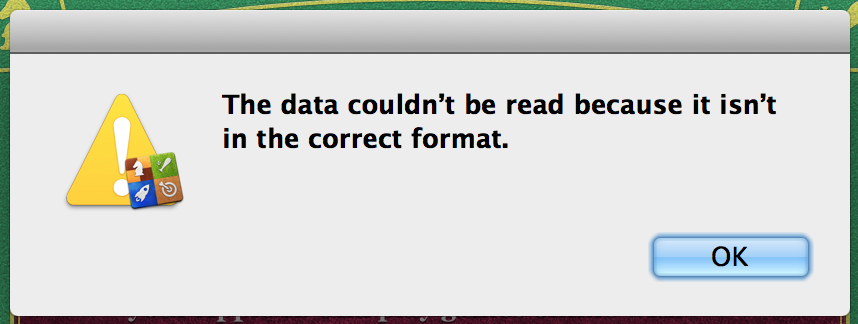

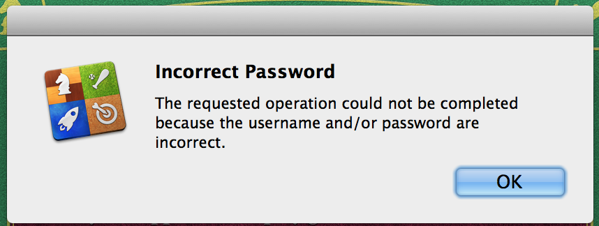

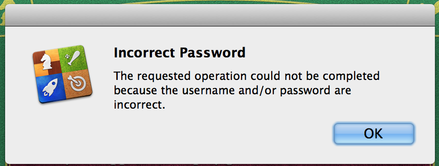

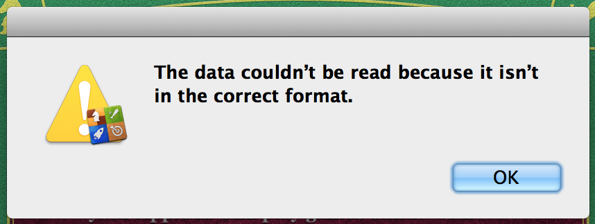

the proxy seems to be interfering with game center:
the first image is without the proxy, the second one is with the proxy
perhaps it could be configured to exclude *.gc.apple.com?
