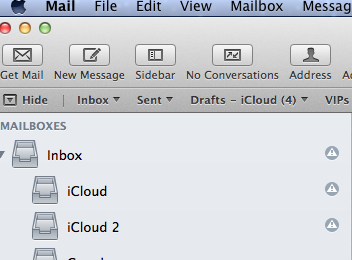

Apple Mail refuses to connect to iCloud IMAP servers. Lots of messages in the Console of the type:
Code:
Mail[172]: CFNetwork SSLHandshake failed (-9836)
I've been seeing this since yesterday. It looks like this error began to slip through Squid.
Interestingly, I received my message sent from iOS Apple Mail to one of these iCloud accounts; however, Apple's notice messages sent to the "iCloud 2" account went missing. Upon logging into the iCloud on the Web, I was greeted by the TOC acceptance prompt, which I agreed to in both iCloud accounts. This has made no difference to Apple Mail on Mavericks.
That "iCloud 2" account uses the legacy auth scheme - no 2FA or 2S. I'm puzzled as to whether this has smth to do with my not receiving that Apple notice message. Be that as it may, it shows IMAP offline for both accounts.

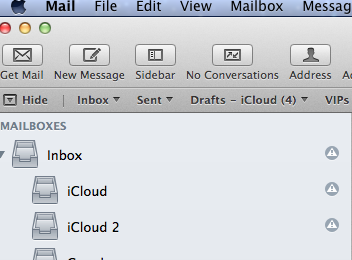

Code:
