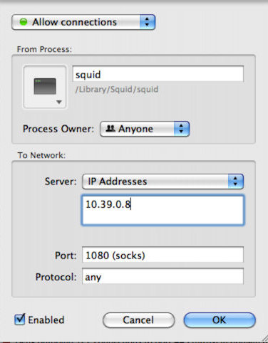

2. When I switch to an admin account in Lion, squid is running as an Active Process in Activity Monitor. But when I logout and log into a non-admin account, squid is no longer running as an active process. Very strange.
Here is some more info:
When logged into an admin account, the output of the following shows squid listening:
sudo lsof -i tcp -stcp:listen | grep squid
But the minute I log out and log into a non-admin account, squid appears to stop and disappear. When I open a Terminal and "su" into an admin account, the output of the following is nothing!
Just more confirmation that squid is not running and listening when one switches to a non-admin account in Lion.
Any ideas? Perhaps there is a problem with the ACL's in the squid config file?

No, not unless a "please bypass the proxy" feature is built into the application itself, as it is in Firefox. OS X doesn't offer a way to allow specific apps through the proxy, and Squid has no way to know which app is sending it traffic.
What OS X can do is disable the proxy for specific domains. Open System Preferences > Network > Advanced > Proxies, and look for the field at the bottom which reads "Bypass proxy settings for these Hosts & Domains". But I don't think this will work for your use case.
Edit: It really sounds like Little Snitch is the problem here. 🙁 I'm disappointed it isn't smarter.
Edit2: I'm actually a little confused as to what's going on with Little Snitch. It's been a little while since I last used it, but I thought it usually sets rules per app? Why can't you set Little Snitch to let Squid make connections to anywhere, and then set up rules for the individual apps?
Or does Little Snitch think those apps are just trying to connect to localhost (the proxy address), rather than their real destination? If so, that's dumb, because it means that Little Snitch is just plain broken with proxies—a feature built into OS X!
First of all: if Little Snitch (LS) really has any limitations, please keep in mind that the last SnL version is 3.3.4, whereas it's already at v. 3.8. something. But it's just as likely that the problems were coming from my limited understanding of how LS actually works and interacts with proxies.
Since last, I've tried lots of head-breaking combinations between LS, Squid and my VPN's proxy. After realising that — most importantly — Squid connects through Tunnelblick (OpenVPN interface) and — with the help of a browser that doesn't have its own proxy settings (Chromium) — that the resulting DNS is, correctly, that supplied by my VPN's, it took a long while before figuring out that to avoid all kinds of erratic calls in LS, I had to disable Network > SOCKS Proxy and only have Secure Web Proxy enabled. Possibly, also allowing Squid in LS to connect to the VPN's SOCKS proxy has had an effect:
I also was reminded that the reason for using SOCKS Proxy, when it had been suggested by the VPN provider, was to reduce exposure to captchas. Not something, I believe, that one has to worry about outside of browsing activity, and therefore not a problem for those applications that connect through Squid.
Maybe all of this is obvious to those in the know, but if any of it points to something I'm doing not being right in terms of security a/o privacy, or if something can be fine-tuned better, I'd appreciate hearing about it.
