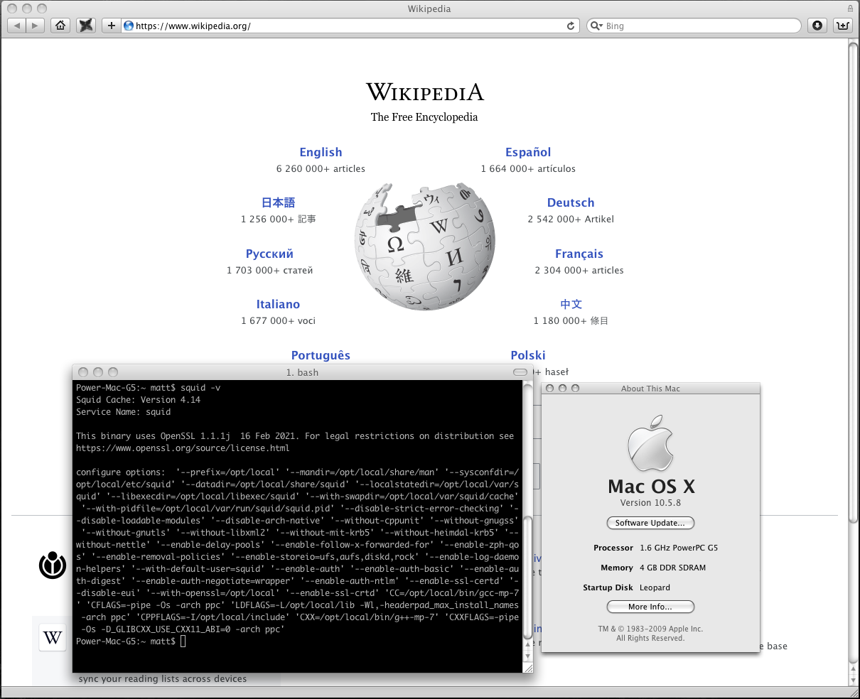

@Wowfunhappy : Well... progress with Leopard. It doesn't crash, and it does work, but i'm running in to a high cpu use issue. It's fine until i load a page or 2, then it spikes to 100% and stays there. Maybe you'll have better luck. Maybe my config is wrong. I did try on tiger as well, but as you mentioned it crashes almost instantly. So if we can get it stable on Leopard it does make leopard-webkit almost 100% usable again.
EDIT: Sweet. It was my config. I copied yours and edited it to point to /opt/local instead and it works great. Now we just need you to build it and package it with a nice installer like you did for early Intels. 🙂
Well... progress with Leopard. It doesn't crash, and it does work.
Great, glad to know it works!

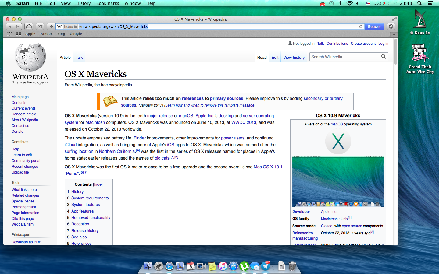

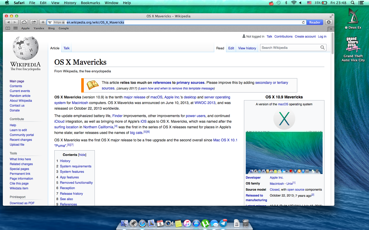

Just tested on my mbp 2006 with 10.9, and it works. Thank you!View attachment 1739408
Wonderful, glad to hear!
